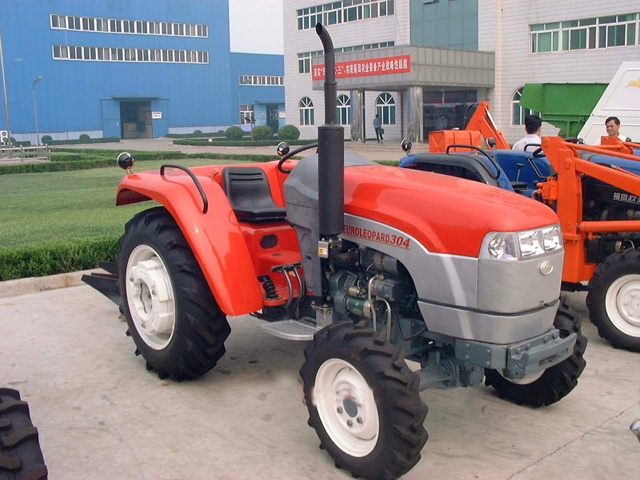

Here are the pics of the tractor in question. It looks like a Foton to me. The pic of the data plate is for the tractor, not the engine so maybe Chip or someone else can help.
Chris

/ johnson tractors #20
Here is a pic of a Foton 30 HP 4 wheel drive for comparison. The one you have seems to be the same.
It seems to be a Foton 304 which means its made by Foton and is 30HP supposedly, and is 4 wheel drive (304) It does have the ty395 engine in it like Chip said.
Here is a link to a data site for the tractor.
TractorData.com - Foton 304 tractor data
Chris
