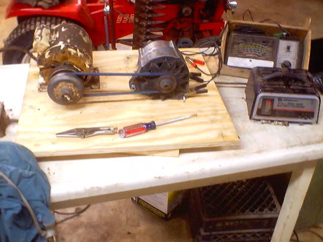

I did some research and found quite a bit of info on the web on makeing a DC stick welder out of an alternator. Theres even a fellow selling instructions on ebay.
I'm definitely going to pursue this project.
I went out today and visited a couple junk yards and I finally found an older alternator with a V belt pulley buried in a big pile of later model alt's with flat pulleys. Cost was $25.
The V-belt pulley's are getting few & far in between according to the owners, especially hd ones. Flat pulleys have been the norm since the 80's.
The alt I found was an older 110amp Bosch which should fit the bill quite well. Even though the ultimate plan is to run it off my 8hp Wheelhorse, I setup a test jig with a spare 2hp AC motor I had laying around for testing and fabrication and the alternator tested good. With no load it's putting out 13vDC.
Next step will be to disassemble, clean it up, remove the regulator and exciter diode. I may remote mount the rectifier diode assembly's but will determine that once I get into it. Since the alt is rated at 110amps, the diodes should be more than adequate in handling the welding current.
I also noticed that most folks that add 110v outlets on these setups are actually useing 110vDC which will power most AC tools that have brushes, i.e. drills, grinders etc.
I am more interested in trying to tap into the windings before the rectifiers and getting AC. But still use DC for welding. The main problem is going to be maintaining 60hz on the AC output.
If'n you get it ciphered Guidster let us know and I do the same. This is an outstanding idea.
Volfandt

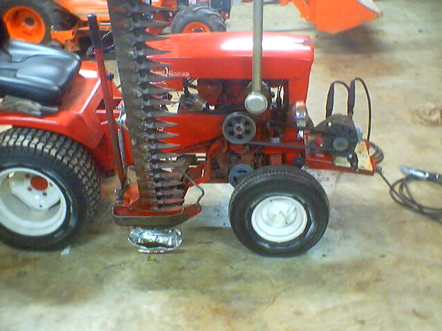

Along the same lines as you and after seeing your project, I also wanted to power an alternator/welder off of a tractor too. In my case, I wanted to get some more work out of my 40 yr old 856 Wheelhorse. I "resurrected" it last yr after letting it sit and waste away for 4 or 5 yrs and it's been earning it's keep in the 22 hrs since.
After many trials & errors with that Bosch alt I decided to visit the junk yard again and this time I left w/a $20 75amp Delco Remy. Ends up that weak Bosch alt, probably the diodes breaking down once they got hot, was my main problem in getting the alt/welder to work. It never got over 80vDC and hardly generated enough amperage to run a bead.
My Wheelhorse has an additional engine pulley but since it is basically the same diameter as the alt pulley, I wasn't getting enough RPM. I was only able to get around 55vDC out of both alt's at full throttle. So I went out found a 6" pulley and there was just enough engine shaft left to slide it on. With the 6" pulley I can get over 140vDC out of the Delco alt at full throttle! I haven't the means to measure that much current but based on the arcing I'd say I'm getting close to it's rated 75 amps!
Sorry to say that my welding leaves alot to be desired so I ain't post'n no pic of my sorry beads, but the good thing is that I can practice now /forums/images/graemlins/grin.gif
This is a right side shot of my setup. The 6" engine pulley, 47" drive belt and my "quick-attach" alt/welder rig can be seen.
