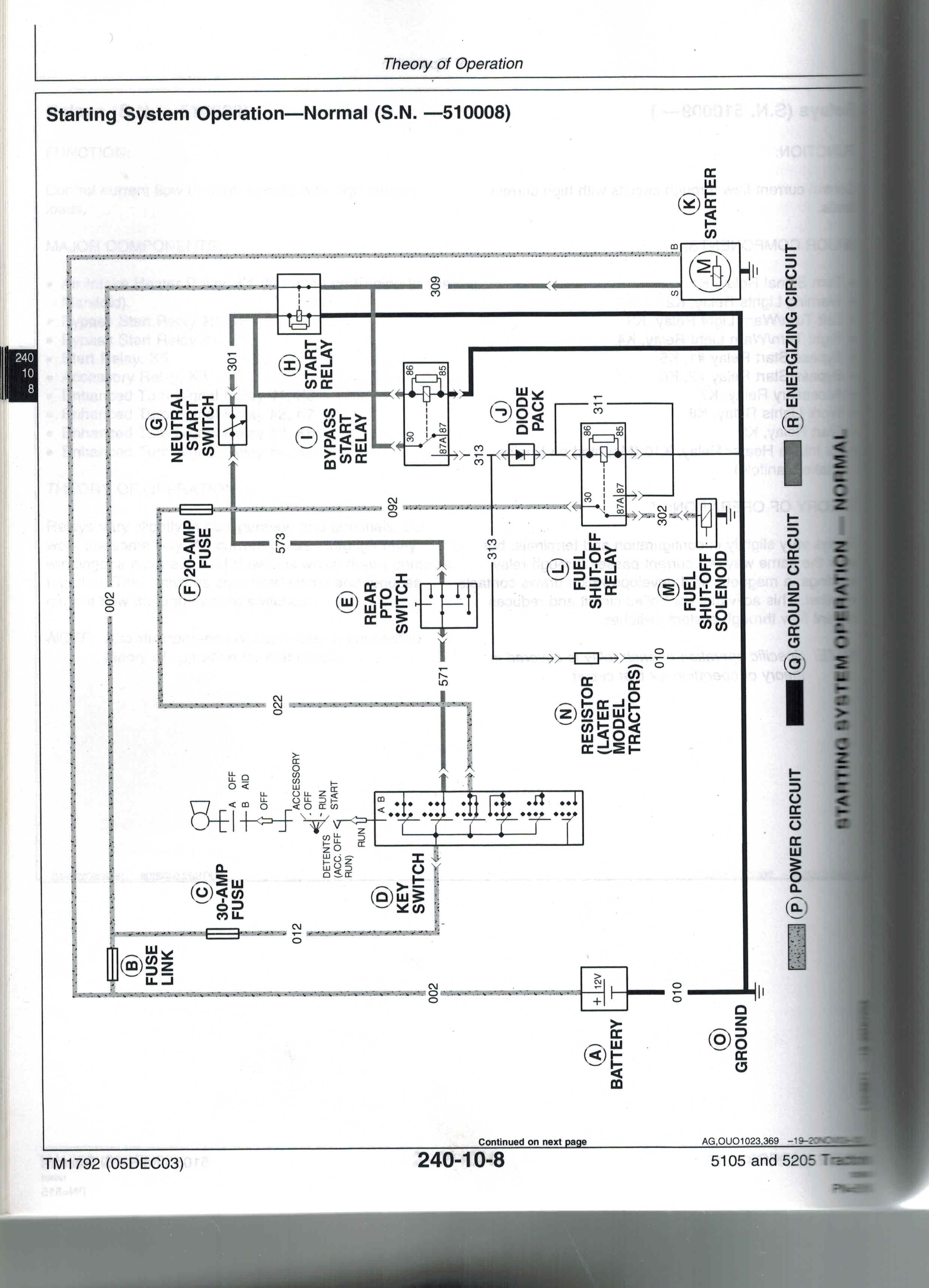

I have owned my John Deere 5105 for years and now am having a starting problem. Thanks to this forum and some other sources I have put together some information to help me diagnose the problem. I was looking for a schematic diagram of the starting system and learned that it is only available from John Deere as a technical publication for $410!:eek: That is more than the price of a service call from my dealer plus some. Evidently John Deere intends to operate their publications department as a profit center not as a service to their customers. I don't appreciate being treated like this by the company I spent well over $22K buying this unit new from a dealer. I suspect that others have the same complaint on their John Deere tractor publications too. However, I do not expect John Deere to change their policy on this matter. This is a poor way to treat customers.
/ John Deere Technical Manual Issue #2
Is this what you need? What is the serial number of your tractor?

Yes indeed that is what I was looking for. I wound up listening for the injector solenoid click when the key is turned on and hear it consistently. I took the cowl assembly apart far enough to see the key switch and the turn signal switch. I removed the turn signal knob and light switch knob and then took them loose from the cowl panel. There was a large mouse nest on top of the bracket the steering column is fastened to. I cleaned all of that out and repaired some wires (unused ones) that went to a pigtail connector set branch. I found no other wires damaged by the mice. I went through the fuel bleed procedure and finally managed to get the tractor to start. It seems labored and when I tried to use it with the mowing attachment it could not handle the load and began to struggle even keeping a decent RPM with the throttle all the way to the floor. I turned off the mower and PTO and limped back to the barn and left it outside in case I need to work on it again. It is close enough to the barn that I can run my compressor air hose to it or an electric extension cord.

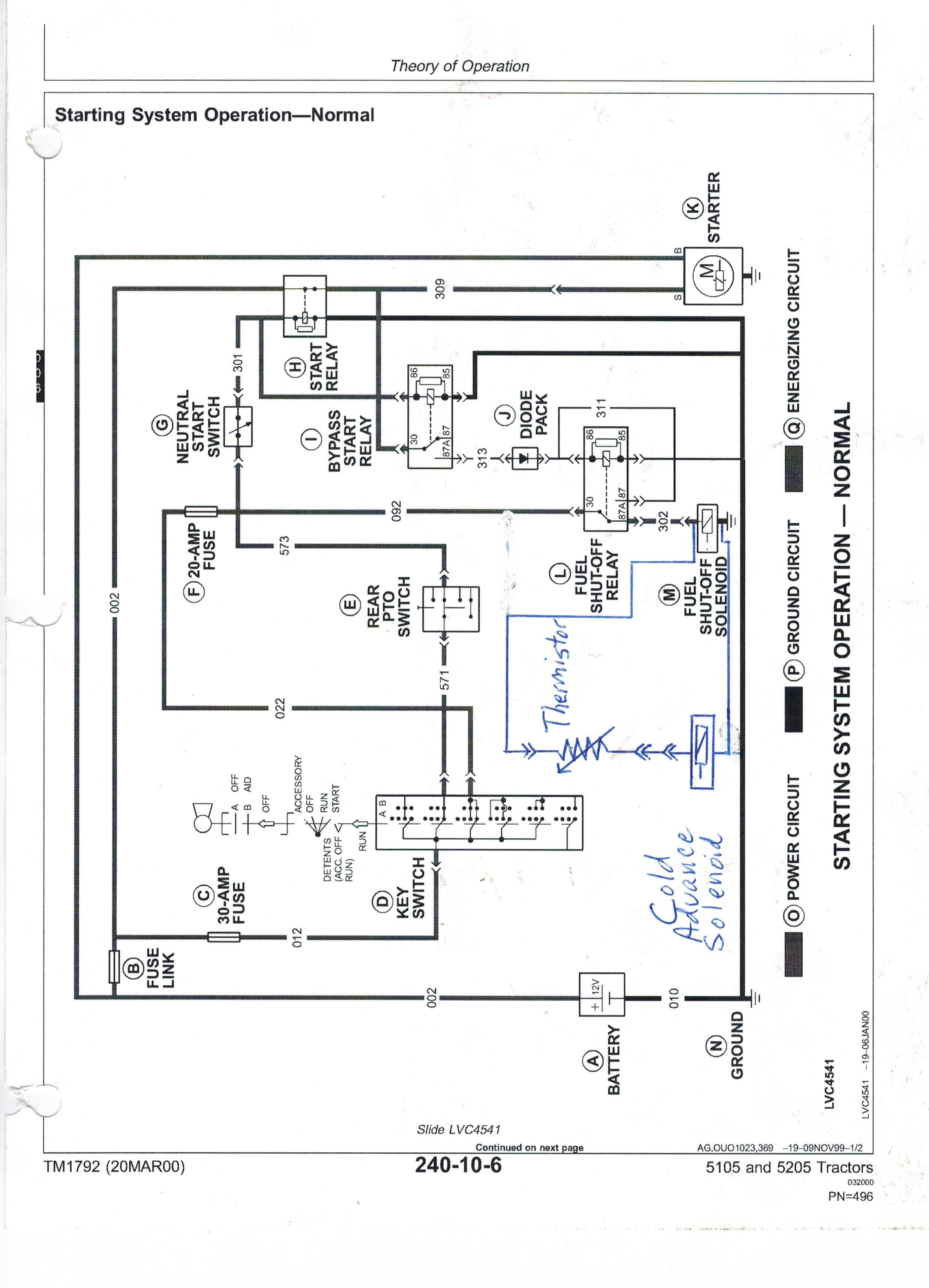

Sorry, if your tractor is like mine that first diagram is incomplete. I've attached a second one showing the Cold Advance Solenoid circuit. That has nothing to do with your current problem though. Did you change the other fuel filter? Part Number RE220719 is located between the tank and the RE60021 filter. On my tractor it is found near the rear of the valve cover.

Thanks for that extra information. I will have to drive into town to get the part, RE220719, but it is certainly worth a try. I did notice that the RE60021 filter is listed as "final fuel filter". There may be another filter in the fuel tank too. I need to check.
