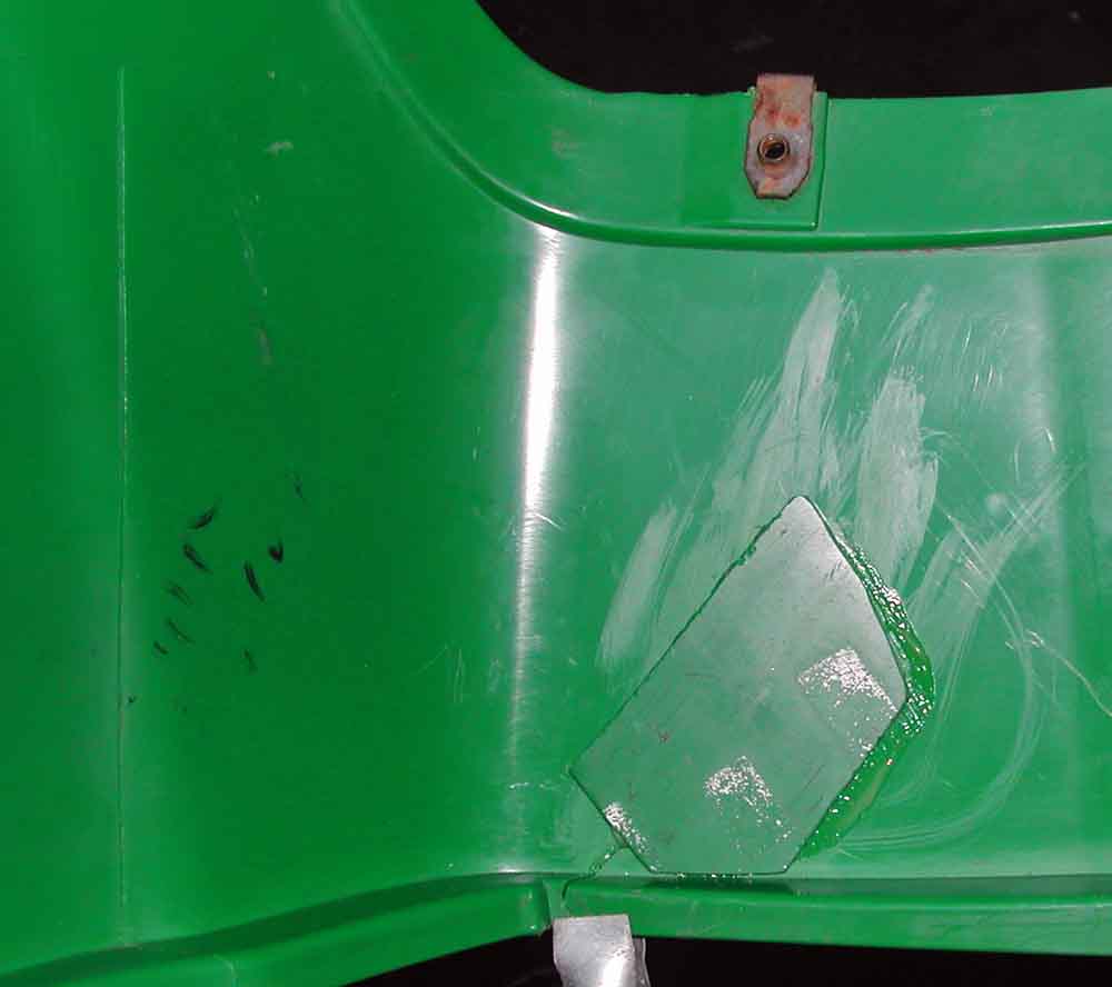

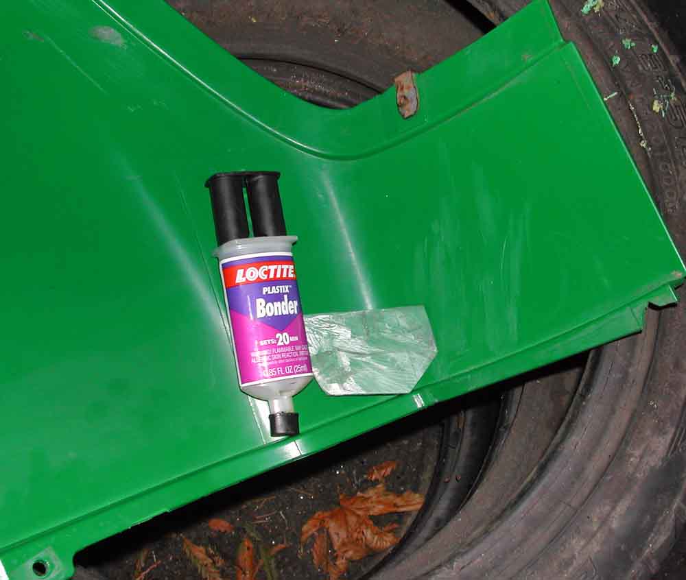

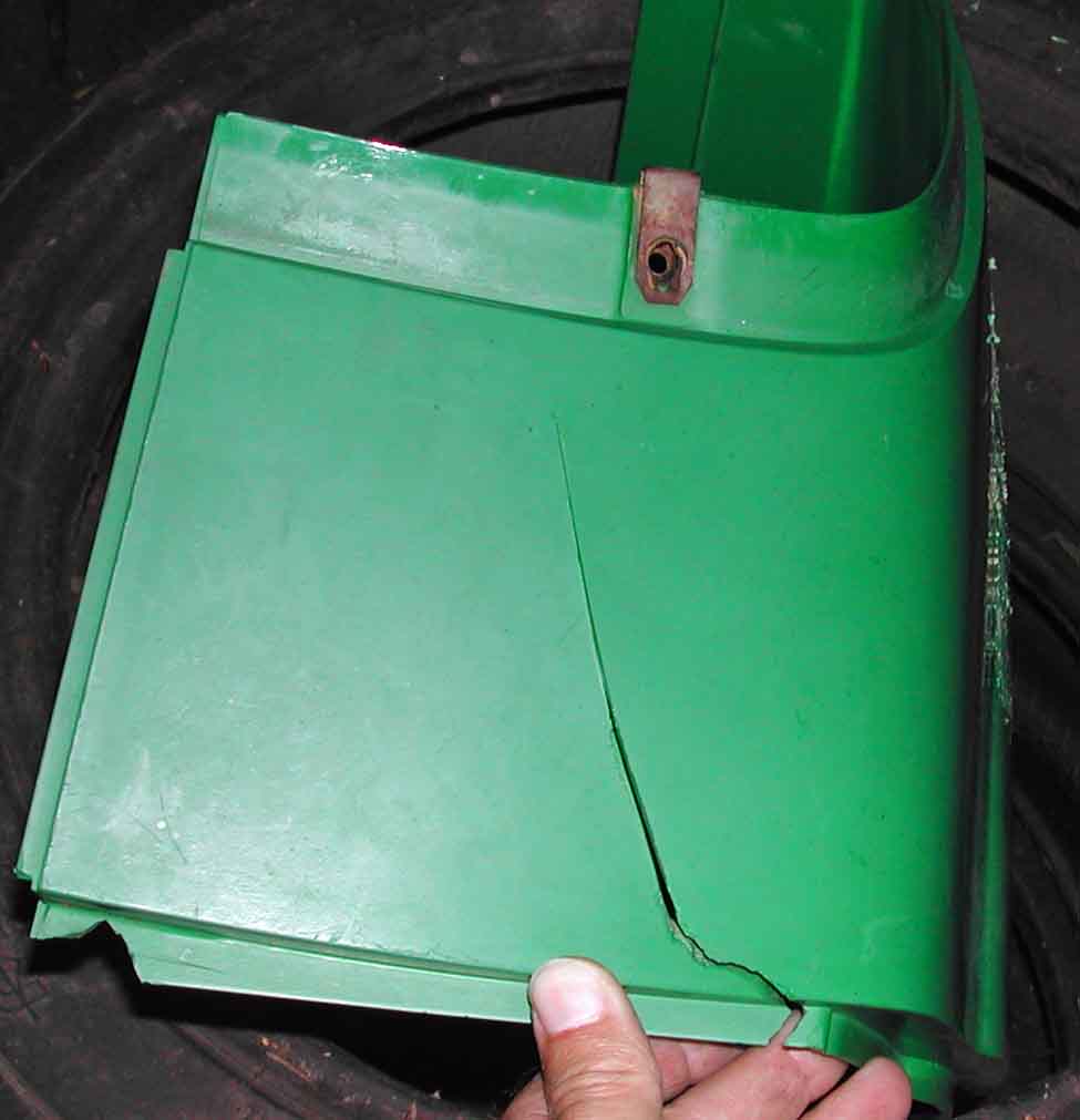

> then came the 1/8th inch thick green proprietary resin plastic on the 42/43/4400 tractors.
It was used on the hood, cowl, and side panels. I repaired several cracks using the
Locktite 2-part plastic cement commonly sold, and a backup piece of the same kind of
plastic. Worked well. If you polish this plastic, don't get it hot.
