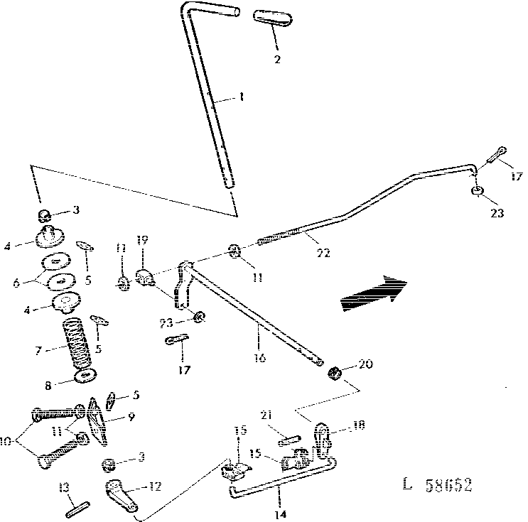

I took off the side cover to get to the spring to tighten the nut, however, there is no nut to tighten, just a spring. The assembly is different than the one you have
posted. I recently bought this tractor to restore it is a 2240 model, would you have an idea on how to fix this ?
Thank you,
Duke
You'll either have to replace friction washers or some how shim up the spring for more tension.
R105814 Washer - WASHER, FRICTION ADD 2.61 USD
Thank's Jim I'll give it try.
