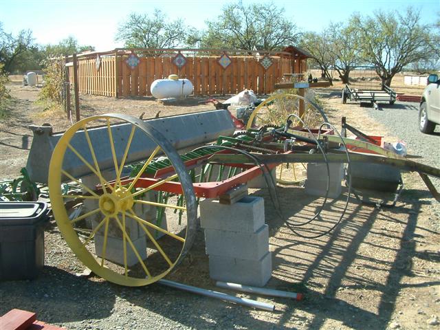

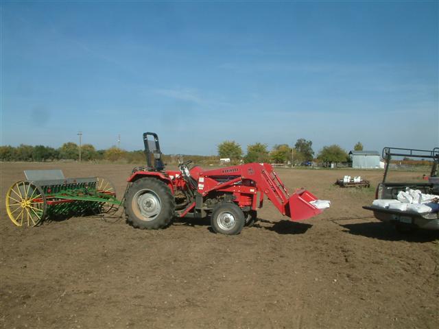

I rebuilt two Minneapolis Moline P3-6 drills a few years ago (10 ft wide, 20 drops, 6" row spacing, steel wheels). I modified the one I use for planting my 6 acre hayfield by adding a hydraulic cylinder to raise and lower the openers.
Good luck
