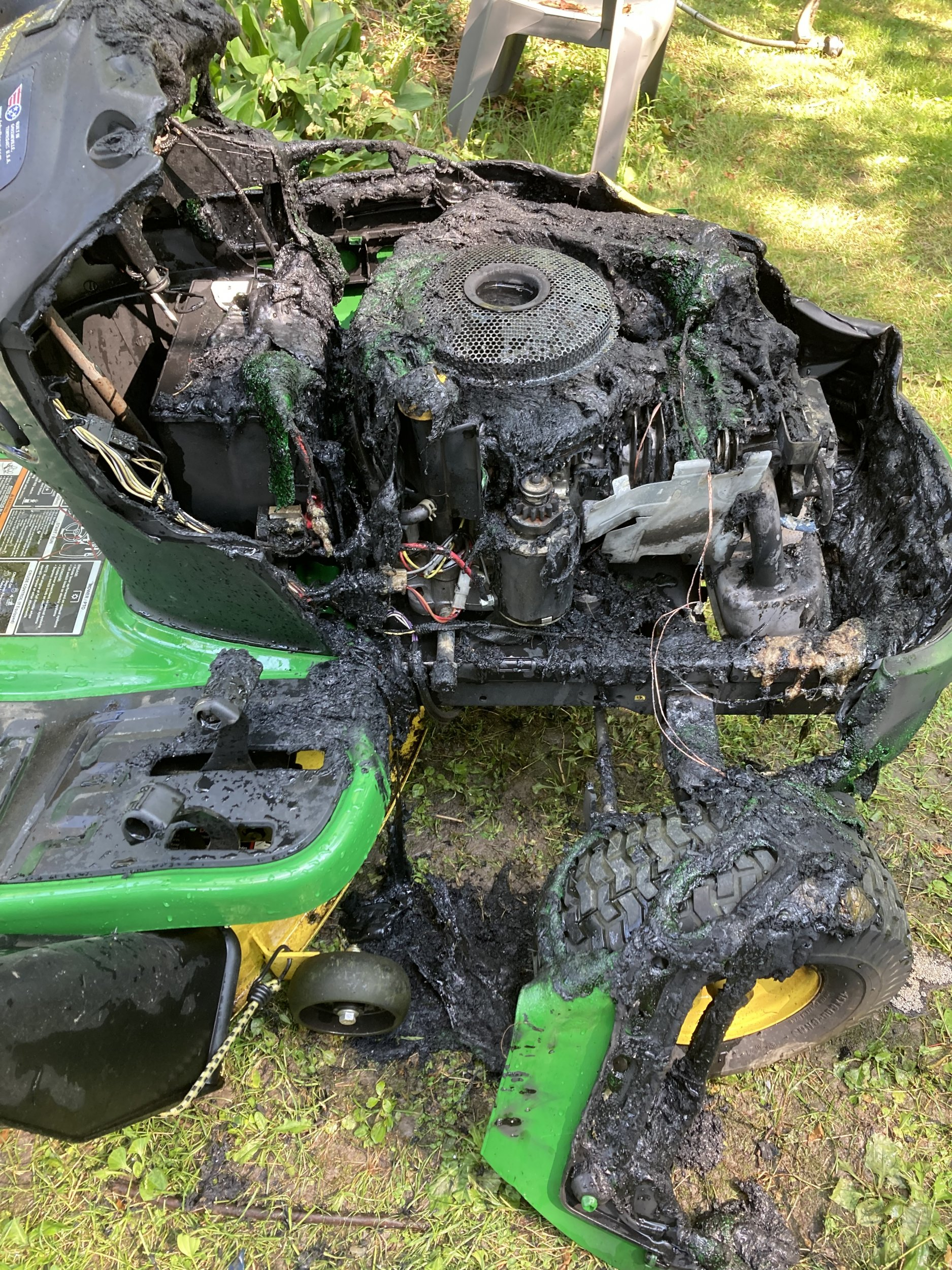

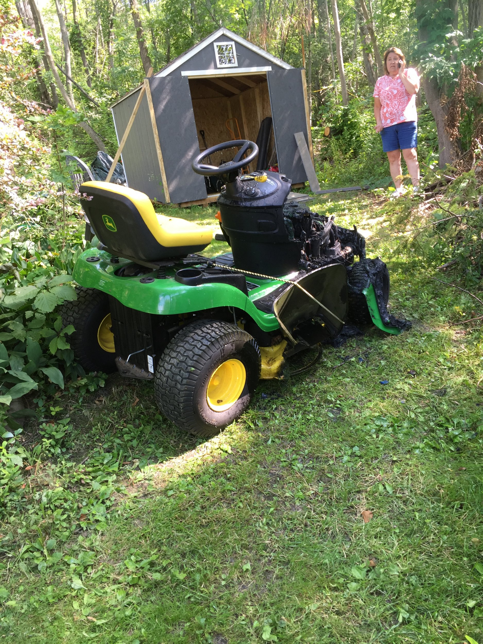

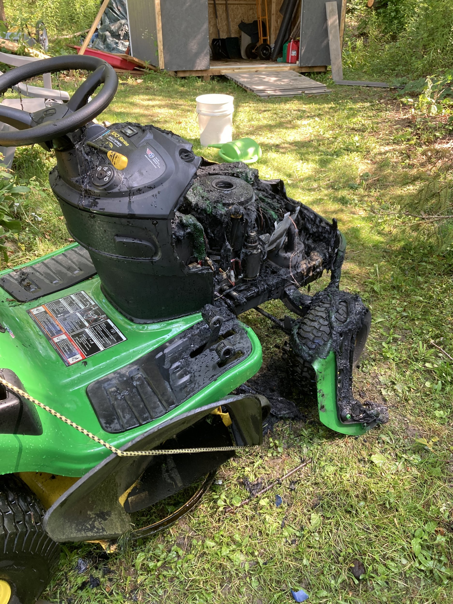

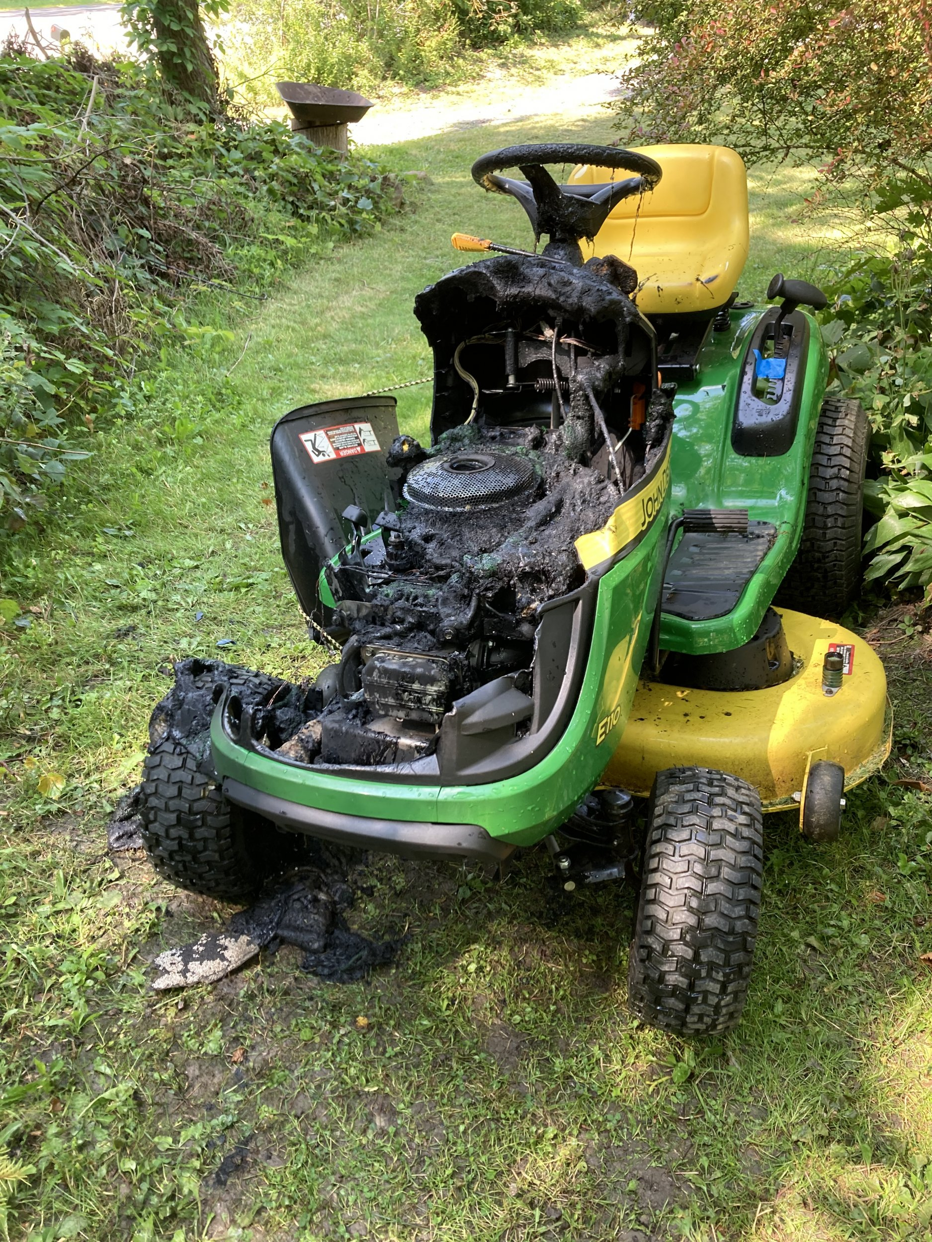

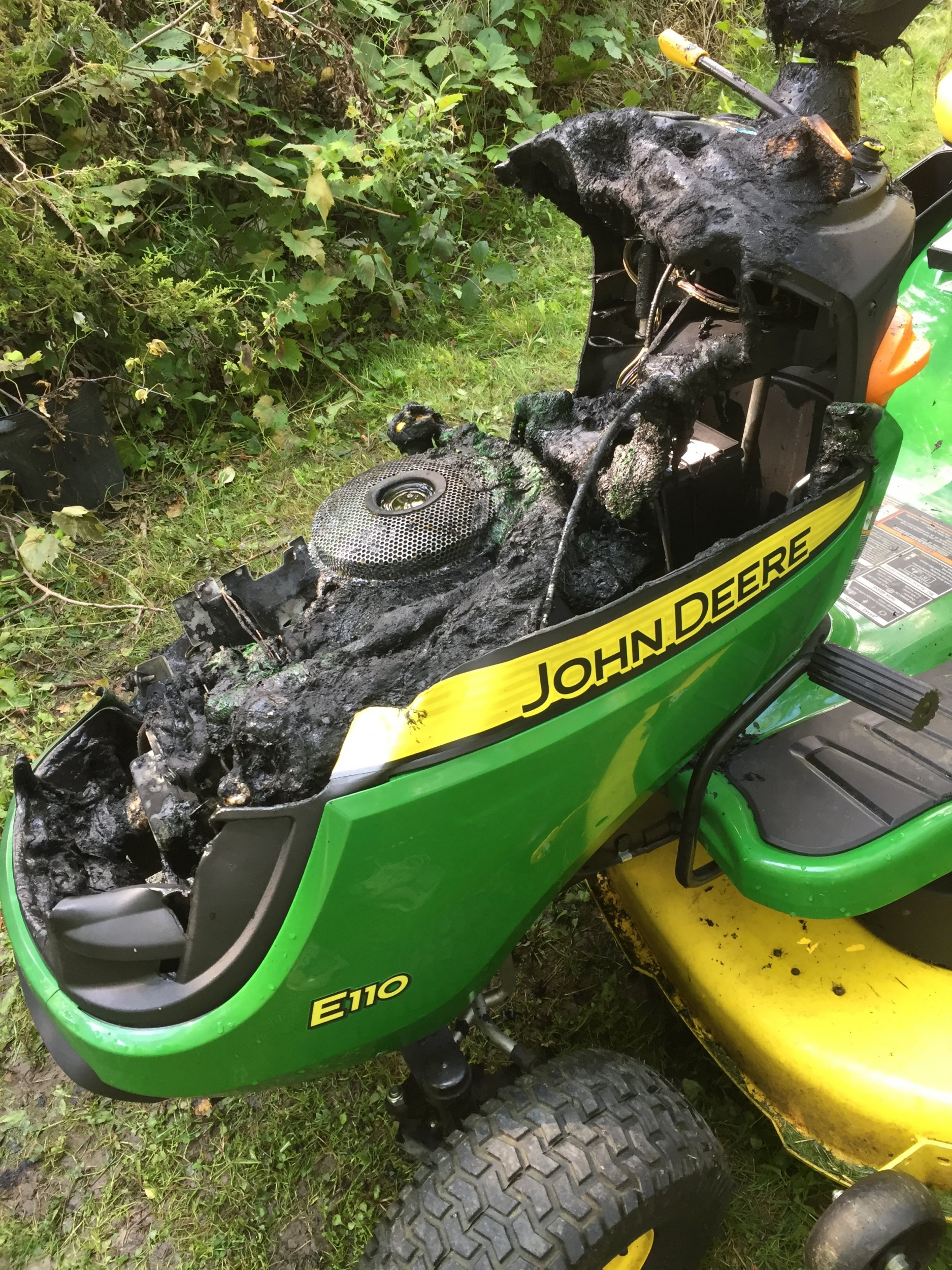

Our John Deere E110 mower caught fire last Saturday. Still don’t know the reason why. It started in the front near the exhaust. But it didn’t have any electrical issues or gas leaks. It was the first time we mowed my daughters backyard. It wasn’t that big a yard 60x45 feet. The grass wasn’t that long. It only took about 1/2 hour to complete the lawn. Put the mower in the shed, shed doors open to let it cool off. Then 10 minutes later smoke coming out of the shed. I ran to find 7 inches of flame coming out of both sides of the front hood. I pulled it out of the shed. Was too far from the water hose. Couldn’t find the fire extinguisher. So buckets of water finally put it out.
/ John Deere E110 on Fire #2
That's unfortunate. Any idea what caused it?
No definitive cause.
  1. Gas? My neighbor said it had to have been a gas leak for it to go up that quickly. But we didn't have any previous leaks, and the left side (as you are sitting on it) has the carburetor and that side didn't burn as much as the right side.
  2. Electrical? Very unlikely since the flames started at the front of the mower, and we didn't have any previous problems, and it's just two years old.
  3. Grass? Maybe. I didn't look under the hood this time. But the last time there was no dead grass under the hood when I checked the oil and oil level was good.
  4. Design flaw? Maybe. The front of the tractor is plastic with the cover hinge is close to the muffler. The plastic does gets warm when running.
We moved the front yard then let the tractor sit for about 1/2 hour before mowing the back yard.
This may have been related if all the front plastic got hot from sitting from the first use. Then the backyard is on a grade so it had to work extra hard to up and down the slope.
Could the plastic have ignited with a little grass?
The plastic sure burnt awfully fast once there were flames at the front.

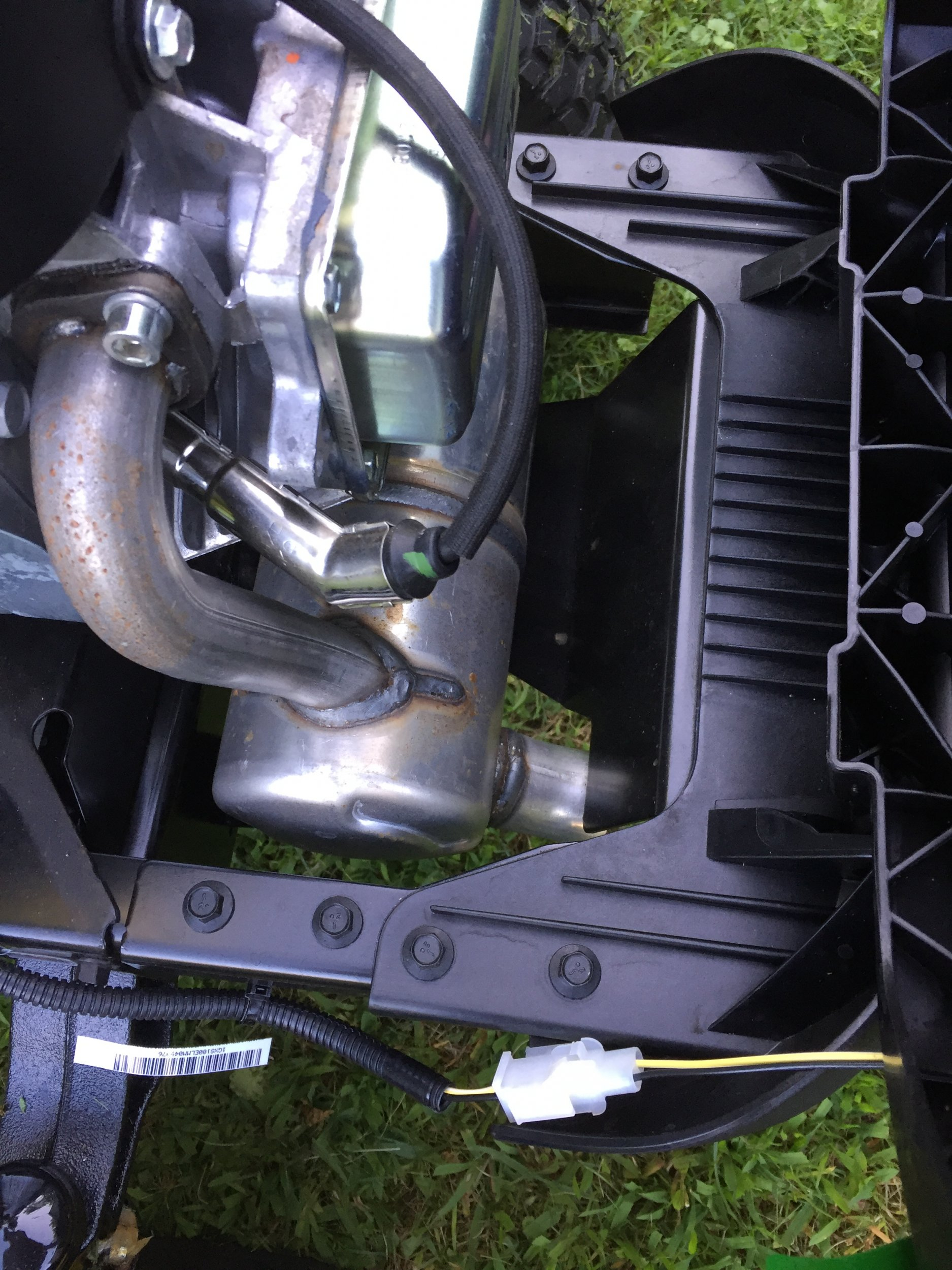

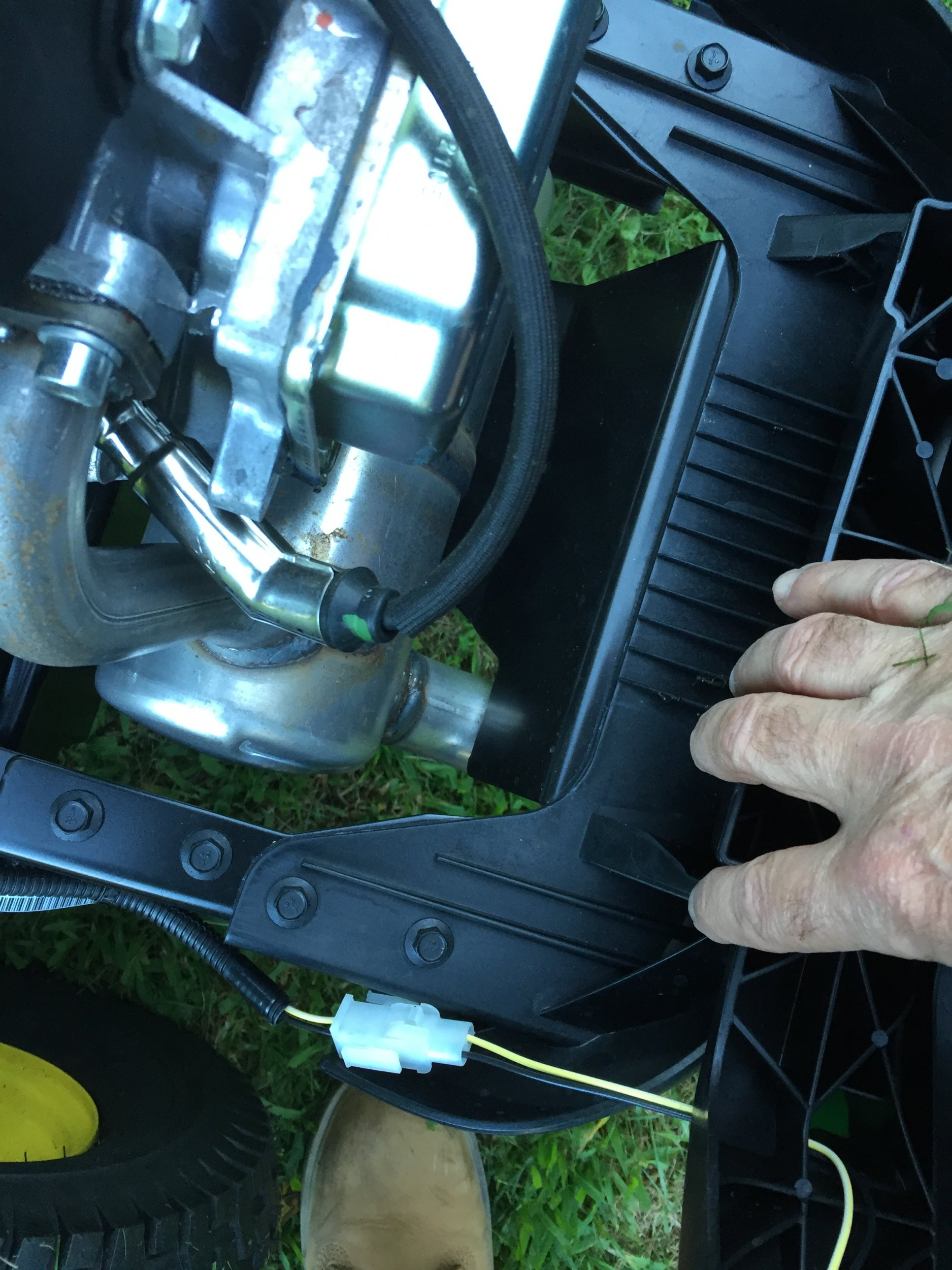

For comparison I also have a John Deere S100 that is similar in design but newer.
This was after mowing my yard. I wanted to check to see if any grass would be collecting near the exhaust. Looks pretty clean. I did notice the plastic hinge gets warm.

The fuel line comes in the left (drivers) side right? And the muffler exits out the other side. Must have been from material near or laying/touching the muffler, is my guess. Mouse nest? They can jam a whole crap load of flammable material into an engine bay in a single night of nest building.
View attachment 708423View attachment 708424View attachment 708425View attachment 708426View attachment 708427

I bought 4 fire extinguishers and mounted them at every shed in the family after our fire incident.

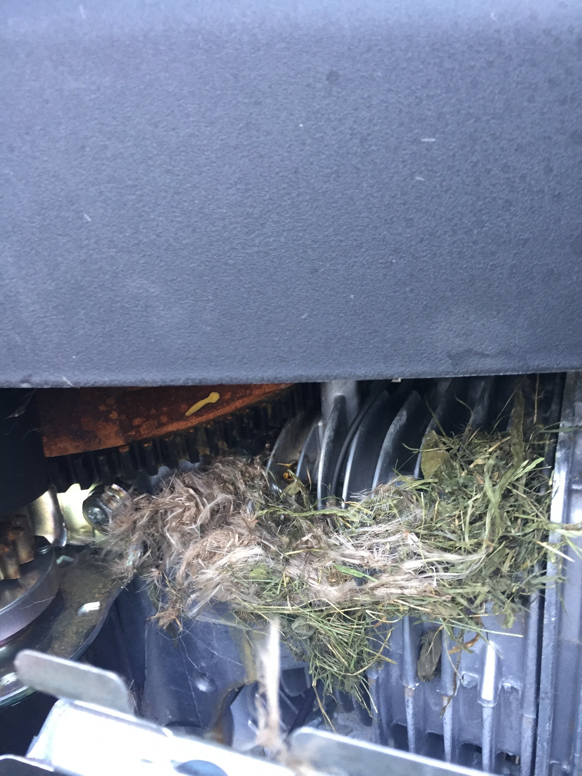

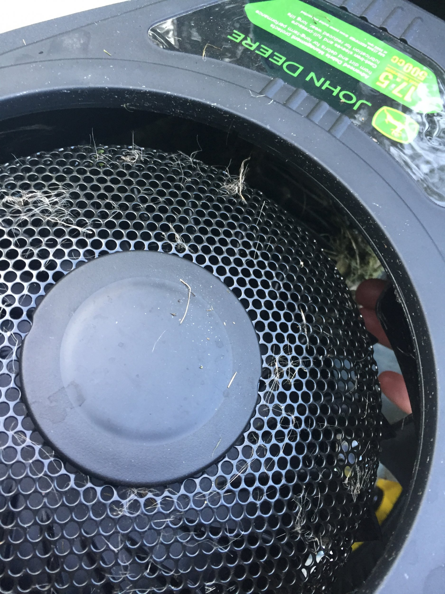

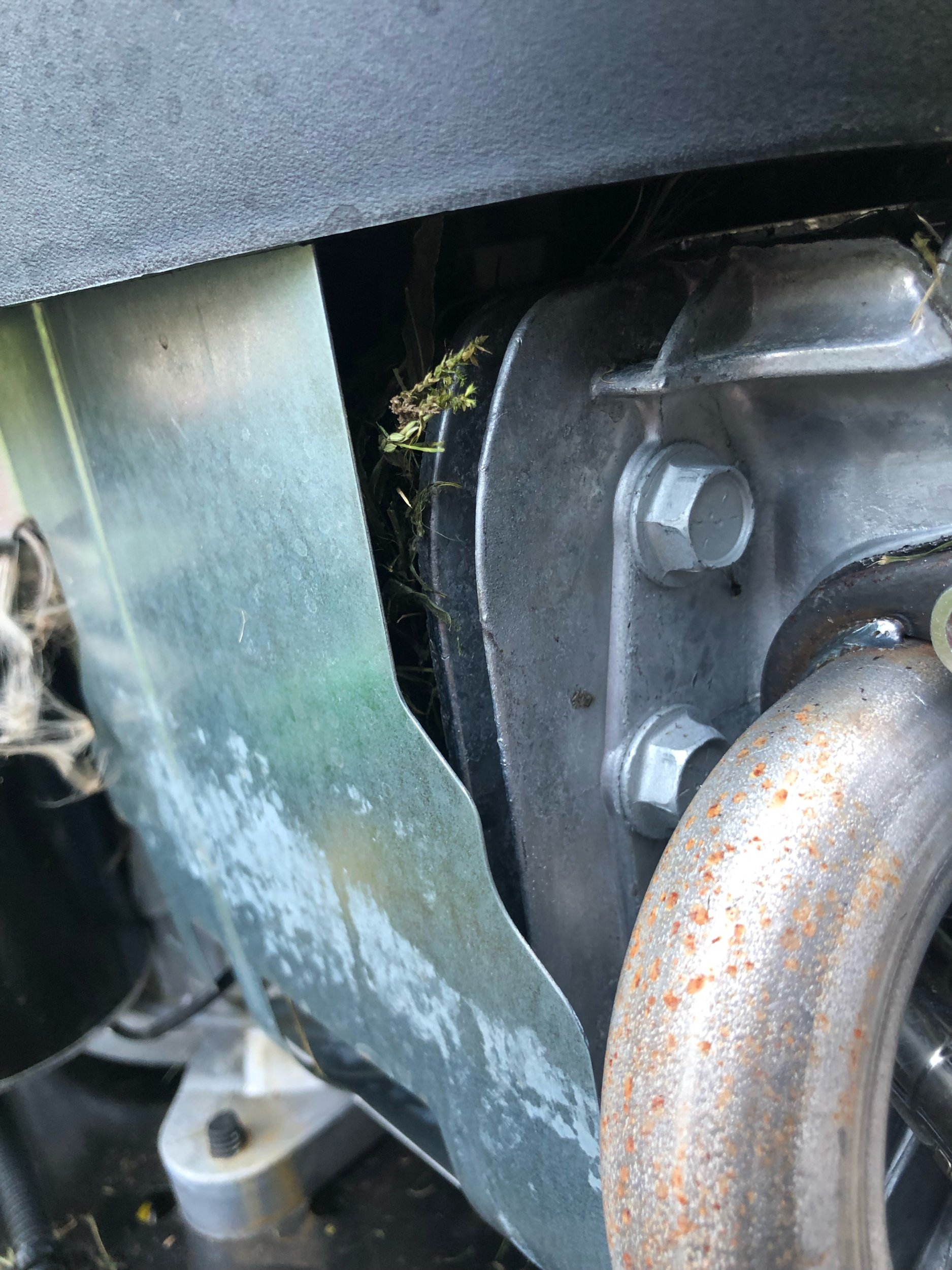

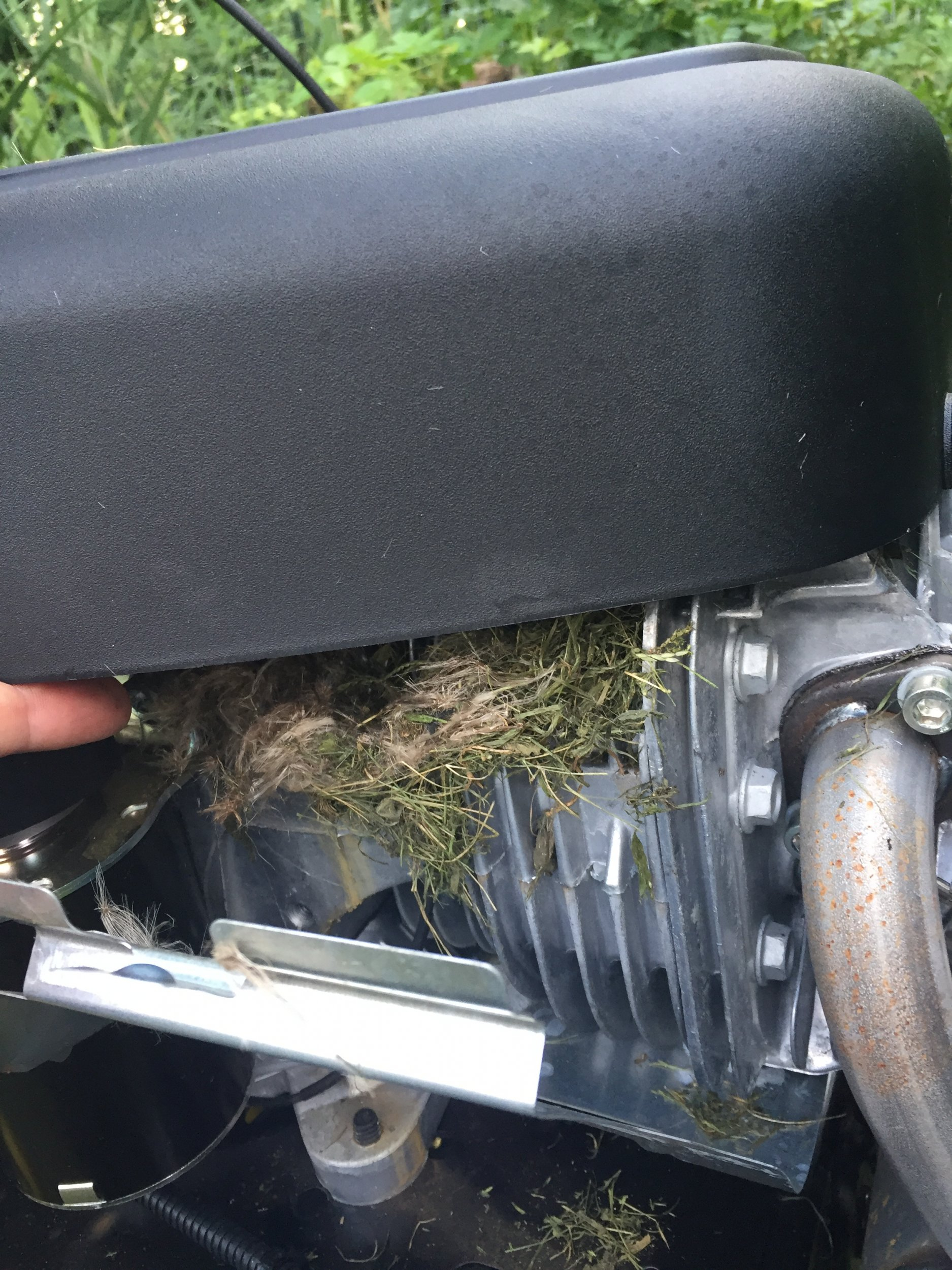

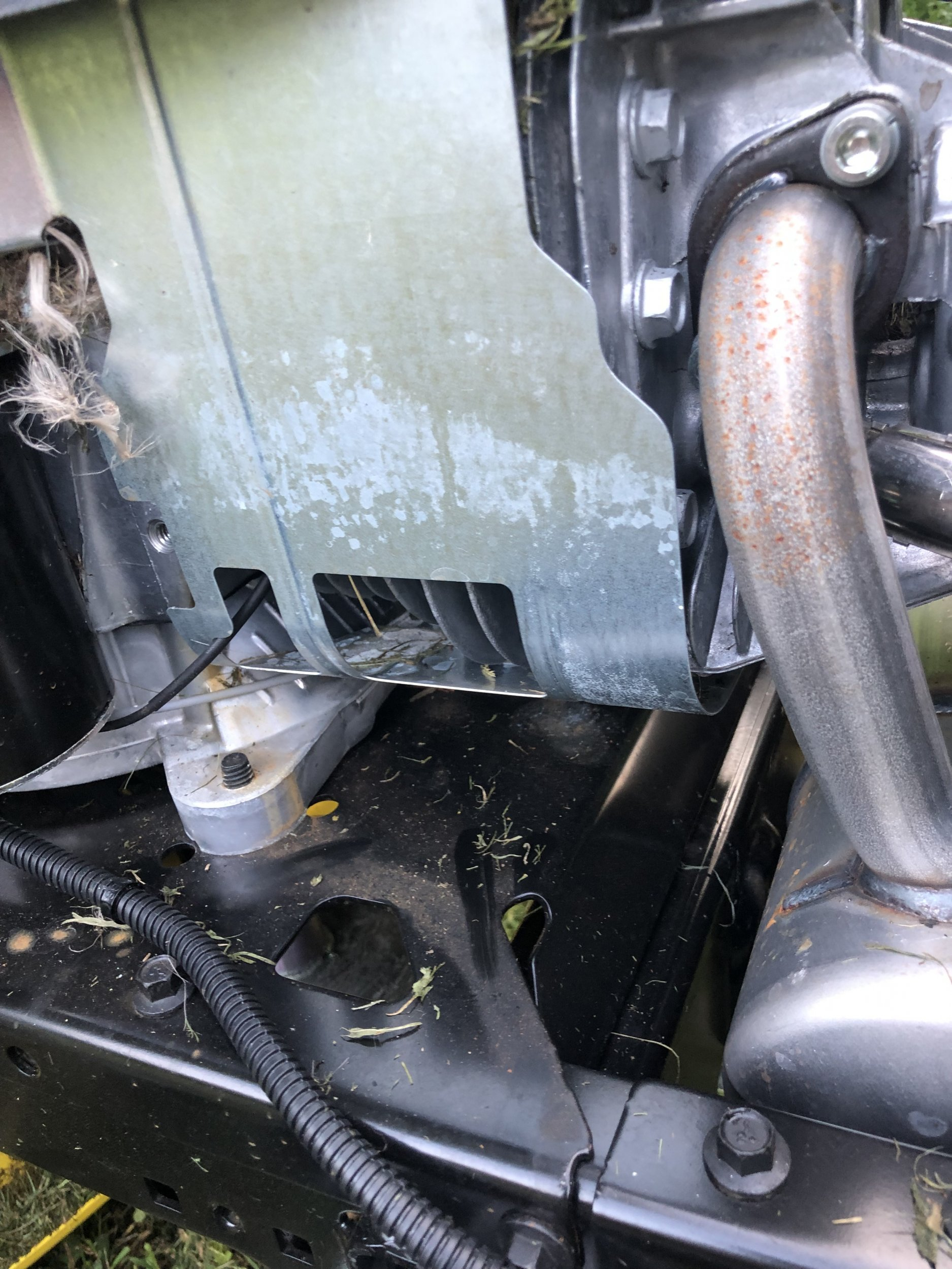

Just a couple days ago I saw “stuff” in the new mower.

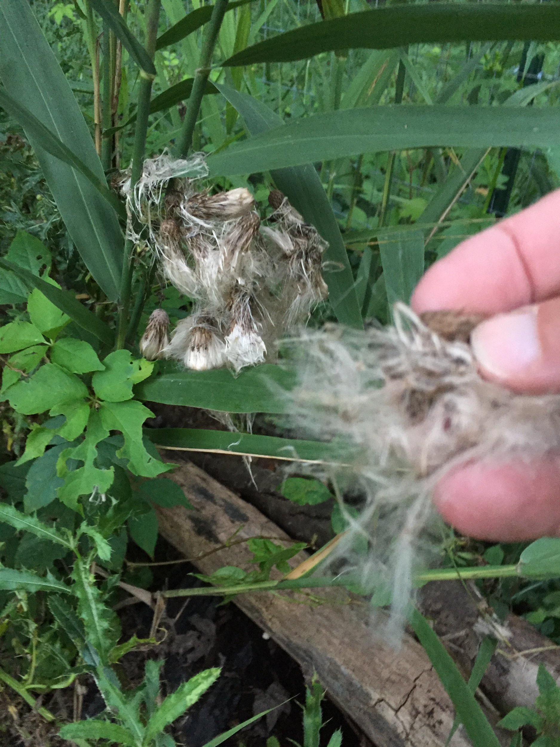

It’s now mid august here and we saw some gray thistle seed and grass stuck in the new S100 JD mower.

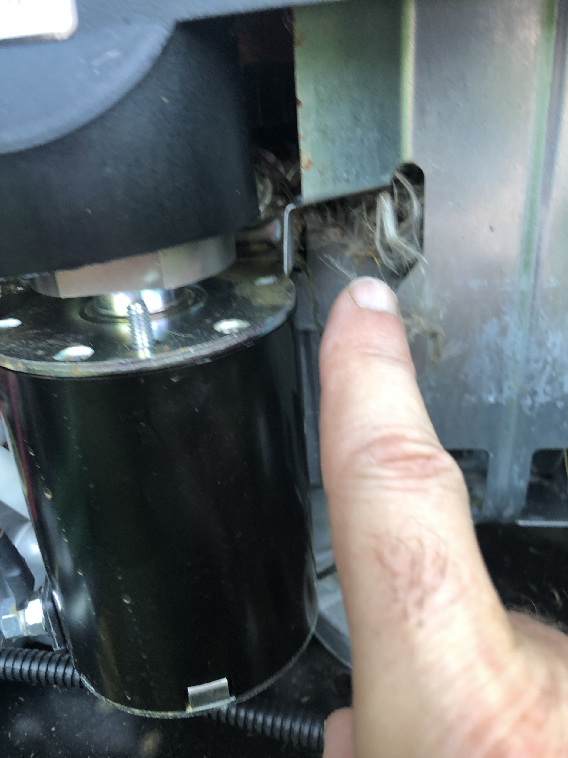

It was hard to see how much was stuck in by the motor fins, because there is a thin silver metal plate that directs air over the fins.
So I took off the four bolts and lifted the black plastic engine cover up. This let’s you tip the thin silver metal plate back to see the motor fins.
My brother in law saw the pictures and said it was definitely a nest. But I’m not sure if the motor blower is sucking in grass and thistle seed and sending it to the motor fins and it gets stuck there.
My new mowing process:
1. Moth balls to store on the mower when it’s in the shed.
2. After mowing take the motor cover up and tip the silver plate back and using a compressor to blow out the grass, seeds, and nests.
Seems like a lot of work to mow but we definitely don’t want another fire

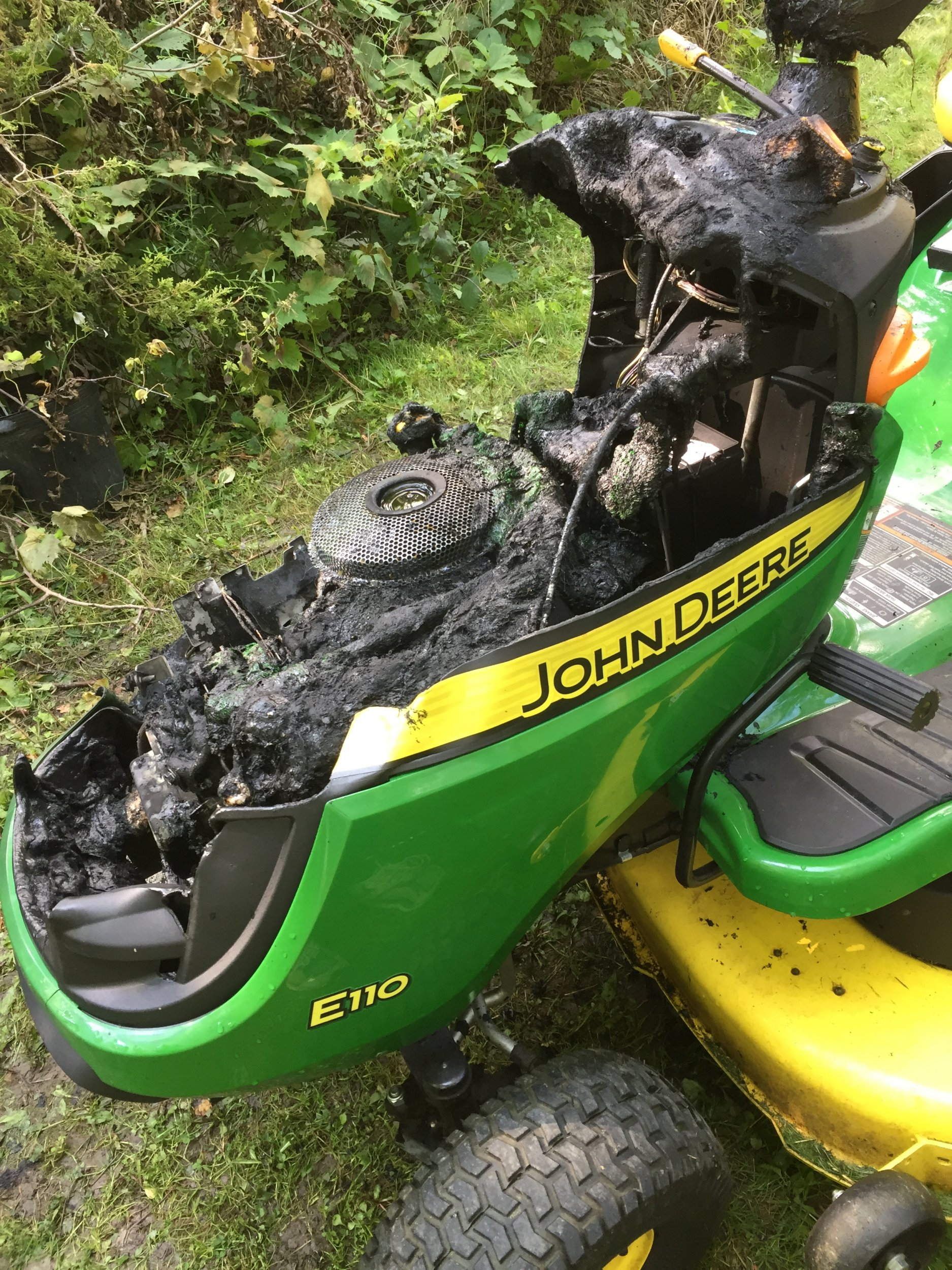

Before mowing again with the new S100 JD mower I cleaned up all the grass and seeds I could find.
I also found the shredded and dried uo remains of Mr Mouse. So I now think the new mower had a mouse nest and probably the older E110 also had a nest which caused the fire.
#19
The old burnt E110 is mowing again.
About $400 in parts gets me a mostly new riding mower.
Most of the time was spent digging out charred melted plastic.
Then new wiring harness and some new engine plastic.
I had a new S100 next to it so I could figure out where things went.
It looks really bad, and it smokes because it still has some thin coating of melted plastic on the muffler.
