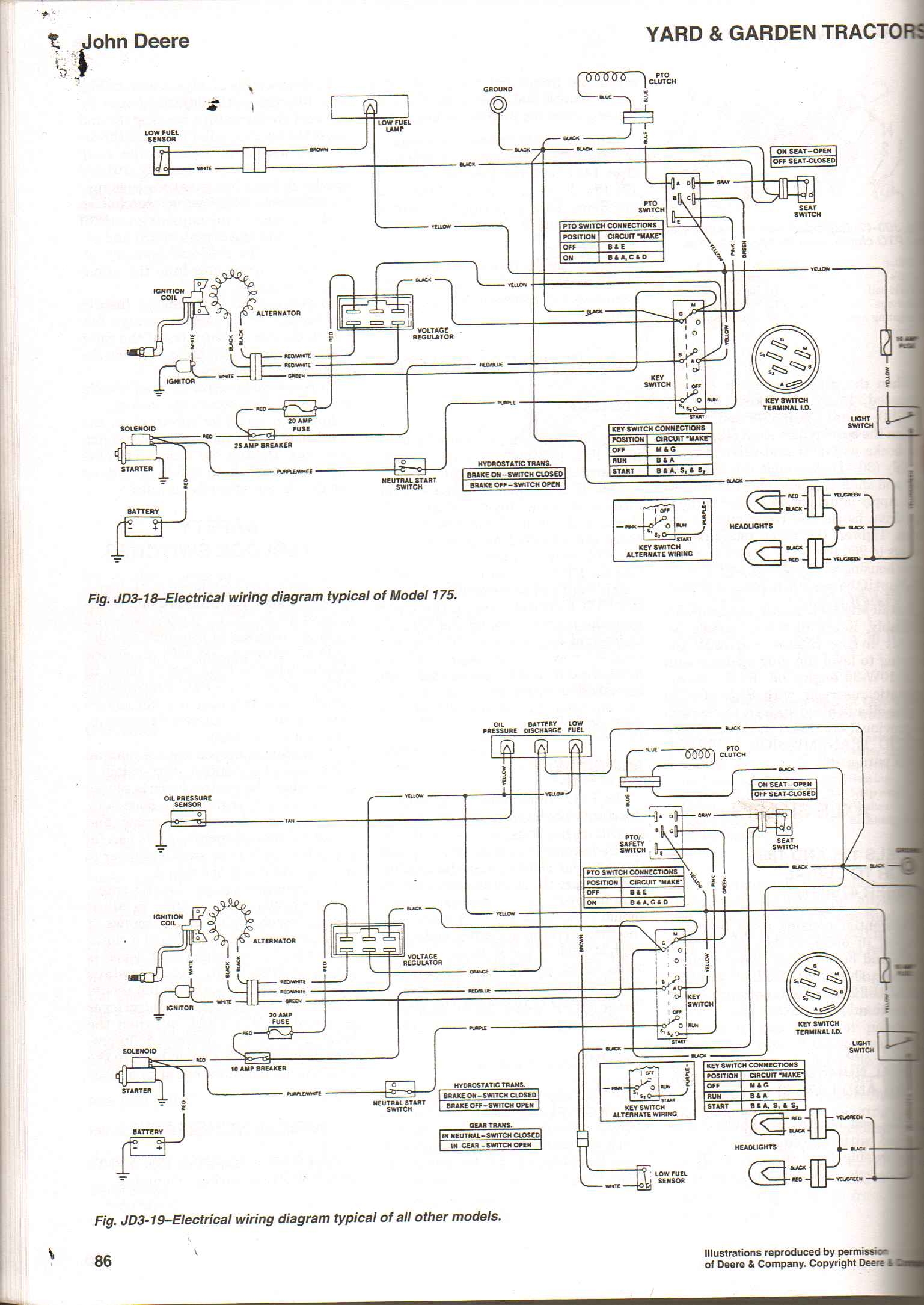

Looking for some help. Have a 10 year old d170. Blowing 20A fuse when trying to engage the mower deck. Just changed the pto switch yesterday. Mower runs and drives but blows fuse and will not keep blade running when you change it. PTO clutch? Tried to read the wiring diagram but it's fuzzy when you zoom in. I don't know what the parts are.

Unplug the connector at the top of the clutch and see if it blows then.

Here is the wiring diagram:

The 20 amp fuse goes to the voltage regulator. Could be a problem there.
