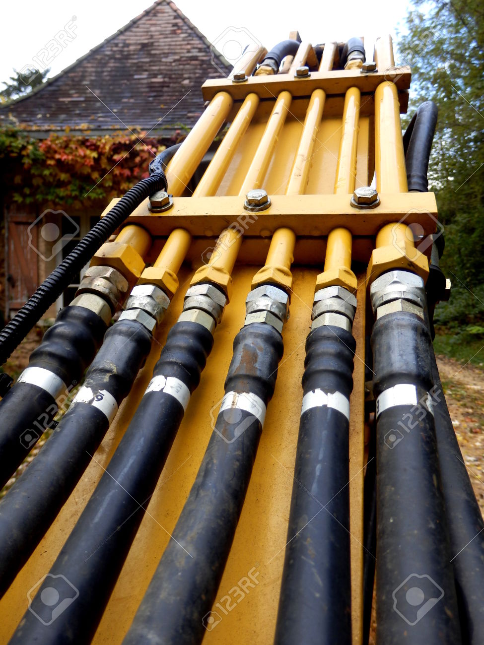

This is the type of hose arrangement I was thinking of.

That's what I need to look at tomorrow, wasn't sure if the hoses just go to the cylinders at the bottom or to a solid line like that
   / John Deere controls to Cat style
#13
You are right Tom, the hoses go out to all of the cylinders. I just sent an email to the woods guy this morning, I will hopefully see what he says about this by the time I get off work. Seems like maybe it had something to do with the swing speed control.

Thanks for sending that on to me but it appears that it might be a little different application then what I have, I will take a closer look at it when I get home. I seems arc weld was right, you can't just change hose positions because of the relief valves. The woods guy said that I would be bending and breaking things. He said that it was a pretty labor intensive job as far as time goes to change it over. Long story short, I think I might be getting used to JD controls!

Yep, didn't expect it to be exactly like your situation just wanted to show that just moving hoses may not be the best route to go. But like you mentioned...once a machinery operator knows one system they can typically learn another in a relative short amount of time.
