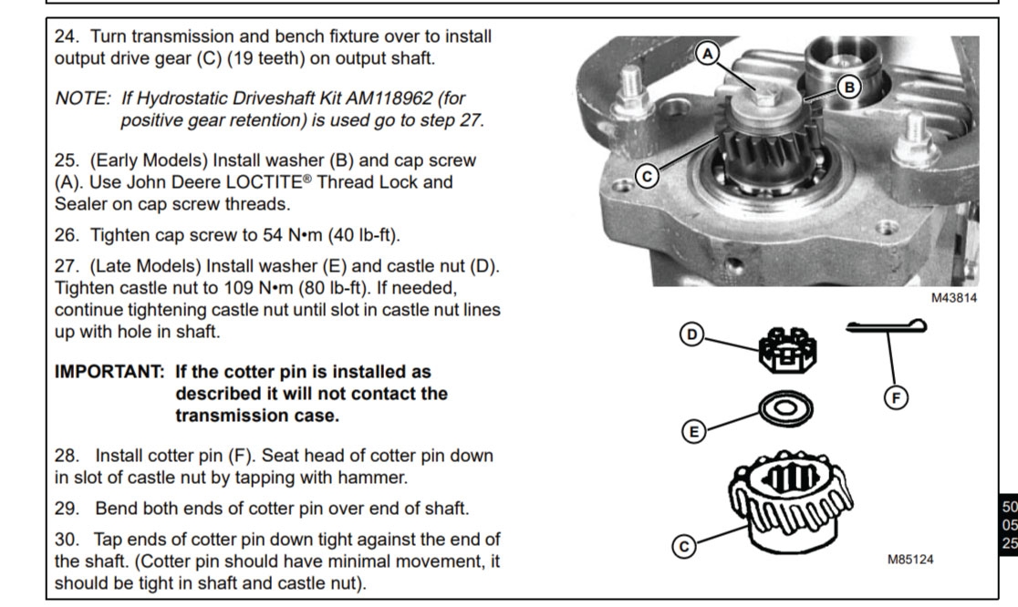

Which bolt broke? I don't have a repair/parts manual handy. Following, and awaiting your findings... Good luck.
/ John Deere 955 won't move.
Bolt "A" seen in this photo. The later models switched to a castle nut since it was a common failure point.

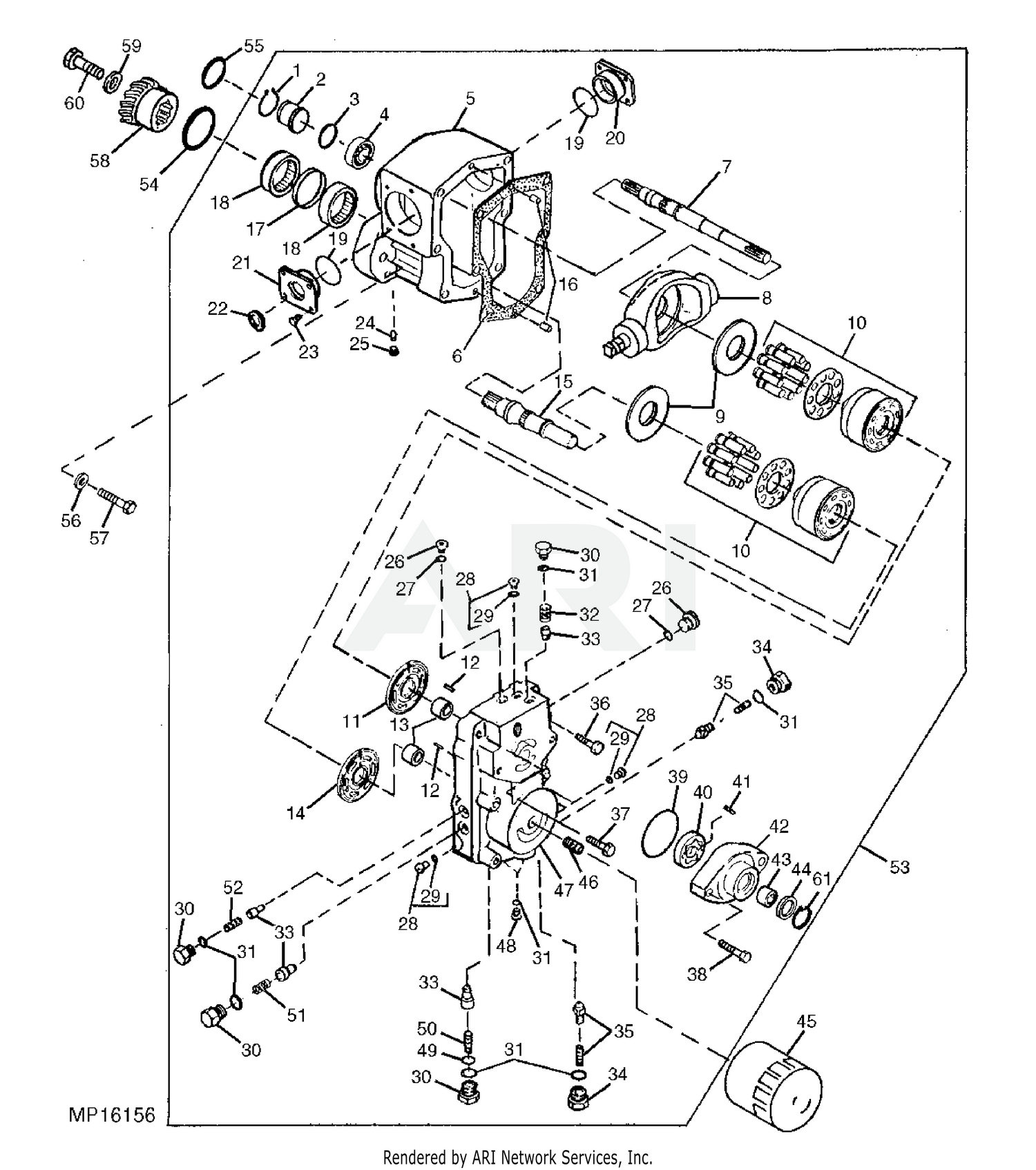

Is that an output gear or does it drive the HST pump? It almost looks like an output. Would a lose nut cause enough gear slop to break the bolt? Maybe a larger exploded parts diagram would help.

Ouch! Thanks for the pic. I see where that failure would be bad...

It is the hydro output gear. The bolt broke and the gear (inside the transaxle) was loose. While the bolt was broken the output gear still slightly meshed with the gear inside the transaxle, so it would still drive, but due to the angle of the gears it would slip off and not go into reverse. I replaced the bolt and removed the broken bolt and washer from the transaxle, so it should be good to go now.

For more clarity on the original broken part: Bolt #60 broke. Bolt head and washer 59 were fished out of transaxle. It has been replaced and the hydro has been reinstalled.
