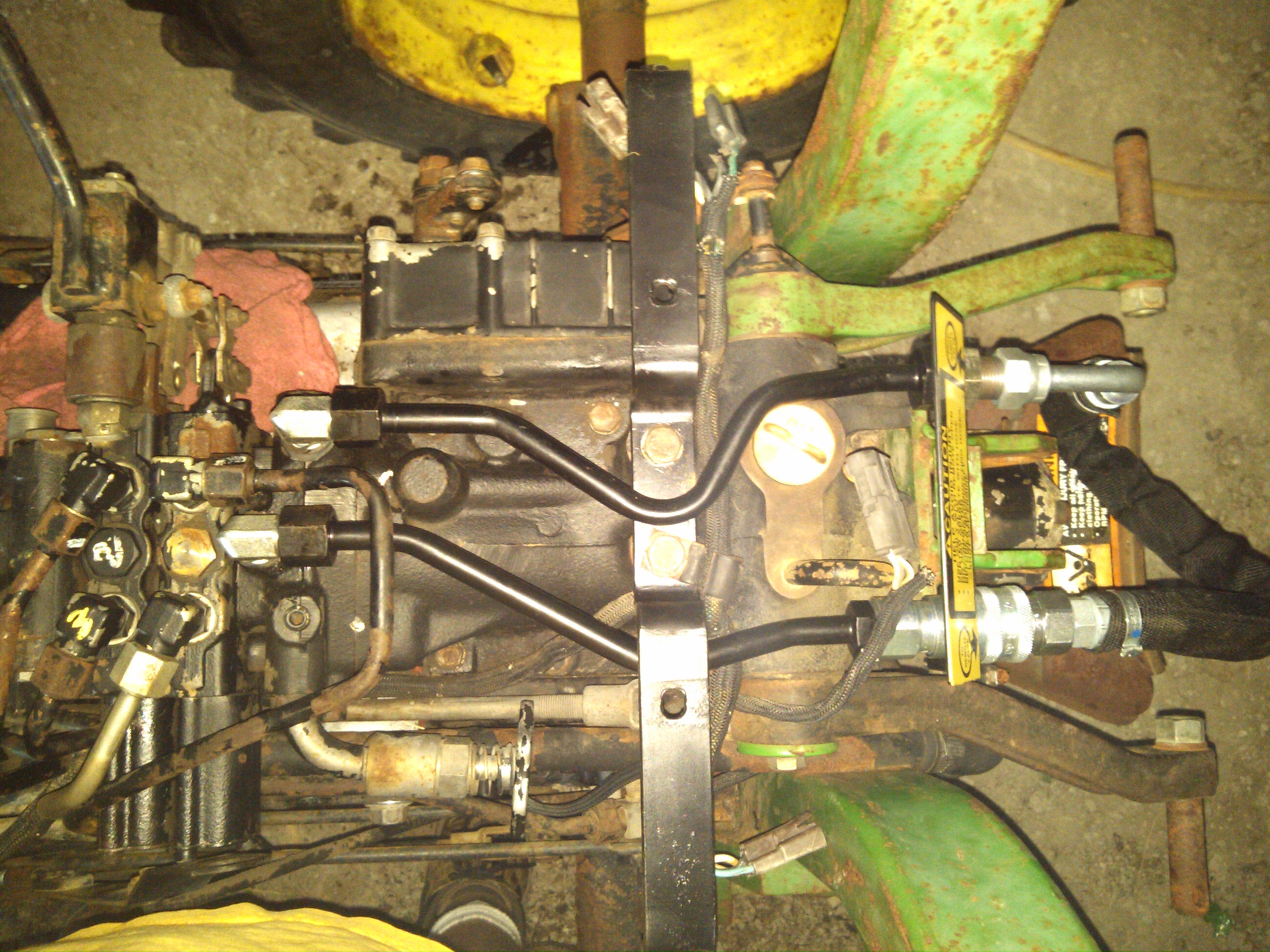

Why did you remove the power beyond kit? If you just connect the two ports together with PB hose, it will complete the circuit and everything will function as it should. Then when you want to reinstall the backhoe (or any other PB device) just disconnect the hose and route it through the attached device. What you have done is deadhead the hydraulic circuit and put the whole system into relief until you either complete the PB circuit, or remove the diverter plug.

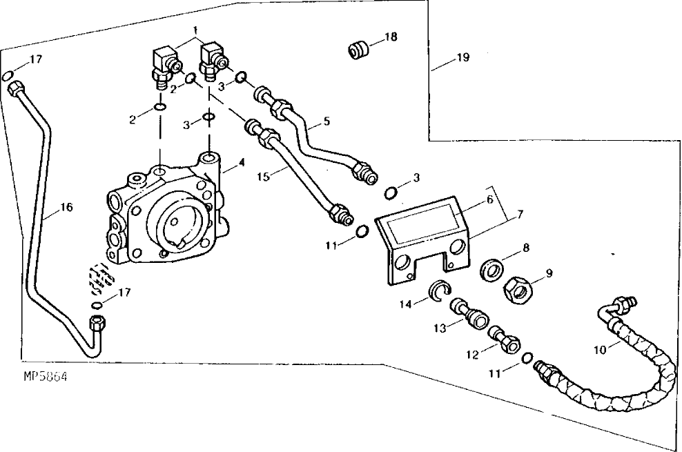

If you blocked the two ports after removing the hoses, then your tractor is in relief whenever it's running and you can overheat the fluid and/or damage the pump. You will need to remove the "plug" #19.
AUXILIARY HYDRAULIC KIT
Cart key PART NO. PART NAME QTY SERIAL NO. REMARKS
1 38H1314 Elbow Fitting 2
2 R26448 O-Ring 2
3 T77857 O-Ring 3
4 AM105111 Hydraulic Cylinder Cap 1
5 AM105468 Oil Line 1
6 M72810 Label 1 (E)
M76402 Label 1 (F)
M93620 Label 1 (G)
7 AM105469 Bracket 1
8 24M7051 Washer 1 21 X 37 X 3 mm
9 T78716 Nut 1 20.625 mm
10 AM105465 Hydraulic Hose 1 INCLUDES A CLOTH SHEATH AND A 90 DEGREE BENT STEM
T13119 O-Ring 1 INTERNAL
11 R26375 O-Ring 2
12 AM105467 Hydr. Quick Coupler Plug 1
13 AM105466 Hyd. Quick-Connect Coupler 1
14 M42702 Snap Ring 1
15 AM105470 Oil Line 1
16 AM105464 Oil Line 1
17 T77613 O-Ring 2
18 PT13744 Plug 1 DIVERTER
19 BM16762 Kit 1 600001 - 610000 (655)
BM16762 Kit 1 800001 - 820000 (755/756; 855/856)

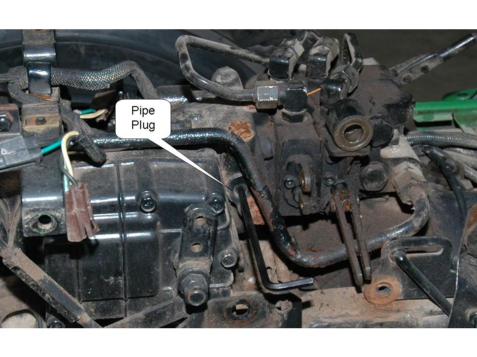

Someone posted this annotated picture several years ago... I can't remember who for proper credit, but I saved it and just ran across it. This picture shows the location of the diverter plug access plug. You first remove this plug, then reach inside this hole to another socket head plug. This internal plug is the diverter plug. With no diverter plug, there is no power beyond circuit. With the diverter plug, hydraulic oil is routed through the external power beyond lines and back into the machine on the other side of the diverter plug.
Second pic is the external power beyond lines and hose connecting them when no PB is required.
