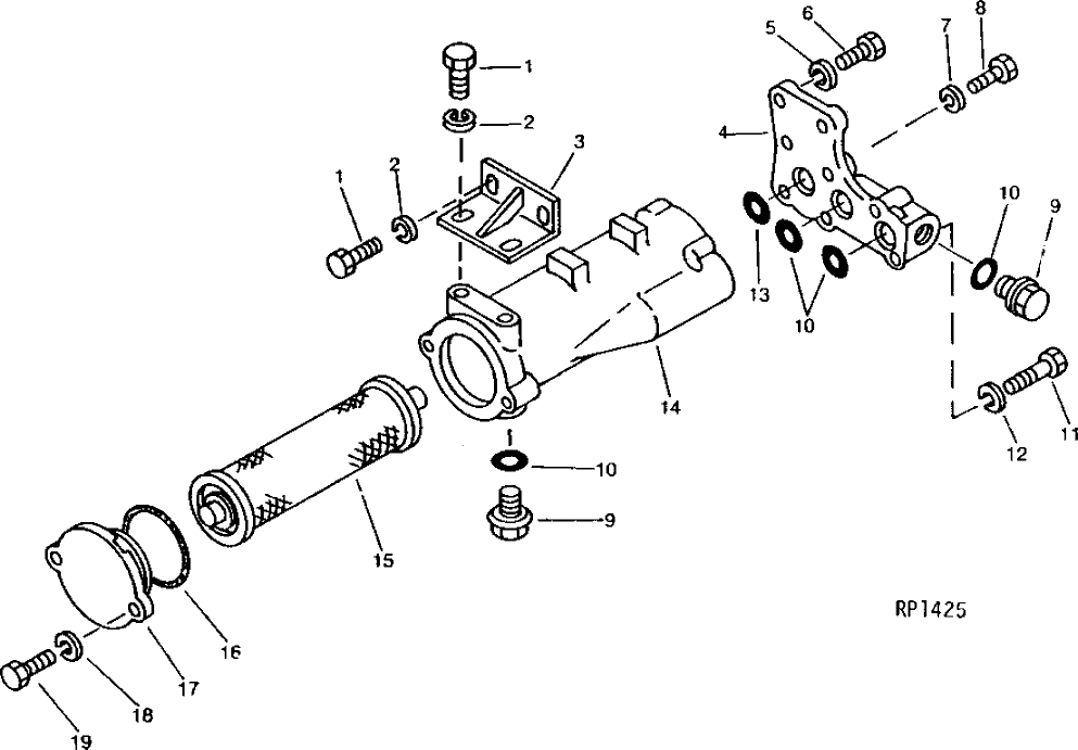

   / John Deere 850 hydraulics problem #3
pjtreacy
Is this the filter you changed? I saw no sump screen in the PC.
the filter I replaced is a typical canister type. It is inline with the low pressure side.
PT
pjtreacy

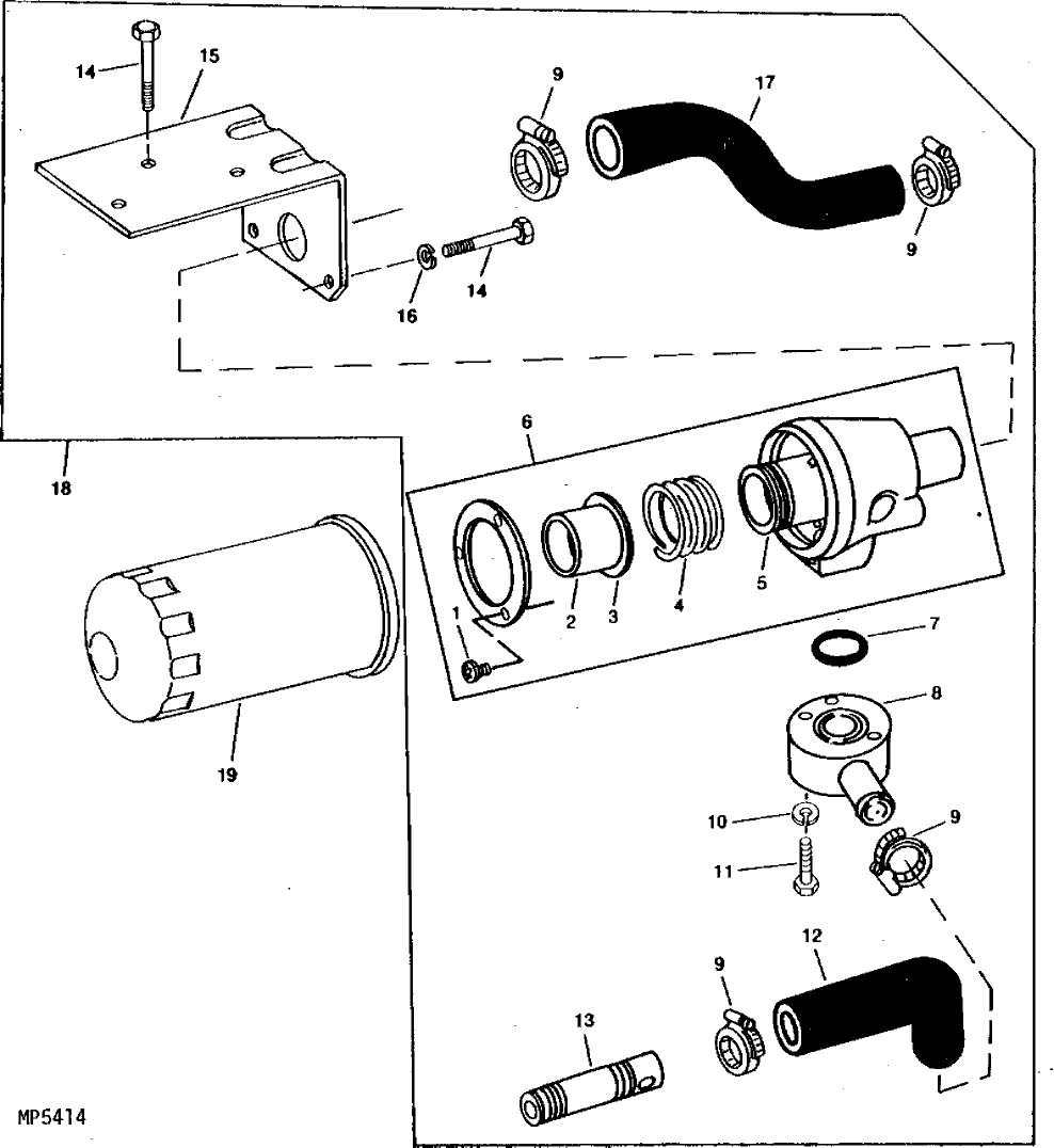

   / John Deere 850 hydraulics problem #5
Later model 850's had this hyd filter.
that's the one I have. Would there be anything else "Clogged"? Otherwise, since it is all of the hydraulics would that narrow it down to the pump?
