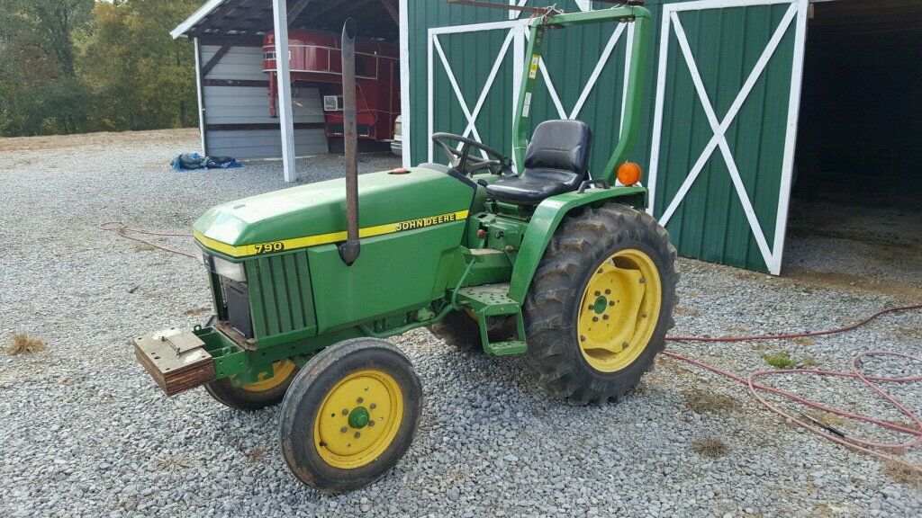

Hello,
Long time lurker, tractor geek and shade tree wrench turner. I've recently acquired a 790 and 990 from an estate. Going through the basics and the 790 starts and runs like a top. Upon engaging PTO, engine immediately dies. Has to be electronic. I've ordered the manuals but won't be home for a week to get into it. I'm guessing it's a safety lockout not engaging but wanted to see if anyone else has had this issue.
990 hasn't run yet. I'm sure you'll be hearing more about that one here somewhere as well. Appreciate all the experience.

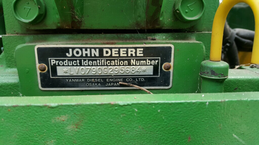

Appreciate the help. I'll look at the schematic. As far as the serial number, upon checking tractor data my serial number is higher than the last option listed. So I'm assuming it was one of the last ones off the line. Bummer it's the lower HP machine, but for the price I paid, it doesn't matter. Here is the serial number if the more informed among us have a comment as to exactly what year machine this is. IMG_1478442342.314625.jpgIMG_1478442360.289657.jpg

Looking at tractordata.com your 790 is probably one of the first John Deere 790's sold as the serial number is LV0790G29XXXX. I'd bet their information is not complete. tractorbluebook.com has 790's listed back to 1999 but no serial number information. Your 790 also has the exhaust pipe coming out of the side panel like the original 790 with the 30 HP engine. For reference, I bought my 790 new December 2007. Serial number LV0790S19XXXX.
2000: 390001
2001: 470001
2002: 570001
2003: 670001
2004: 790001
2005: 890001
2006: 900001
2007: 190001
tractordata.com - John Deere 790
tractorbluebook.com - John Deere 790 4WD
/ John Deere 790 PTO engaged kills engine #13
Mine was a 2004 model with the 2nd engine (of the three used in the 790)...27 Engine and 24 PTO HP. It also had the vertical exhaust.
I thought all the 790's had the vertical exhaust...not sure about the 3005 machines though.
#14
Hey dirt ditch. I was wondering that myself, but couldn't find any info on 2wd with numbers that low. I didn't think these machines were that new but was assuming the counter tripped over to 2xxxxx after the listed starting number for '07. Make sense they are older but now I've ordered the incorrect manuals. That stinks. Well, see what shows up and how that matches to the physical when I get home in a week.
