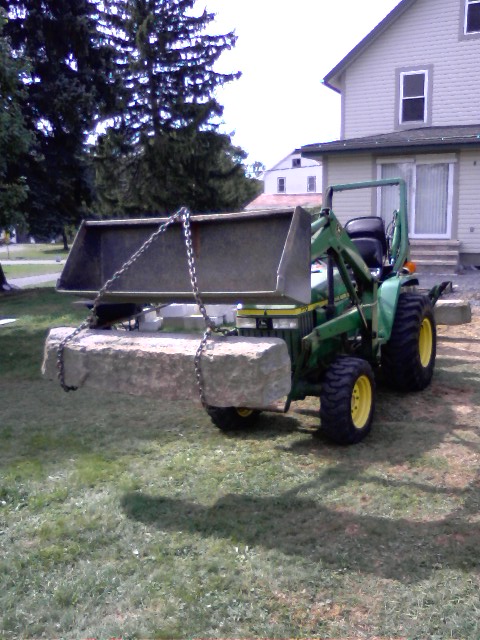

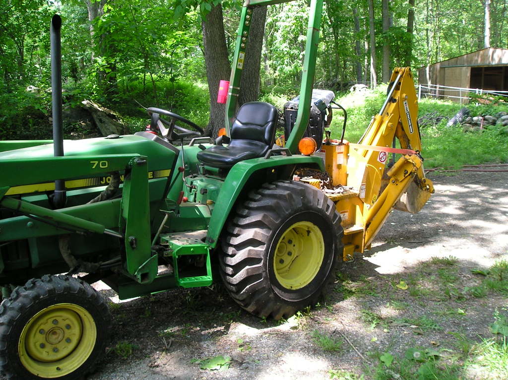

Like gkhammond said you can buy all four rims for the 790 or you can reuse the rear rims and just buy front rims. I had a 770 with turfs and did the homework to swap to R4 tires. 12.4-16 trac loader tires in rear (they'll go right on your rear rims, and 23x8.50-14 trac loader tires in front. The front rims are the same as with turf tires. Deere part number for front rim #7JA - 14WDC .
See this site. John Deere - Parts Catalog
The MFWD ratio for the 770 and 790 is 1.571 (I got the ratio from Deere) and with the above match the front lead is within specs.
Here's my thread on the subject. http://www.tractorbynet.com/forums/john-deere-owning-operating/99396-790-770-mfwd-ratio-r4.html
Here's what it looked like with R4's.
