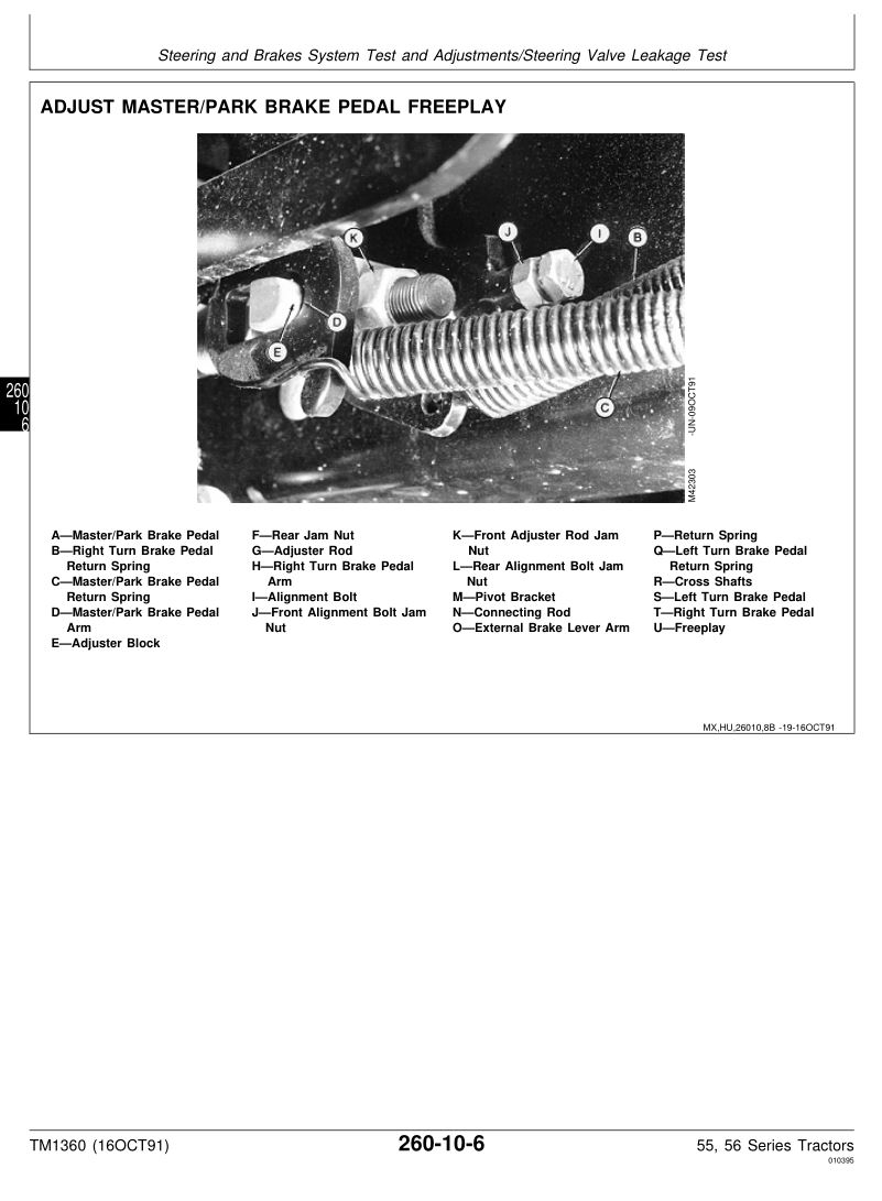

I bought an 855 this year that was misused. I have spent $2500-3000 on it so far....but I had the dealer do the work. Parts for these older machines can be hard to find and expensive. Like you, I got the tractor at a great price so I do not regret buying it....yet.
My dealer would not rebuild my FEL cylinders, he wanted me to buy new ones, but any good hydraulic shop can fix the leaks. Can’t imagine not having a FEL but then I only have one tractor so it needs to do everything.
BTW, my EB does not work either. I found the copy of the service manual I bought on EBay was useless on addressing that problem so it looks like another visit to the dealer.

Sounds like you have a lot of other troubleshooting to do. Best get yourself a set of factory manuals. The tech manual should be TM1360. You may also need a CTM3 engine manual.
