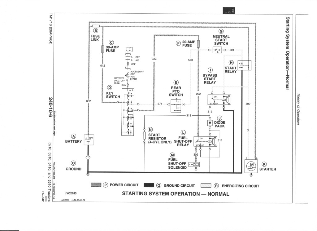

My jd 5420 has no power at fuse controlling key switch circuit

I provided the URL to the operators manual, which fuse box is the one for your tractor? It looks like the key switch (30amp) and the fuel solenoid (20 amp) are on 2 different fuses.
I own a 5210, depending on the model of your 5420, the wiring is the same. I have attached a picture of the starting system for 5X10 models, does it look like it matches your tractor. Hope this help trace things from the fuse link to the key switch.
