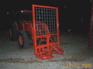

Can't answer your question directly . . . when I did the fore and aft cam install on my B3350, I gave up and took the easy way out using a sub-mini toggle on the loader joystick (there was already as small housing installed there for the 3rd function with enough room to accommodate one more switch. I figured there'd be times when I wanted to keep and eye on the 3-point implement while going forward.
I use the forward cam (mounted center on the front loader) far more than the back one.
and
This works for bucket and pallet forks. Did make one change and that is the stalk has about a 15* forward bend between camera and top of bucket. Oh, and it's maybe 6" shorter than the one shown. This for clearance issues in some configs with the camera and brush guard. The stalk has a quick clamp for fore and aft and also length.
bumper

I like how you added the camera but I will need something more substantial as it is going on for a tree shear my dad just bought so it will be getting hit by branches and stuff like that. I'm going to build a case for it and either put it directly on the shear or on the loader. This is basically what he got, it is supposed to cut a 14.75 inch tree in one cut and larger in more cuts. The salesman said to make sure the tree is back in the wedge as far as possible to prevent the blades breaking. I would prefer to mount it on the loader frame somewhere so that I don't have to undo the weathers each time.View attachment 397936
I agree (I made mine so it swings out of the way easily if I'm working in brush etc.). The camera is very "hardened" by RVS. In your case I'd weld on a 3/16" steel box or guard on the top bar and mount the cam in that. The camera has a quick connect, so changing implements is easy. Then get a separate cam for your loader if desired ($100). I'm really pleased with the RVS system, good definition and easy to see in sunlight (I have a cab though, so that helps). Only time the camera gets faked out is when sun is low and shining right on it, or it's very bright outside and the area of interest is shaded. I guess I could try adjusting monitor but haven't bothered yet.

I'm thinking of putting it on the bottom of the wire mesh at the top of the T due to the fact I'm going to be working in trees with low branches. I might just use zip ties to put it on that way I can take it on and off easily and put on the loader frame when I'm not using the shear. Otherwise I might just get the wireless ones but I don't spend like spending another $100, it's $274 for the monitor and two cameras wired and then $384 for the same but wireless. Also the camera on the loader, when I am square baling I will take it and put it by the knotters to see what's going on there.
