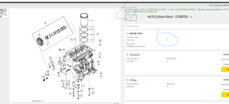

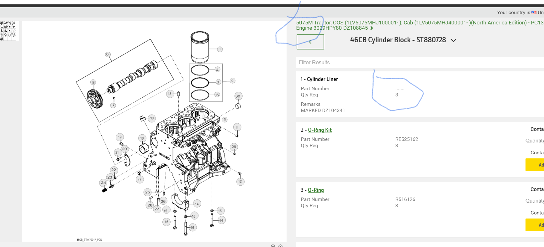

Where do you see the switch made to 3 cyl. ? TractorData shows the next model up had a 4 cyl, but don't see a 3 cyl.
JD parts cat 13349 lists a 3 cyl block/liners for 5075M
