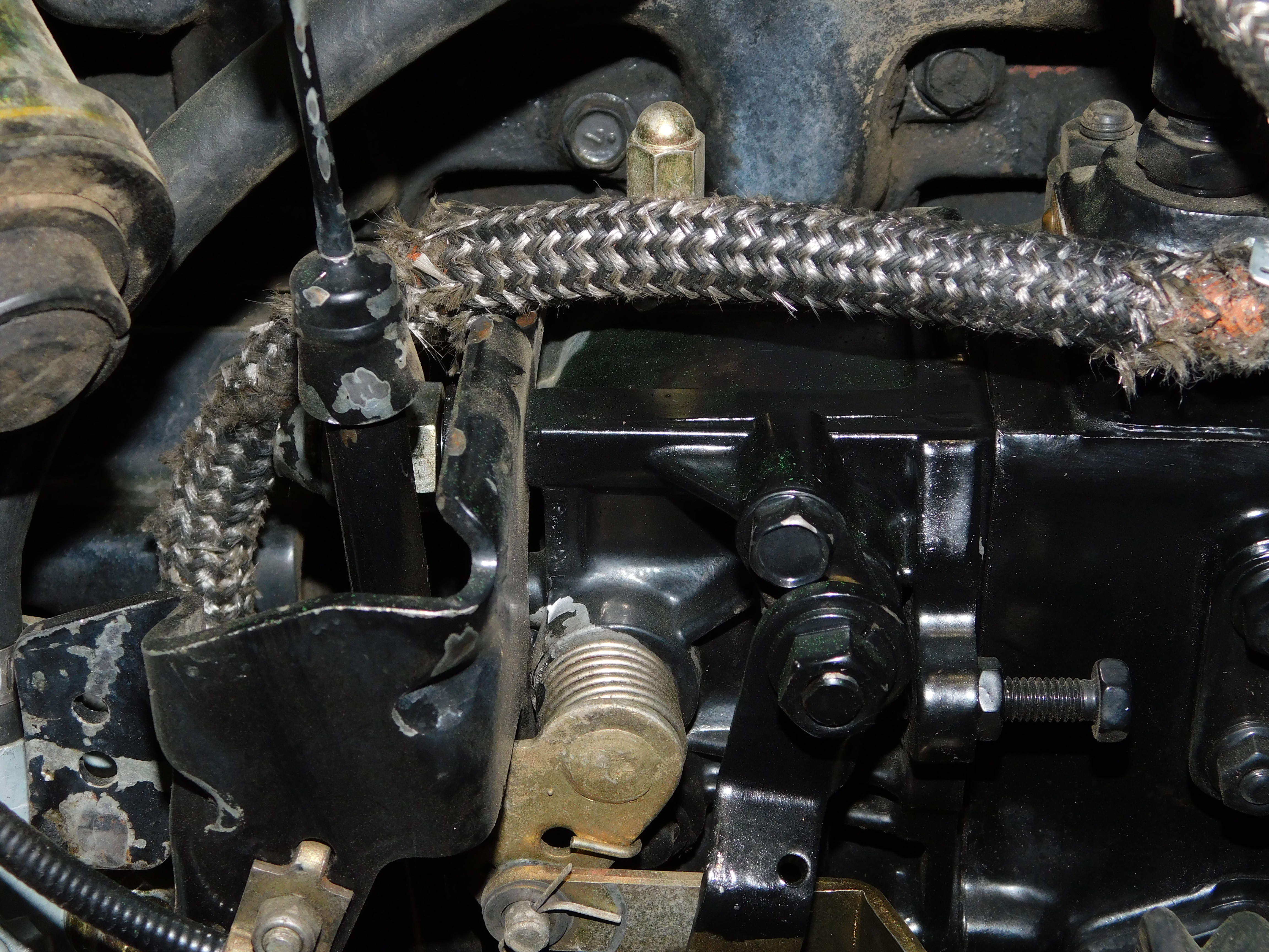

Well I am at 2950 rpms. that 300 rpms is eluding me. pump seems good, the injectors are going to take a bit to clean, and the governor is maxed. replaced the little 2 inch piece of line on the pump because it was pretty shredded but nothing else seems wrong. there is a little nut screw thing on top of the injector pump 90 degrees off from the governor adjustment that I don't know what it is. if anyone knows what does that do? i feel like I am missing an adjustment SOMEWARE just don't know where. Help has been great so far, any more will be greatly appreciated. The parts guy i was talking to is out of injectors so going to run with what I got for now.

the gold colored nut on top is what I am wondering about.
/ John deere 455 Questions #20
According to the manual you have an early style pump, meaning before EPA regs were applied. That gold nut hides the fast idle screw. Remove the nut and under it should be a lock nut with a screw that is adjustable to accomplish the correct high idle, which is 3350 +/- 100 rpm's.
