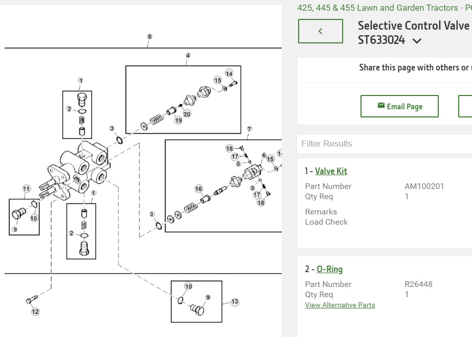

the valves at the front left foot have been taken apart and cleaned
What implement have you had hooked up to these valves.. called dual SCV
Where are you located?
/ John Deere 445 #27
I have never hooked anything up to these valves. Lafayette, GA
/ John Deere 445 #28
On the drawing, 1, 1 ,4 and 7 Have taken apart and all seems to be good. I cleaned up real well and reassembled.
/ John Deere 445 #29
Then I am wondering what problem caused you to take these valves apart as described?
/ John Deere 445 #30
