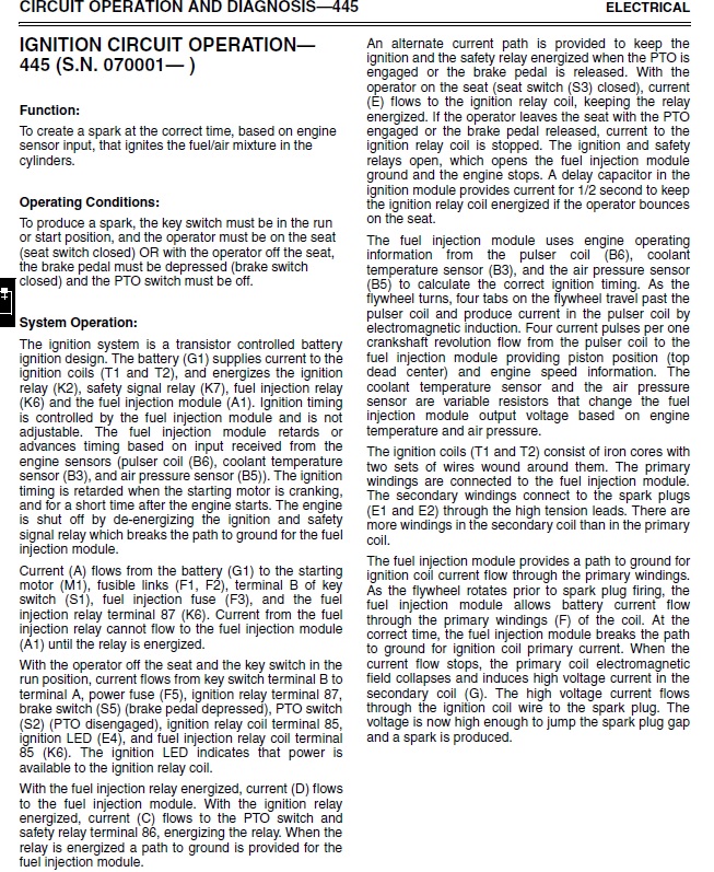

This may give some help in understanding...
Ignition Circuit Operation 445 s/n over 70001
