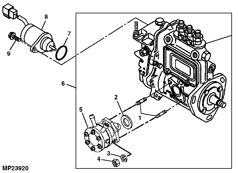

It cranks fine and runs on ether (Ugh! It sounds bad!)! I checked the fuel filter(clean!). I turned the fuel shutoff valve on-and-off and there is only a dribble for both positions. Is there a solenoid valve somewhere?
/ John Deere 4400 Tractor won't start #2
Is fuel control solenoid(parts key 8) clicking when ign switch is turned to on?

No click. Tractor sat idle for a couple of months... What should my next action be?

No blown fuses (except the tail light) and no loose wires....
There is a 3-wire connector and red/white/black wires leading to the solenoid...
Thank You much for the John Deere Parts Catalog!

Can I unplug this solenoid and test it with my multimeter?
Or... connect two of the 3 wires to a battery and listen for a "click"?
Which 2 wires? I would not want to burn it out, by jumpering the wrong ones...
