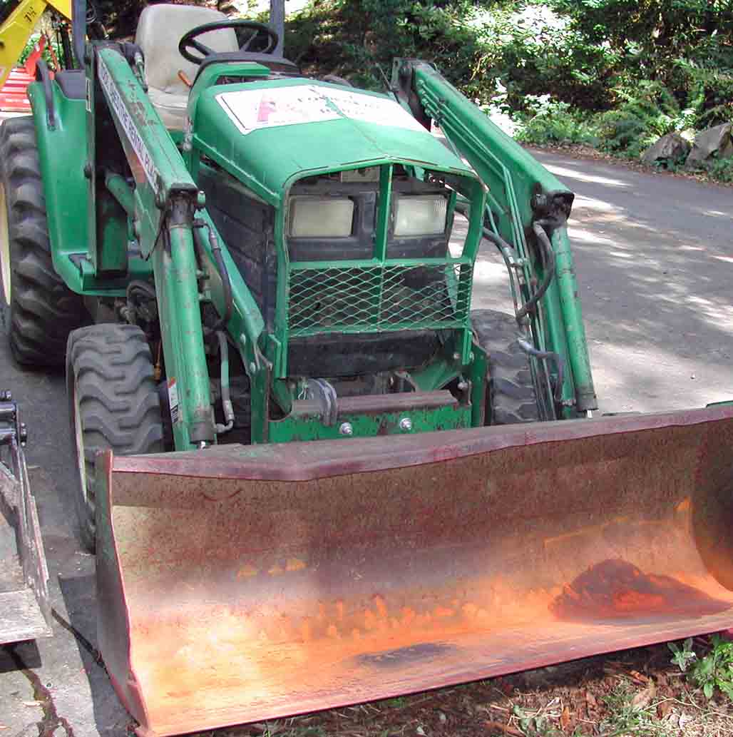

You suggested that I use some "hood armor". I have
never hear of "hood armor". What is it and where can it be purchased?
Here's a photo from one of my rebuild threads. It is part of the "rental service kit"
you can get from Deere.
The hood armor in the kit is welded to a larger grille guard and weighs maybe 100#.
The part over the hood is 1/8" steel plate. The whole thing pivots out of the way
so you can open your hood.

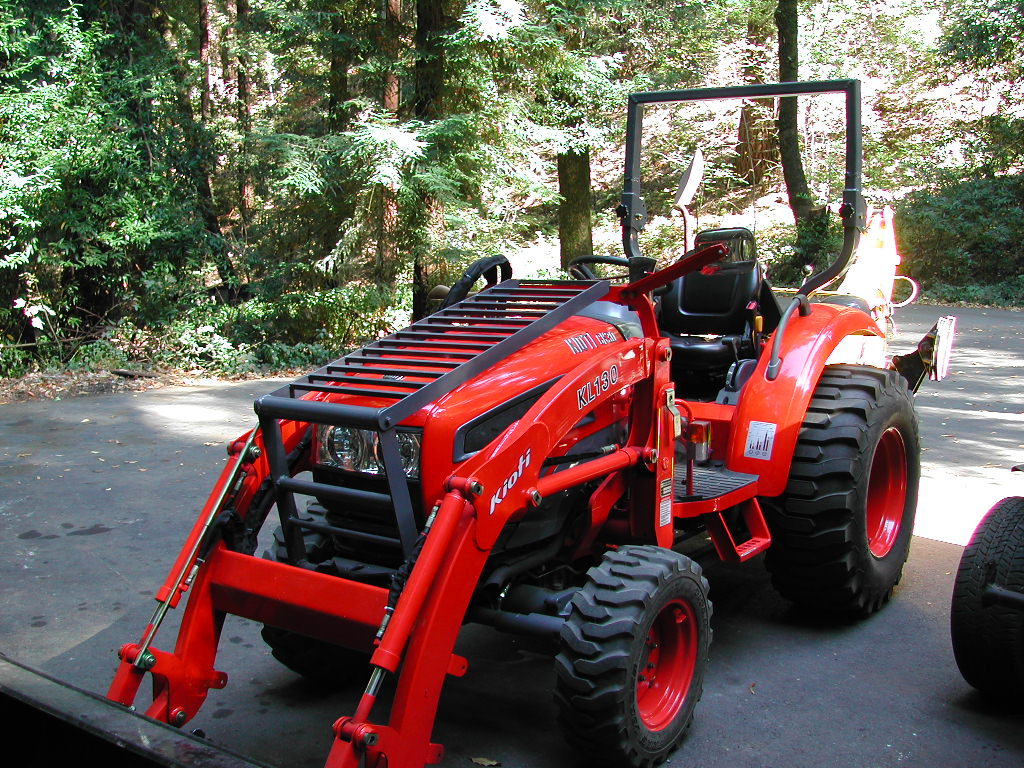

I made my own armor for my Kioti.
