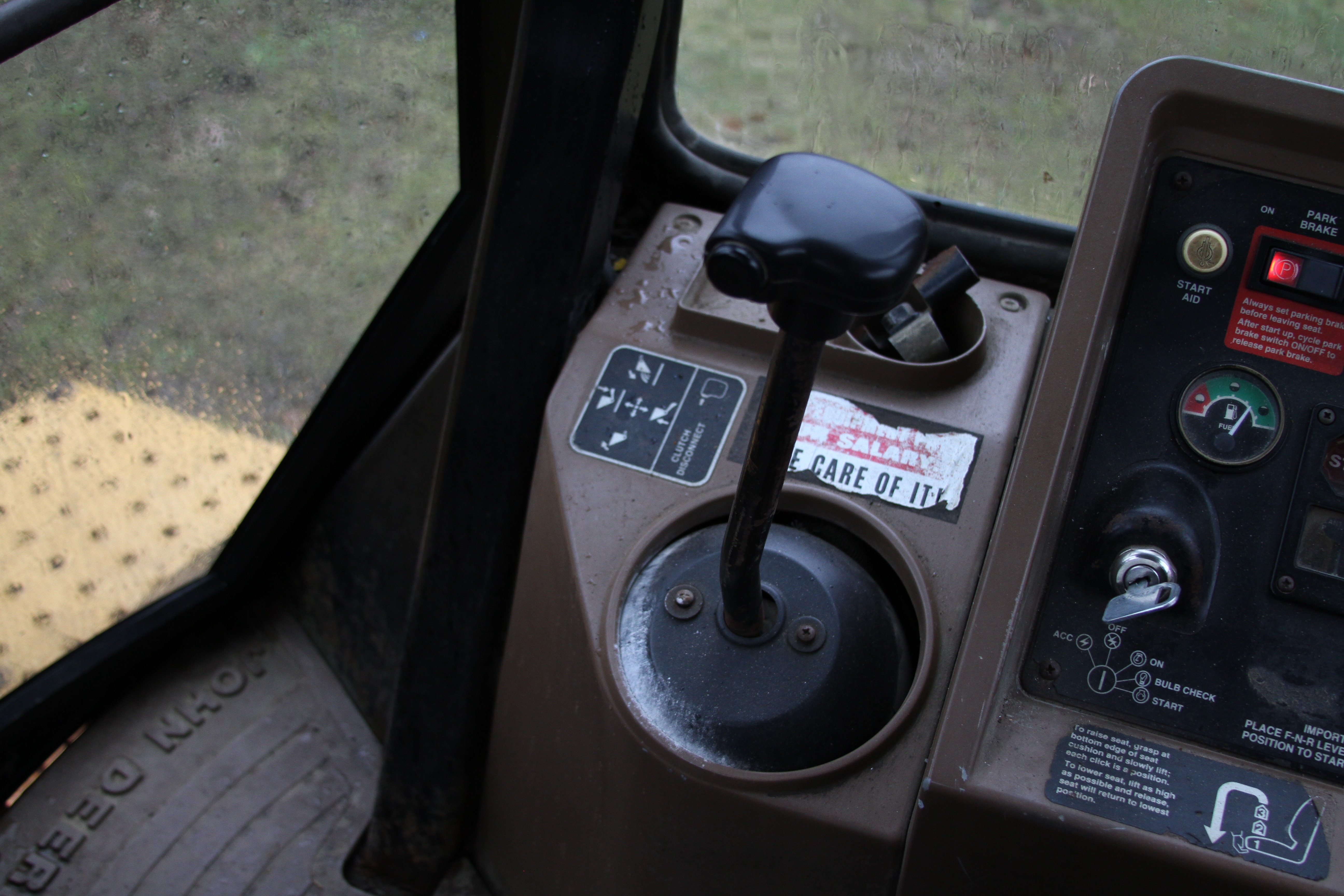

I just bought a John Deere 410D Backhoe and when pulling it off the trailer its in a gear, but won't shift to another gear. The clutch system seems to be working when I push the button for the neutral on the shifter it disengages, but won't let me shift into another gear. I also seem to be stuck in the Diff lock as well and cannot disengage it for some reason. Its back towards the seat and will not move for the life of it forward. Any ideas on what I should check and what this could be? The stick on the console for forward and reverse are working fine, but just can't shift the 4 speed. Also, When i turn the wheel to make a turn going forward it seems to keep wanting to go straight for some reason. I'm planning on putting new tires on and hoping that will fix the issue cuz they are getting low on tread and am planning on putting foam filled ones on. Any advice would be great!

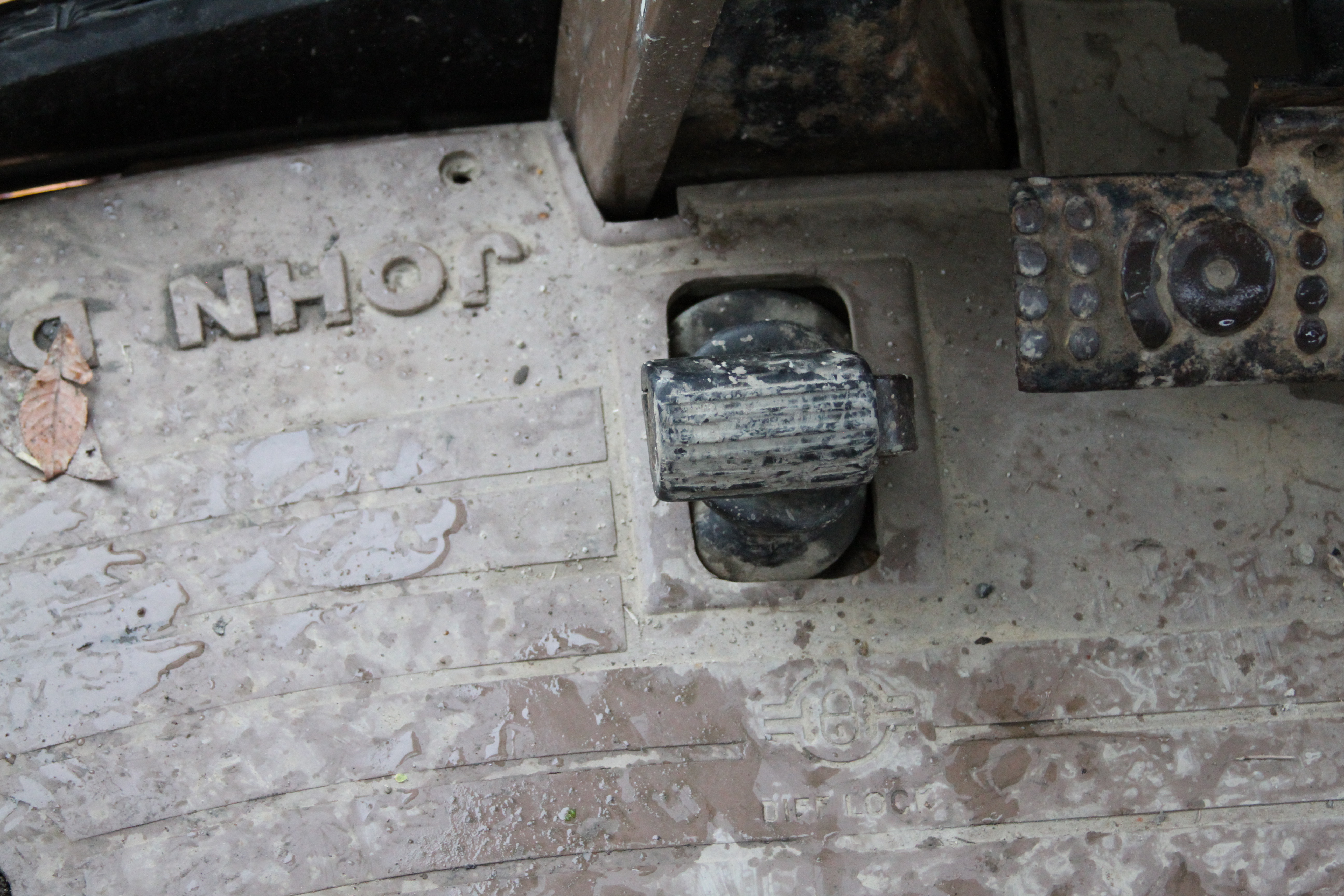

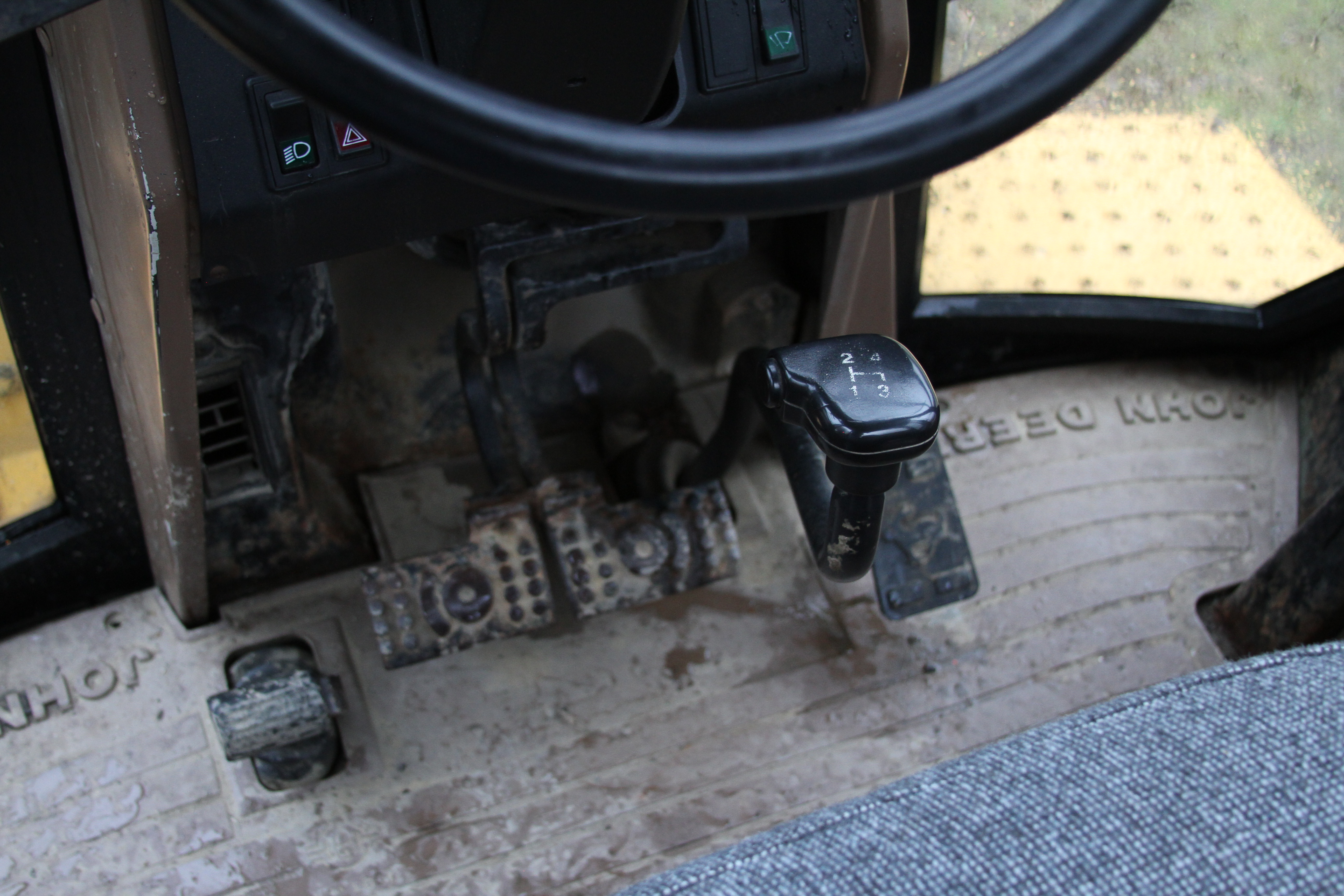

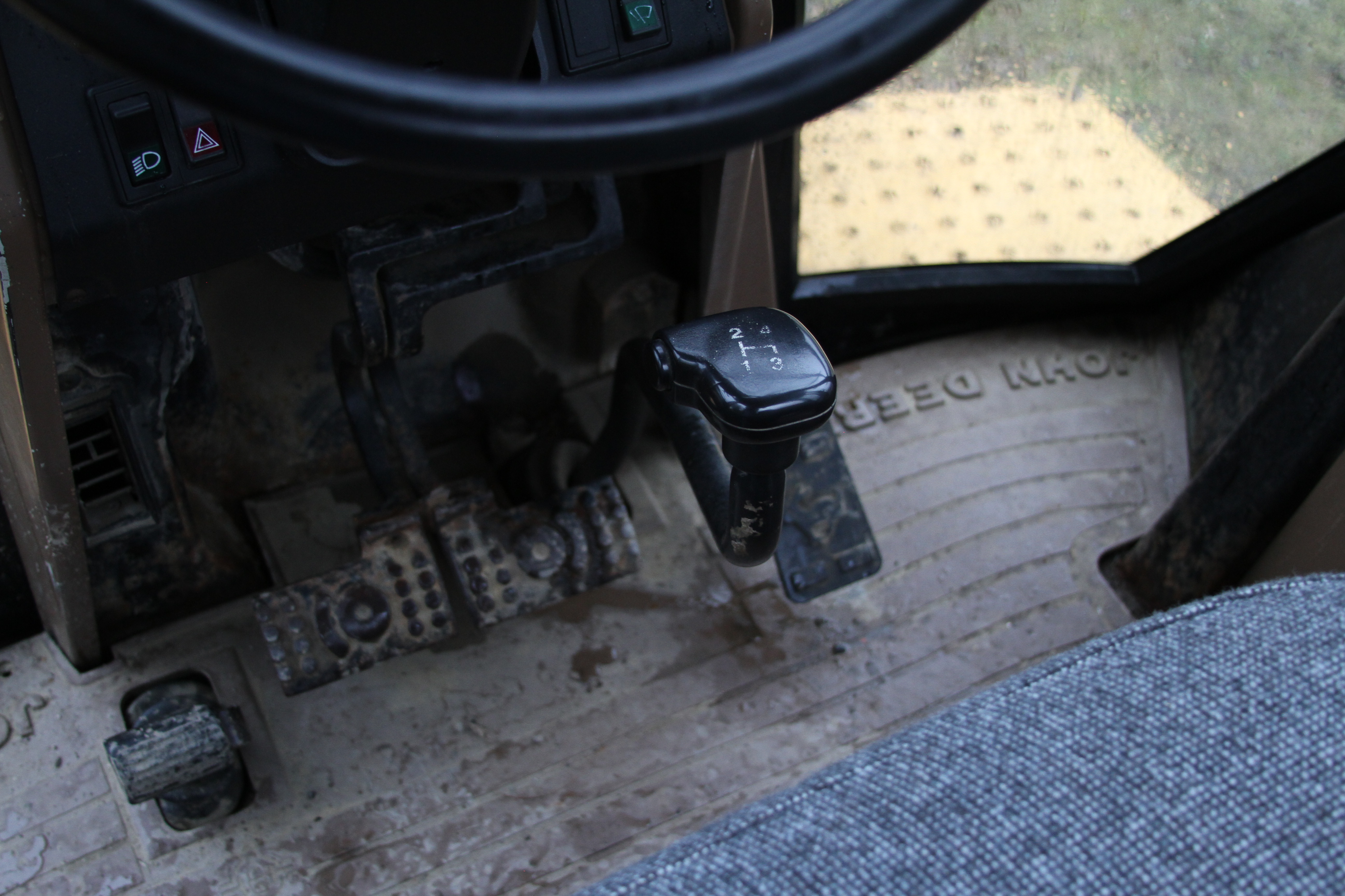

I checked the fluid on the stick and its right where it should be from what I can see. (The one in the cab under the access port in the floor) It does however look old. There are no metal chunks or anything in the oil just has that older color to it. When I try to shift it and watch the linkage it doesn't really move at all. I've attached some images so you can see what i'm talking about. Also I tried what you mentioned about the Diff Lock and still no luck. Tried moving the machine forward and backwards and turning it a few other things to try to get it to disengage and still no luck. Any other ideas?

I have seen these break shift forks is it stuck in gear? Does the reverser work?
Can you feel it try and go in to gear? If so I'd be looking at the clutch disconnect switch and see if is stuck on.

You didn't clearly state so am asking, the machine shifted fine before you loaded it onto your trailer to haul it home? You ran the machine in every gear?
Put your stabilizers down and lift the rear tires off the ground. Then work with the shifter and/or Diff Lock. This will relieve any drivetrain stress that might be causing a problem.
For the Diff Lock, let the machine back down on the tires then crawl under the machine and check all the linkage for binding?? May be some damage under there you don't know about.
For the shifting, that's going to be more complicated. I'd want to eliminate all simple solutions first such as relieving driveline pressure by lifting tires off the ground. Also attempting shifting with the shuttle lever in neutral. If you can't stumble onto an easy solution the top of the tranny with shifter will need removed to look for shifting fork problems.

Update on my problems. So far I found a few things wrong with the machine such as 2 lines leaking Hydraulic fluid, but thats not a huge problem i've fixed these before. My main problem now is I got the Differential lock to move up and down on the pedal, but still having problems with it not disengaging. I checked the linkage and its all moving, but not disengaging it was extremely stuck and had a **** of a time getting it to move. Anyhow any suggestions on what I can try to get this to disengage because I cannot steer this thing at all the tires turn but it just pushes it straight. As for the transmission I think the fork is jammed which we will be ripping this apart as soon as the weather clears up a little currently having a blizzard.

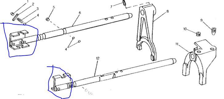

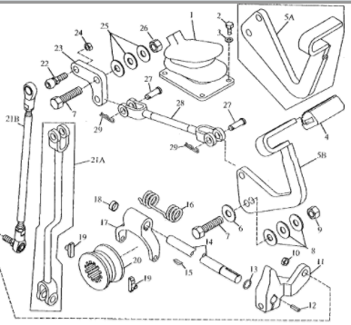

On diff lock sticking my guess is PB Blaster hasn't traveled entire length of shaft(key 14) that contacts axle housing or spring(key 16) is broken. For trans not shifting I'll guess metal tab outlined in blue spot welded om shift rail has broken off. I witnessed these tabs breaking off back when I was employed as a JD dealer service manager.
