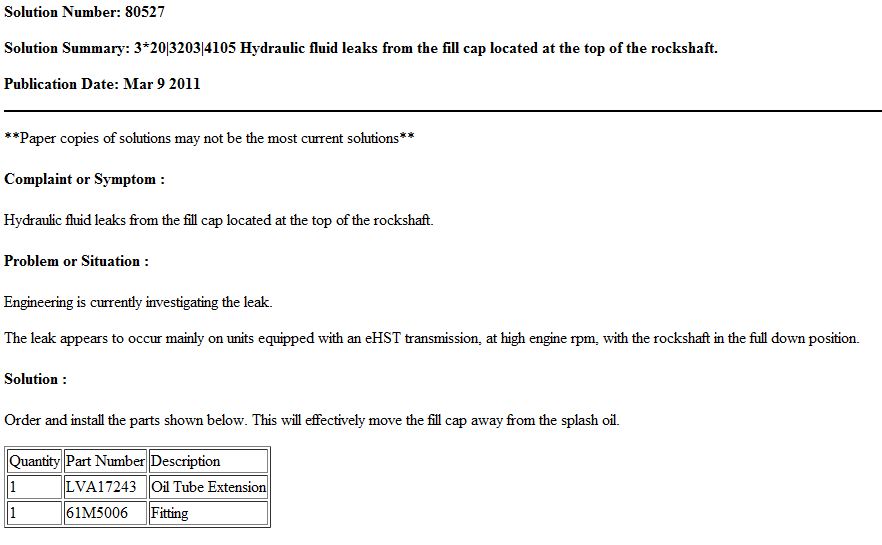

Is it leaking around the dipstick or the fill cap? Keep in mind that hyd oil expands when it gets hot.
I found this service bulletin.
I see the 3x20 series on that. I wonder if I should get the parts even though I'm not seeing hydro leaking? I'm still under warranty.

/ John Deere 4105 #29
Rob
Yes, I would like to see how your dealer handles this.
