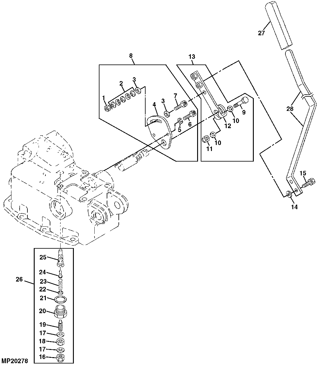

Well the system relief valve is located underneath the rockshaft housing. There my be an odd chance that some foreign debris or a bad spring cause it to remain open and dump to sump. Fairly easy to remove clean and inspect.
Since you say have neither up or down control.
Then there is also the rockshaft control valve itself located under the seat at the front of housing that also has internal directional relief valves. They also dump to sump. This is what directs flow to raise lower and lock in position the lift arms by movement of the rockshaft cylinder.
Along with correct system pressure their also has to be proper pump flow
System pressure tests are normally run to isolate problems,
And are you saying it was known to be working ok when first parked?
Here's a diagram from JD parts online on the main relief valve

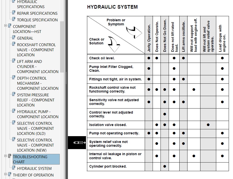

Do you have the service technical manual for the 4100 ? May give you insight on what to check.
Or maybe have to take to a dealer.
Here is the troubleshooting chart for the 4100 from the service tech manual.
