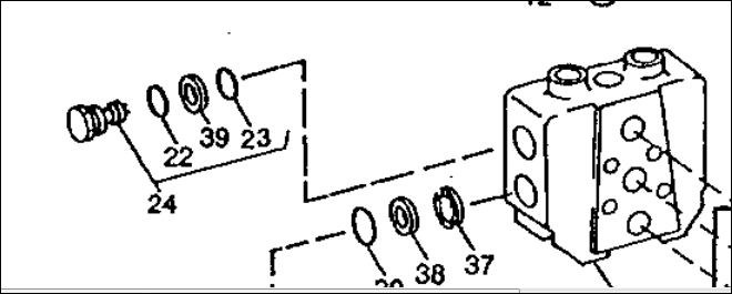

If you replaced frt pump without 1st performing proper diagnostics then you probably wasted money. Many hyd pumps have been replaced to determine that the pump replaced wasn't the problem. Turning hex socket screw in(CW) should under normal conditions increase pressure. Did you check sump screen for cleanliness? Did you check to be sure hyd filter relief valve wasn't stuck open? Do hyd's operate any different with hyd reverser in fwd or rev. Problem could be as simple as a leaking relief valve(key 24) or faulty o-ring(key 23).

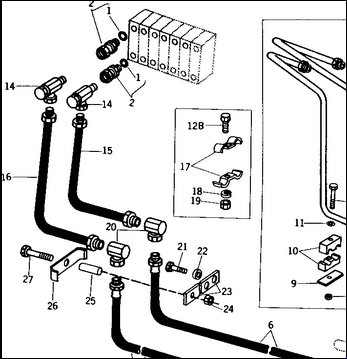

What is that diagram of? When I look at the exploded view I can't tell.

My guess is internal hyd leak is causing trans pump to not be able to supply frt pump enough oil to keep front pump from cavitating(run low on oil) PS: frt pump doesn't have capability to suck oil. You're correct warmer to hot oil is more prone to cause cavitation than cold oil. I will suggest to remove backhoe hyd valve return hose(16) then aim hose in bucket or hyd filler hole then with all BH control levers in neutral start engine. No oil should exit open hose.
