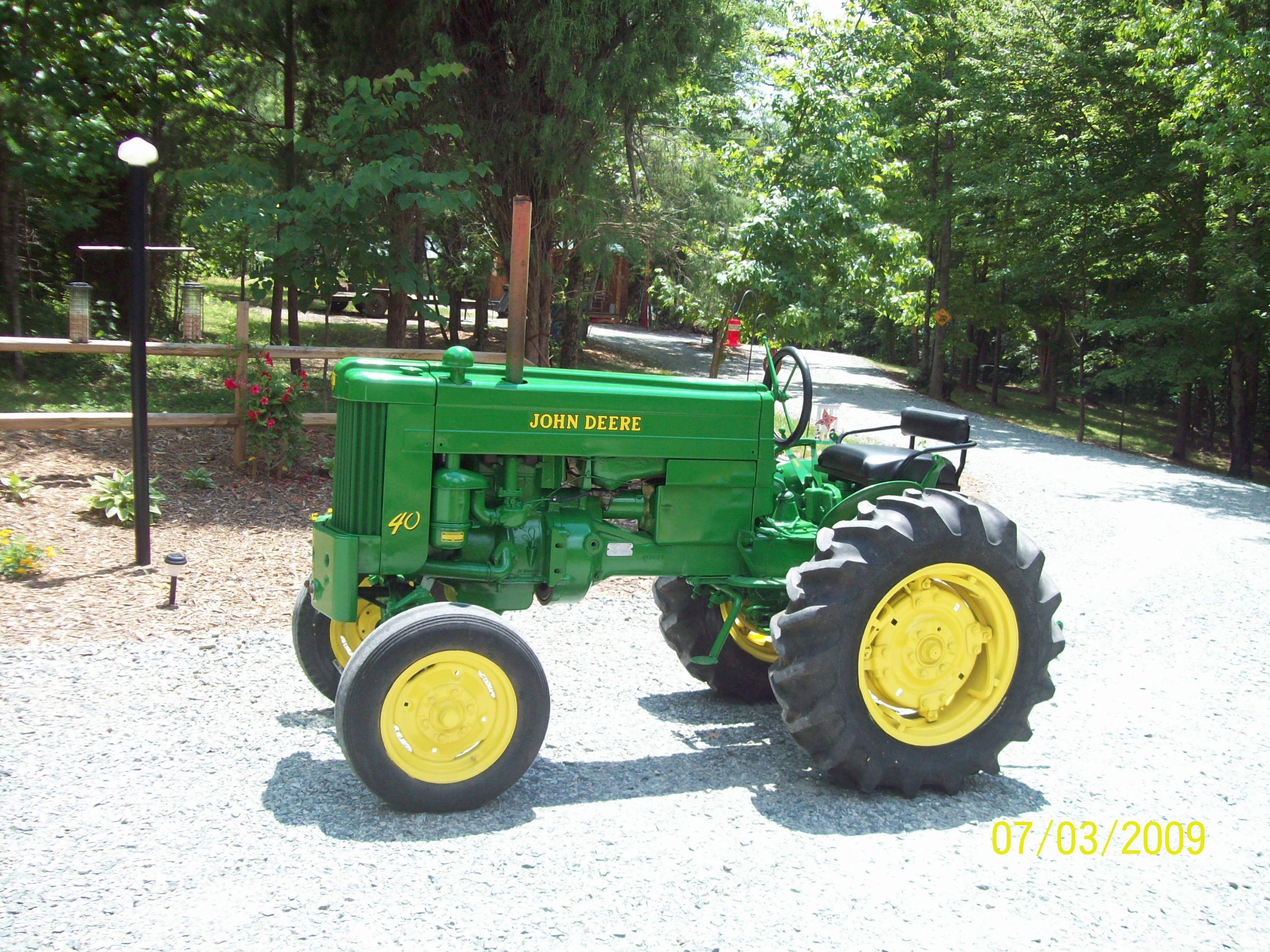

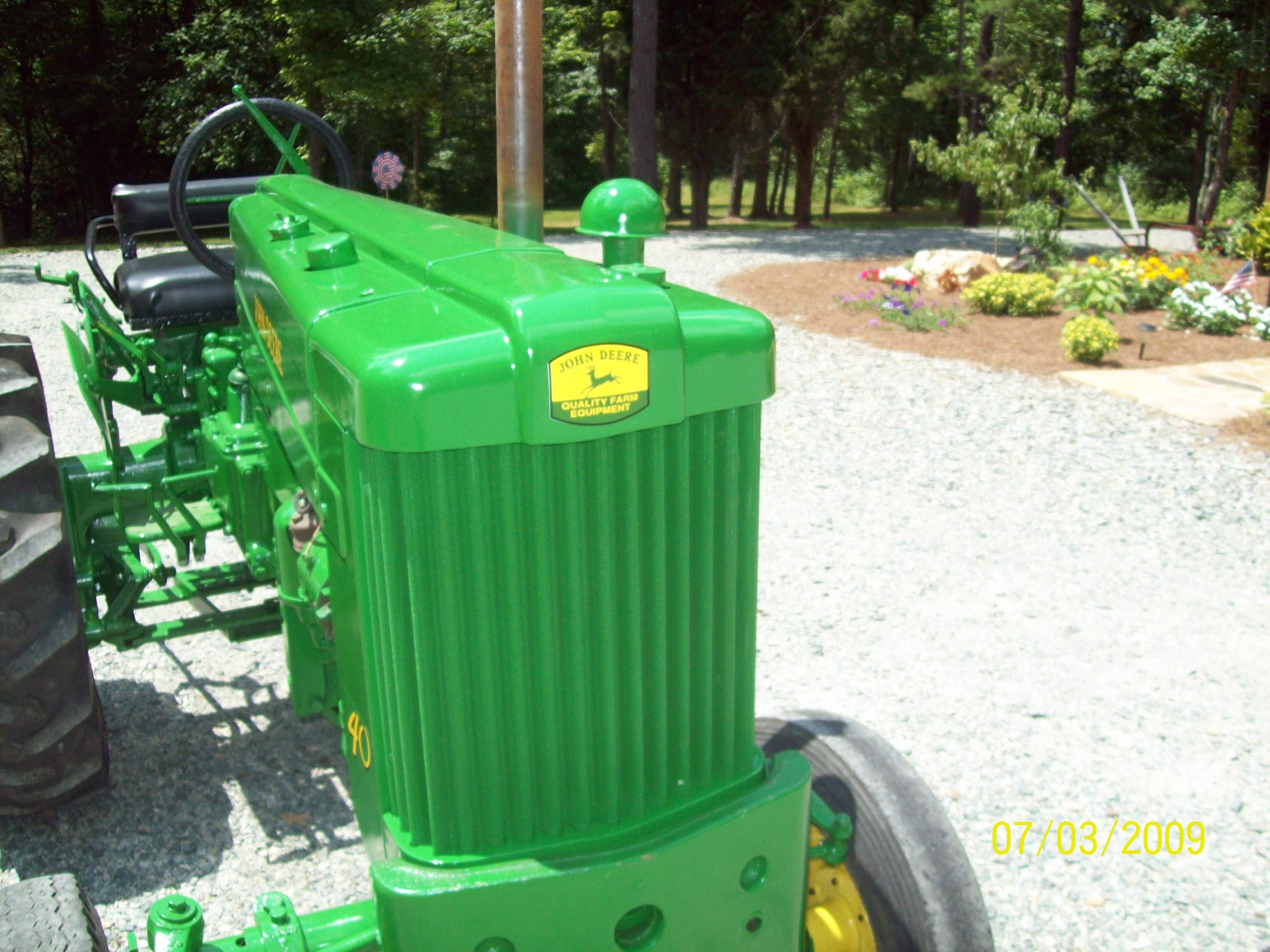

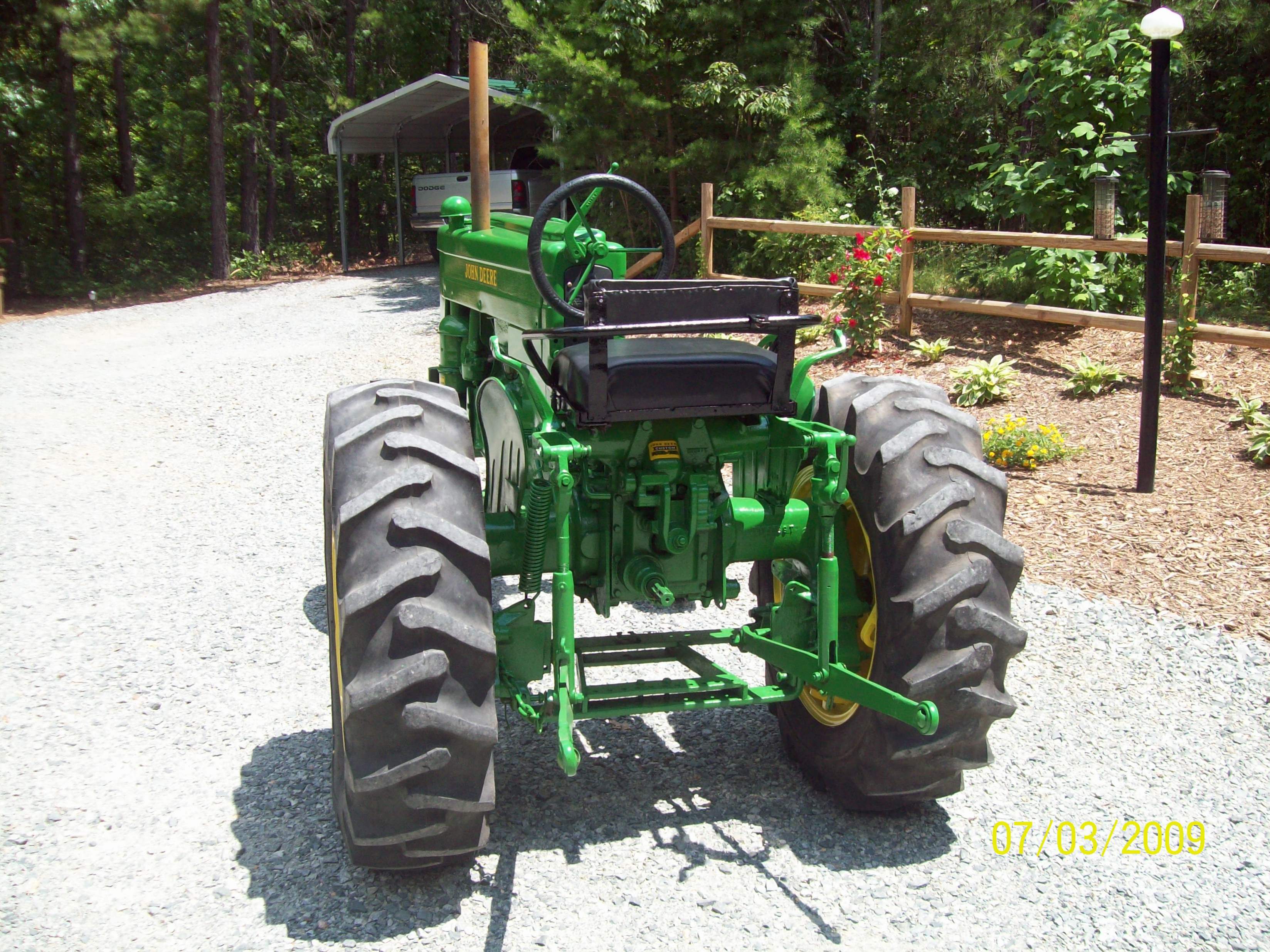

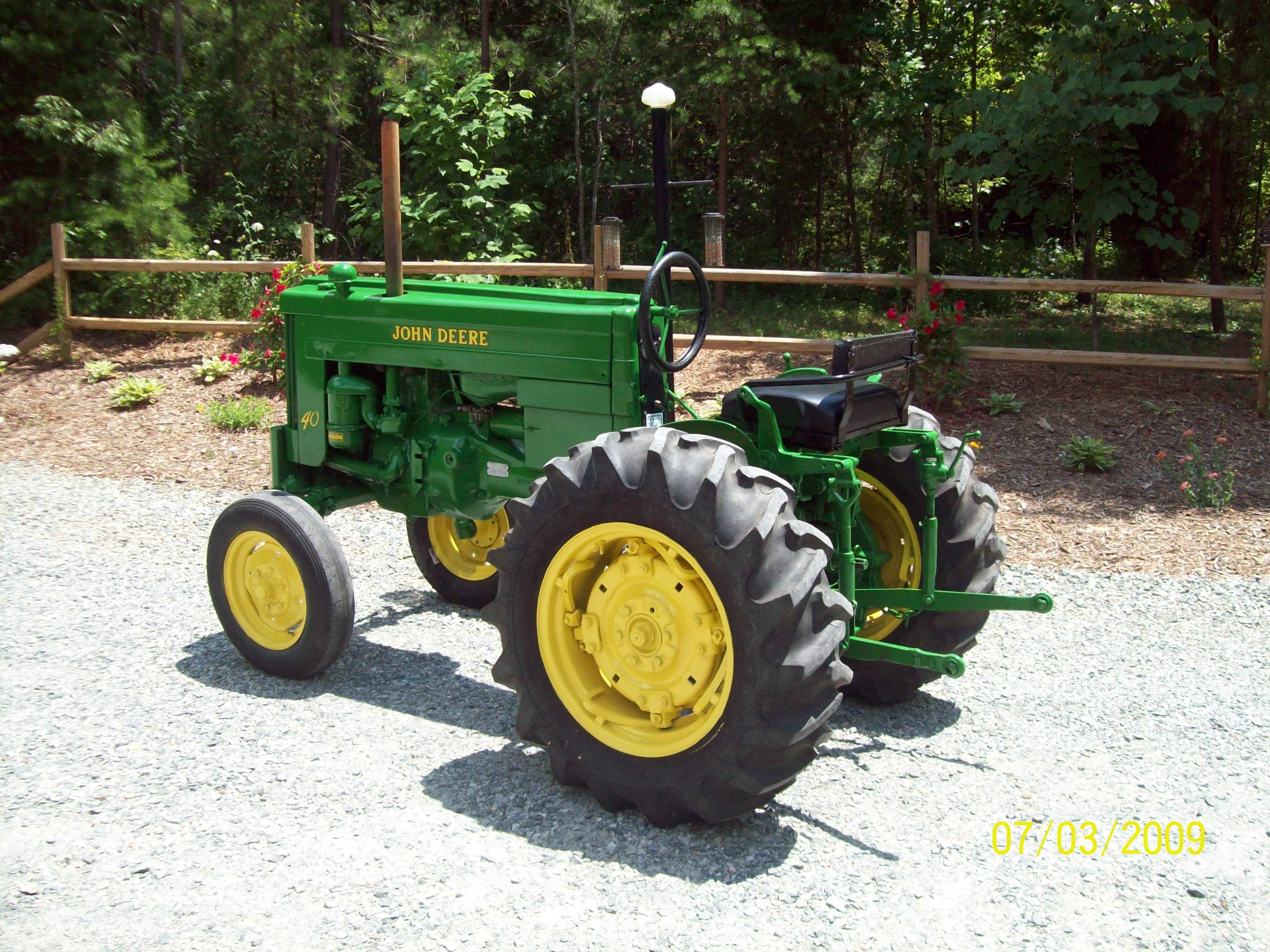

I forgot to take any before pics, but here are some finished pics.
When I got it the hood was bent down in the midle, 2 flat tires, grill screen missing, tool box and battery covers missing, lower grill cowl broken off top section, no seat and it didn't run.
The running problem was fixed by replacing the plugs and setting the point gap correctly. The setling bowl leaked gas out, but just needed a little attention. After getting it to start and run right I started on the sheet metal. I straightened the hoodd and nose piece, welded the lower c owl to the upper nose piece. I ordered a grill screen and the battery box and tool box and covers. while waiting for it to come in I finished the sheet metal repairs and cleaned, and cleaned, and cleaned, well you get the picture. I had to trace down a charging problem, finnally got that figured out so now the gen charges . Any way here it is sporting the straightened and repaired sheet metal and new covers with a shiny new paint job. Got the new decals in Wed. PM and they are now on it. I am well pleased with how it looks now. This is the best paint job I've ever got on anything so it realy is sharpe. I hope you like it, it sure was a lot of work. Later, Nat

I got the paint and hardner from TSC, The tool box/dattery box and cover came from yesterdays, tractor. The grill screen came from Tony Carbaugh. The decal set also came from yesterdays tractors. I enjoyed doing this tractor the most of all the rest I've done. Vickie says to keep this one cause it looks right at our place, that's a shocker to me. Later, nat

Eddie. I will make a little profit whenever I sell it, probably 3 $ per hour. The things you have to replace are what gets you. For instance the battery/toolbox cover for the leftside was 90$ and the one for the right side was 125$.
The grill screen was 94$. I probably have 6 hours just straightening the hood, and maybe 10 Hours working on the nose piece. Some people are faster on the sheetmetal work than I am and it doesn't bother me. Taking the wheels off to paint the tractor and then painting and putting them back on is a job by yourself especially since these were loaded.
