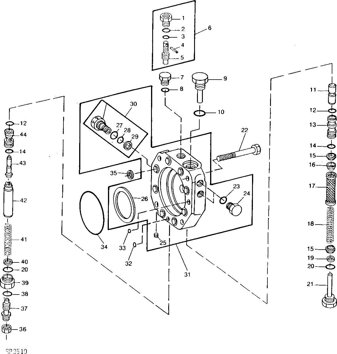

Have you checked,cleaned,tightened ALL battery cable connections? I can't determine from your profile photo if your tractor is cab or OS? Does your tractor have a hyd pump destroking screw(parts key 6)?

Its a cab. All battery connections seem to be good. On my meter im showing 12 volts at the starter.
