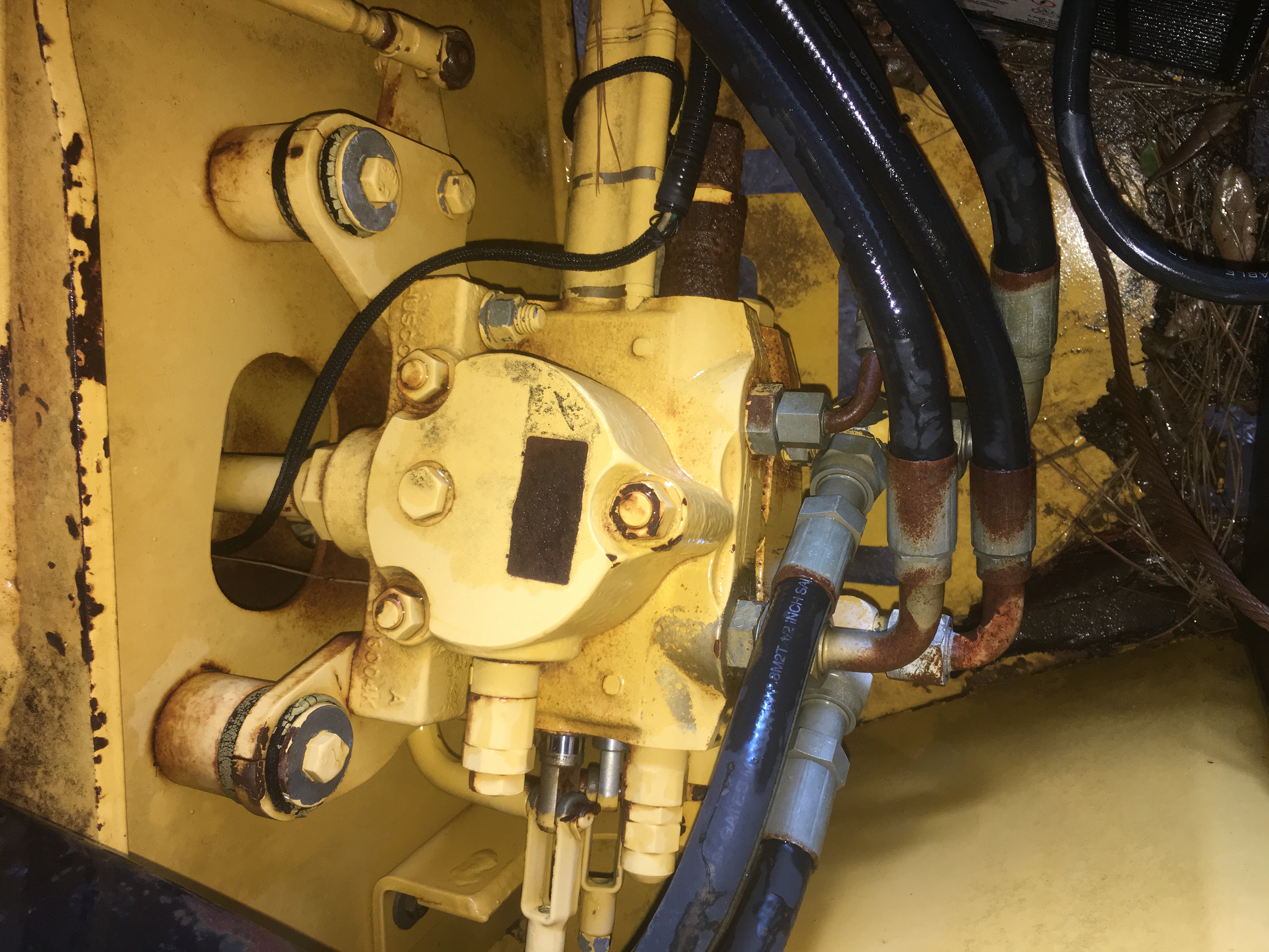

So here’s what I am working with. It has six hoses. I have been told the best way to go is with a third function valve with a lever mounted to my rop by my joystick. I am open to using anything that works though.

Probably the simplest would be a electric diverter valve off of your curl spool with a switch mounted on your joystick. Then with switch flipped your curl moment controls the grapple cylinders. Flip it back and it curls the bucket again.
If you want a full function valve, you have to figure out how to get power beyond from the loader valve. Do you have a hydraulic diagram of your system?

Unfortunately I do not have a diagram and the Internet seems to be a ghost town on this machines hydraulics. I would be just fine with switching back and forth from curl function to grapples. Any recommendations on which valve to get?
/ John Deere 310E Third function addition #8
There are several places that sell diverter kits that come with wire, switch, hoses and the valve. You can buy everything separate and save some money but a kit should take the guesswork out of the process. I believe Everything Attachments has kits for most applications. Am I sure others have good kits as well.
There are a lot of threads on this forum about diverters. You can search here and get some good ideas.
