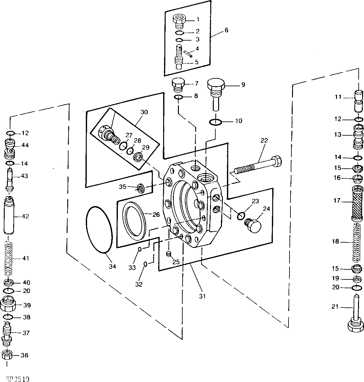

Nov 6, 2012 / john deere 3020 slow starting #2 Tx Jim New Member Joined Jan 26, 2007 Messages 10,404 Location Coyote Flats,Tx Tractor JD 4255/Kubota M7040 HDC Install a destroking screw in the main hyd pump.
Nov 6, 2012 / john deere 3020 slow starting Thread Starter #3 OP J jed4570 New member Joined Oct 30, 2012 Messages 7 Location MO Tractor 3020 John Deere Would you have a drawing of the location of the destroking screw location? I would appreciate it
Nov 7, 2012 / john deere 3020 slow starting #4 Tx Jim New Member Joined Jan 26, 2007 Messages 10,404 Location Coyote Flats,Tx Tractor JD 4255/Kubota M7040 HDC Parts key #6(AR33249) if hyd pump hasn't been replaced with one with a serial number. Attachments RP3510_________UN01JAN94.gif 28.8 KB · Views: 1,302
Nov 7, 2012 / john deere 3020 slow starting Thread Starter #5 OP J jed4570 New member Joined Oct 30, 2012 Messages 7 Location MO Tractor 3020 John Deere Thanks, I should be able to remove it without pulling the pan.
Nov 7, 2012 / john deere 3020 slow starting #6 Tx Jim New Member Joined Jan 26, 2007 Messages 10,404 Location Coyote Flats,Tx Tractor JD 4255/Kubota M7040 HDC Just remove the screen in front of the radiator on LH side and there is the plug.
Nov 8, 2012 / john deere 3020 slow starting Thread Starter #7 OP J jed4570 New member Joined Oct 30, 2012 Messages 7 Location MO Tractor 3020 John Deere Thanks, I will get with Dealer today and get one or get it on order.
