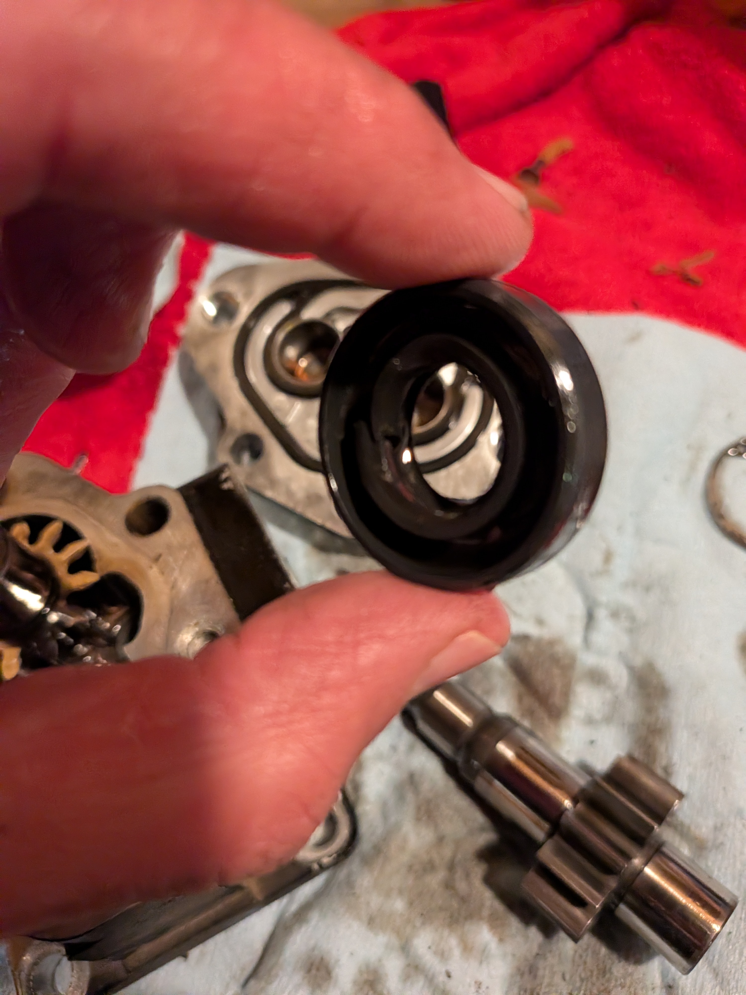

Well folks I finally found the problem! There is a seal inside the hydraulic pump (back side) which was blown.
It is the one which wraps around the two shaft ends (if that makes any sense) and prevents the hydraulic oil from diverting from the inlet/outlet portion of the pump.

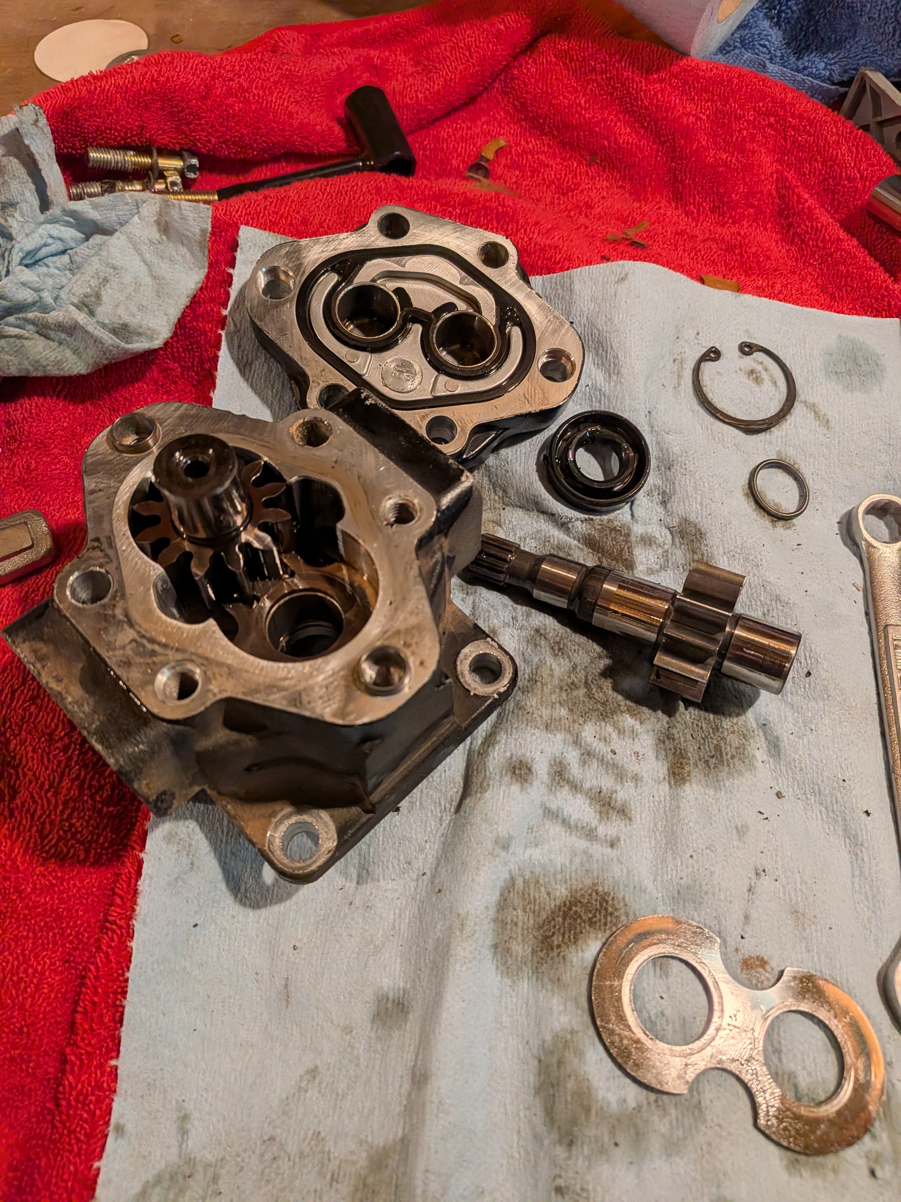

If the pump is turning, and there is oil at the suction side, then oil must come out of the pressure side unless the pump is broken.
Seals are available from bearing suppliers.

   / John Deere 2720 - Zero Hydraulics, Zero 3-Point Hitch, Zero Answers... #20
I pulled the pump, both the suction side and the high pressure side were empty. Including the whole pump. It looks like the input shaft seal is bad. I have no idea if this is part of my problem or not.
