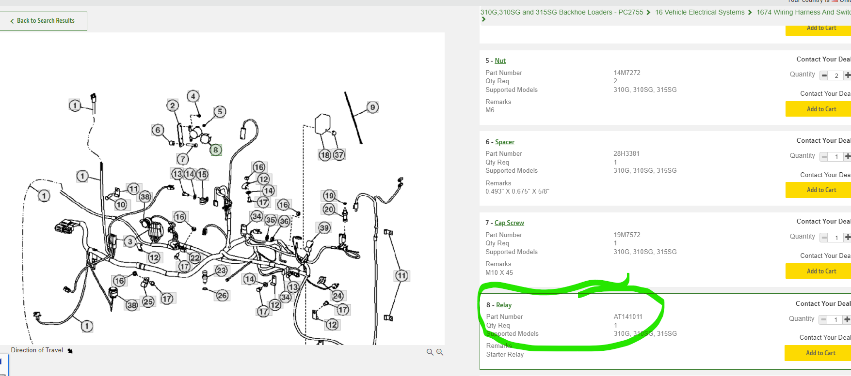

I beg to differ with you. A lot of tractors have starter relays even a JD310SG. JD began installing starter relays in 1969 on 3020 & 4020's
& I think you'll perform some research you'll determine tractors built today have starter relays
