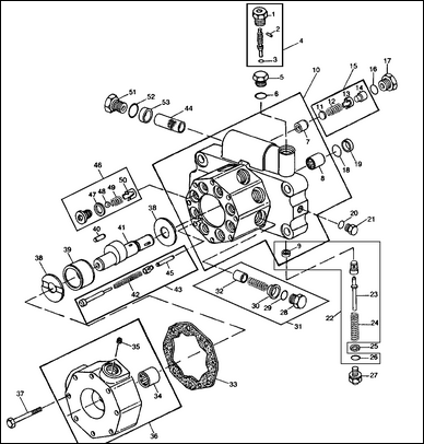

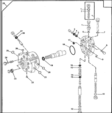

Seeing several different ones online. How can I verify which i have? Leaking terrible and need to replace.

1st photo is a 1.38 in.3 pump,2nd photo is the larger 2.4 in.3 pump

Thank you. I'll check this. Dropping my tilt cylinders off Tuesday for rebuild then going to work on the pump.
/ John Deere 2440 Hyd Pump #11
The 1.38? Anyway to verify this?
The small 1.38cu pump will look more octagon shaped, the larger 2.40 pump will look more round shaped. See drawings posted by TxJim
