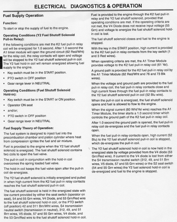

my tractor starts but then dies as soon as i release key cleaned connections good fuel new filter whats up
I might look at the wiring for the fuel shutoff solenoid.
/ john deere 2305
Thank you for your idea on the fuel shut off solenoid you don't know if that is what John Deere calls a fuel shut off timer and how to check it,I think that we are on the same page
/ john deere 2305 #5
did you check fuse F2 and the seat switch?
/ john deere 2305
Yea I've checked both
/ john deere 2305 #8
Sorry read it wrong the safety realy is after the fuse and seat switch and you're getting power to the pull-in timer because the tractor is starting.
/ john deere 2305 #9
it almost sounds like the key switch isn't continuing to send signal to the fuel solenoid
to keep it running after release from the crank position,
maybe that can be tested....

Yea ordered new switch so ill cross fingers and hope
