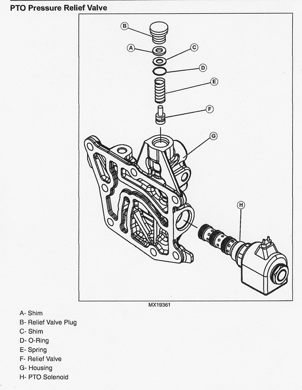

The PTO is electric-over-hydraulic, so there is a solenoid on the transmission that gets energized for PTO operation. You will need to find this solenoid and make sure it's getting power.

/ John Deere 2210 PTO doesn't work #7
These are for a 2305 which may be similar to yours.
