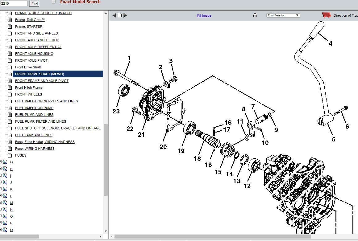

May 28, 2018 / John deere 2210 4wd issue #1 H Hoodless New member Joined May 28, 2018 Messages 4 Tractor jd 2210 Hello folks, first post, got an issue with the 4wd on my 2210, i have checked all the basics, not getting any power to drive shaft going to the front axle. Anybody have any experience with this problem? Thanks

May 28, 2018 / John deere 2210 4wd issue Thread Starter #3 OP H Hoodless New member Joined May 28, 2018 Messages 4 Tractor jd 2210 Yes, not a drive shaft issue, its not engaging with the fwd lever
May 28, 2018 / John deere 2210 4wd issue #4 B beenthere Super Star Member Joined Aug 16, 2001 Messages 18,684 Location Southern Wisconsin, USA Tractor JD_4x2_Gator, JD_4300, JD_425, JD_455 AWS, added JD_455, JD_110, JD_X485(sold) Got it.. Can you tell if the lever is shifting the collar.. believe it to be key item # 15 Attachments 2210_MFWD_shift.jpg 225 KB · Views: 417
May 28, 2018 / John deere 2210 4wd issue Thread Starter #5 OP H Hoodless New member Joined May 28, 2018 Messages 4 Tractor jd 2210 It feels like it is, but nothing is tore apart yet
