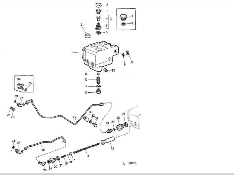

Hello Everyone,
I have a JD 2120 with a billion hours on it. I usually have the brake lock on to engage both pedals at the same time but the other day I flipped over the latch as I needed to do some tight turns and I noticed that the right pedal I had to pump twice before it would brake. The first pump goes to the floor and then the 2nd pump engages the brake at a more normal level.
The left side I don't need to pump it.
Is it a seal in the braking cylinder that is gone? Tires are loaded, removing the axle would be a huge job at this point.
Thoughts?

Sounds like there is some air in the brake circuit. I would try to bleed it out. The bleed screw is on top of the axle housing. If bleeding helps, I would just leave it be and see if the pedal says good. If it gets air in again in a short time, then most likely the seals in axle housing on brake piston are going bad. If bleeding does not help, The problem is most likely in the brake valve. May just need to adjust stop screws on the pedals.

Engine needs to be running when bleeding brakes so trans pump can replenish oil level in brake reservoir. IIRC there's an equalizer valve in in brake valve housing that can malfunction causes single pedal to require pumping but when pedals are locked together no pedal pumping is required.

Left-right Equalize valve in brake master cylinder is leaking.
Which parts are you referring to?
/ John Deere 2120 Brake Concern #6
The equalizing valves are balls and springs 11 & 12.

Does it make sense to change the ball and spring? Or is it the seal #14 that needs changing?

I never replace 11& 12 . Bleed that side . Check condition of hydraulic filter fot brakeliningmaterial and oil for metalfilings that will tel you brakes needs attention

When depressing the brakepedal slowly and the brakes fail it is durt in valve 3...replace both

O-ring(key 14) only seals plug(key 13). If plug isn't leaking o-ring is fine.

Order 2xno 2 and 2x no3...remove no 2 and strip valve....clean all . When assemble make sure no 3 do not touch piston and do not use silicon on gasket...there is a small hole in the gearbox casing allowing oil to fill mastersilinder...after assembling remember to adj the pedals with the 3/8 bolts on top...all pedalfreetravel gone plus 1/3 turn tighter...do not try to adj pedals equal ! Lock 3/8 bolts with there nuts !
