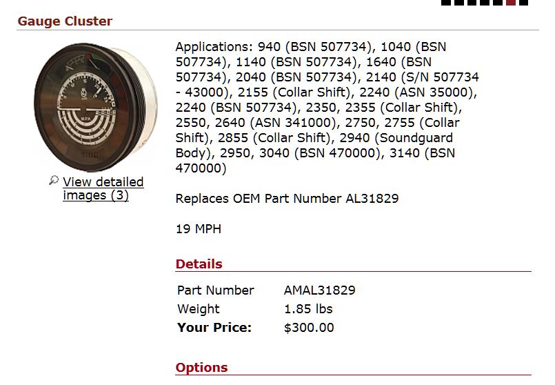

Hello again everyone, still working on my late model 2040 1980. I need to
find a gauge cluster and John deere wants over $1200 for it. Was hoping some of you resourceful members might advise me on a more affordable option.
/ John Deere 2040 hydro problems #8
