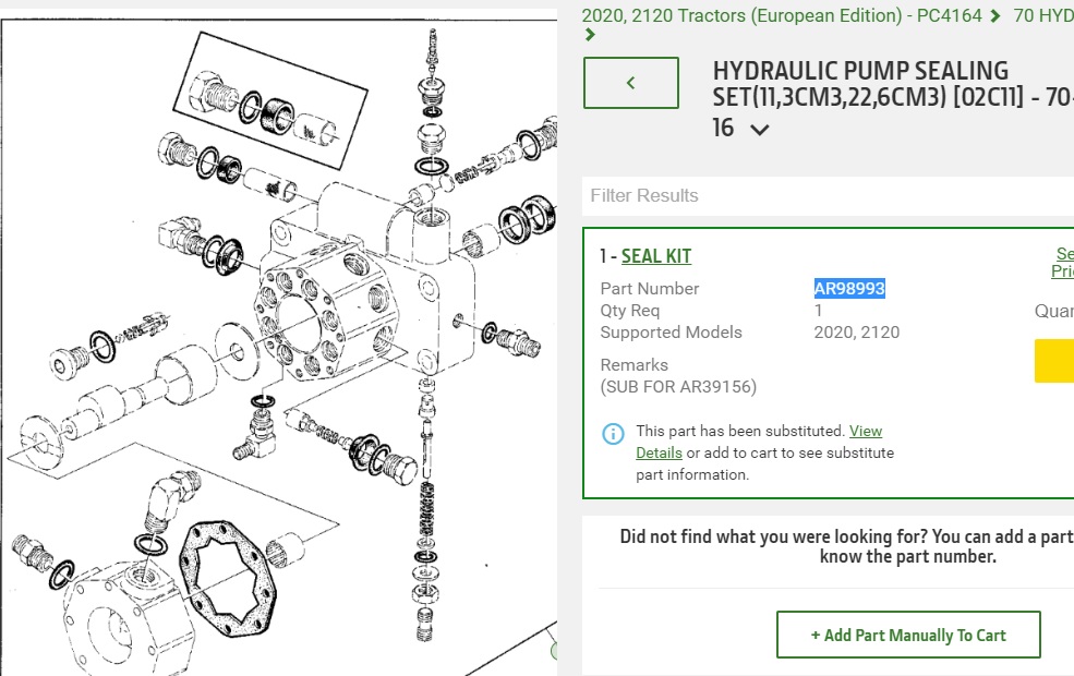

Looking for a good source for parts kit to rebuild my 2020 piston pump. Mainly looking for seals and bearing, the cam and intake and discharge valves look fine. Deere is offering ne an Aand I pump for 1600 .

It's an 11 cm3 pump. I'm an independent ag mechanic, Ive rebuilt a ton of 49 and 65cm3 pumps on 40 and 50 series, this ones about the same, just a little smaller. This tractor is actually mine and not a customers. This tractorgot water in the oil and caused the pump to cavitate and shoved the front seal out. I got her all cleaned out, I just want to reseal and put back together.

Deere parts shows a seal kit for the 2020.. AR98993
Does it look like the right one?

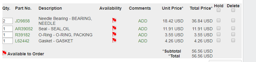

Parts should be available from your local JD dealer.

Needle bearing? Parts shows JD9858 for that.. and see that is on your listing too.
Deere changed the parts advisor program, I didn't see that. That's what I need . Thank you
