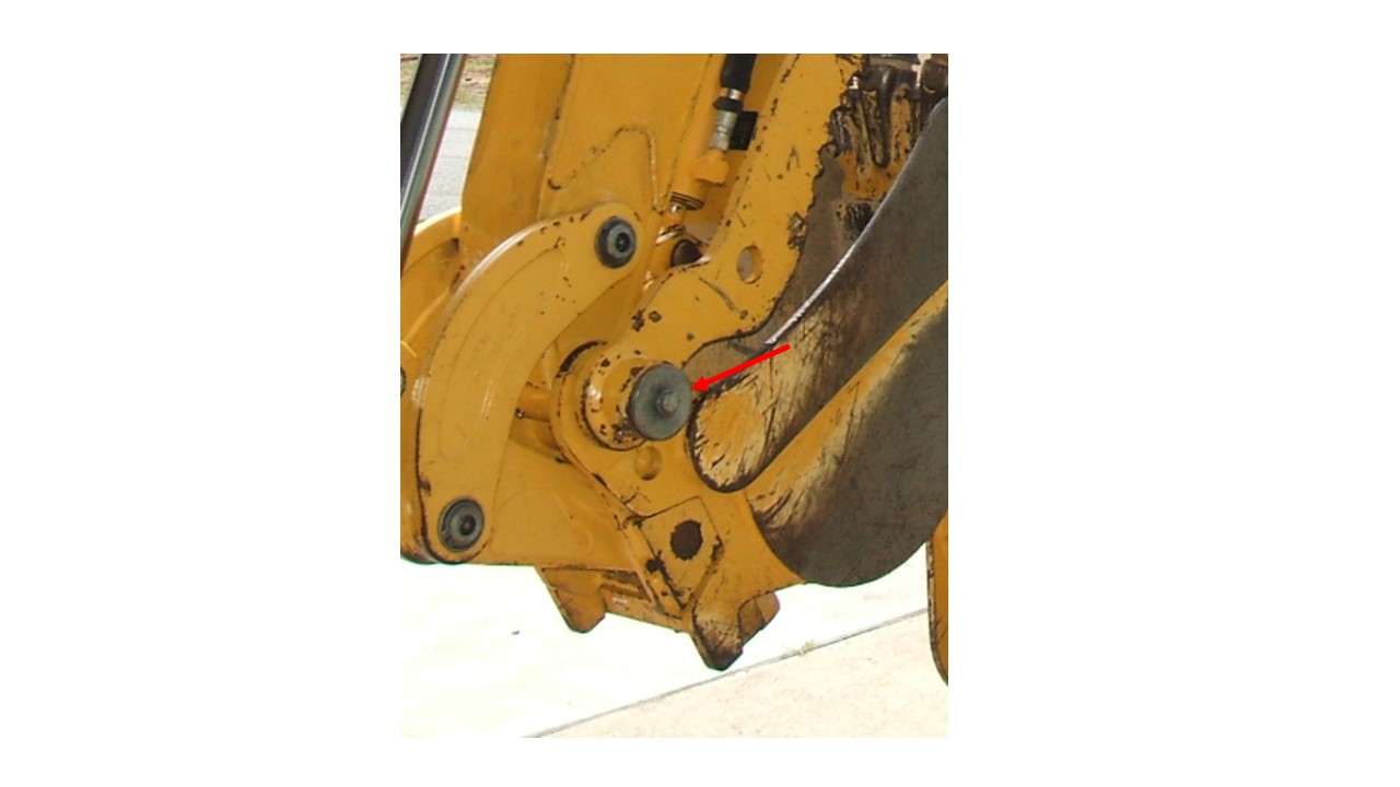

Almost looks like it's been welded in place (picture on the left). Is the thumb a Deere accessory or added later?
That's just the flange of the pin. It can't go out from that side. Only from the other side (right picture).

That pin will come out, but needs some meaningful hydraulic force to push on it from the side with the bolt hole.

We are now pretty sure that our pin should have a 1/2 inch bolt and large flat washer on the side with the internal threaded hole (see picture)... I'm guessing that it's been missing for some time, and the only thing holding the pin in is that it's stuck.
We're going to replace those before trying to get the pin out...

So...you think replacing the bolt and washer will help you get the pin out?
Ain't gonna happen!
The washer and bolt, when they are there, obviously act as a pin retainer!

I would try using a high pressure electric grease gun. The DeWalt puts out 10,000psi. That thing is incredible for stuck pins.

^^^^^^ GOOD ADVICE!

Try a little heat when pumping the grease in .......
