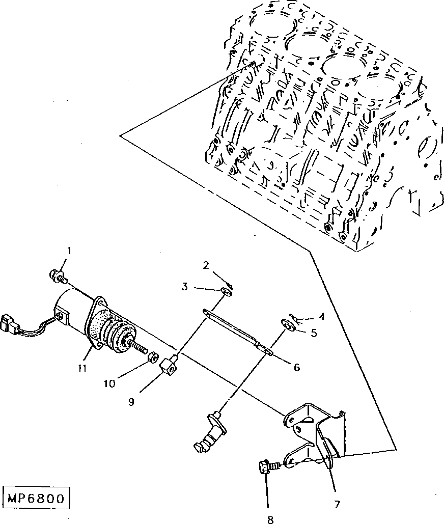

My guess is you have a problem with the fuel shut off solenoid. It is located on the right side of the engine and has a link connecting it to the injection pump. As a test, you can pull back on the link by hand while you crank the engine and it should start. If that works, then you either have a bad solenoid, control module, or a loose or broken wire somewhere in that circuit. I have attached a picture of the solenoid. Just pull back on item #9 while you crank it. I am betting it will start.

thanks for the suggestion but unfortunately it still wont start the solanoid pulls in fine every idea seem to point in the right direction but i still connot get the thing to crank over is it possible that the injectors got clogged and is there any way to know if the fuel is getting past the in jectors
