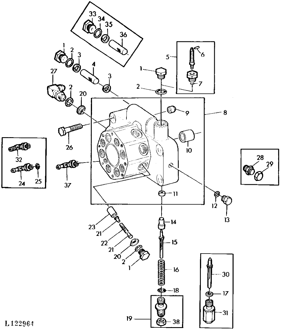

1st thing to do is re-locate the battery ground cable connection from the battery box to the engine block/starter mounting bolt. Are you aware that while attempting to start that rapidly moving steering wheel from side to side will help relieve hyd pressure so starter can turn engine easier? One can also install and use a hyd pump destroking screw(parts key #5).

Tx Jim, I assume the drawing you posted is part of the Hydraulic pump, I haven't had a chance to look as yet but where is it located? To test if it a Hydraulic issue could I not just loosen off bolt #1. Is the destoking screw an "auto" release valve if not how does it work?

Loosening #1 will make a mess. I would suggest installing destroking screw especially since your tractor has "manual steering". Let me clarify that you need to determine which hyd pump you tractor has for obtaining correct DS screw. The correct way to use a DS screw is open LH screen in ft of radiator,turn DS screw down a few turns,crank engine then turn DS screw back out. Screw cost about $15 USD.
