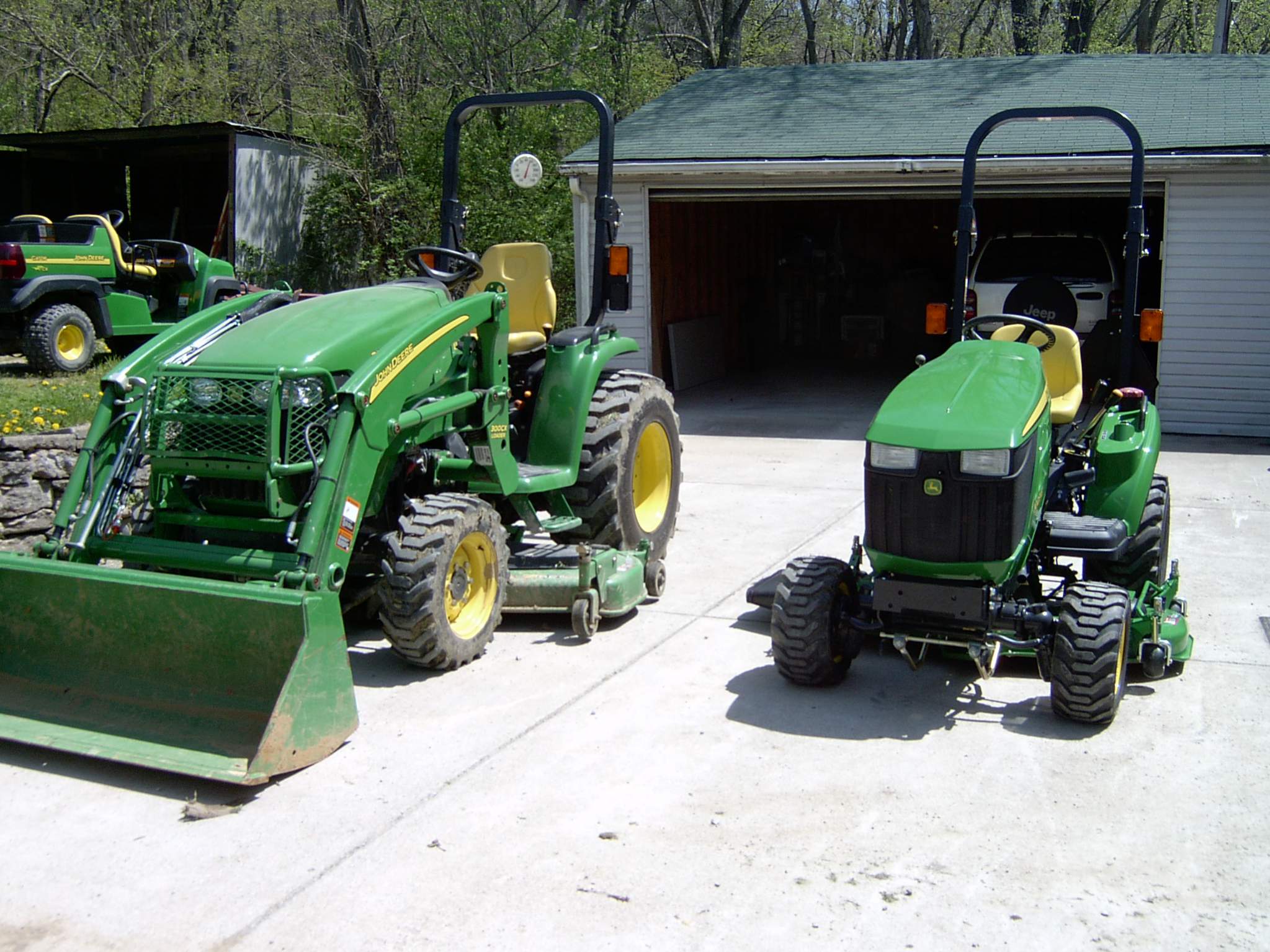

We added a 1023e to do lawn work and the cut is excellent. Its a mowing beast. Sorry to hear of your problems. Hopefully your dealer will get it straightened out. As for the curling while lifting on your loader, I have no problems with the 300cx on my 3320. I do it all the time. Have your dealer check that also. 1023e 001.jpg
