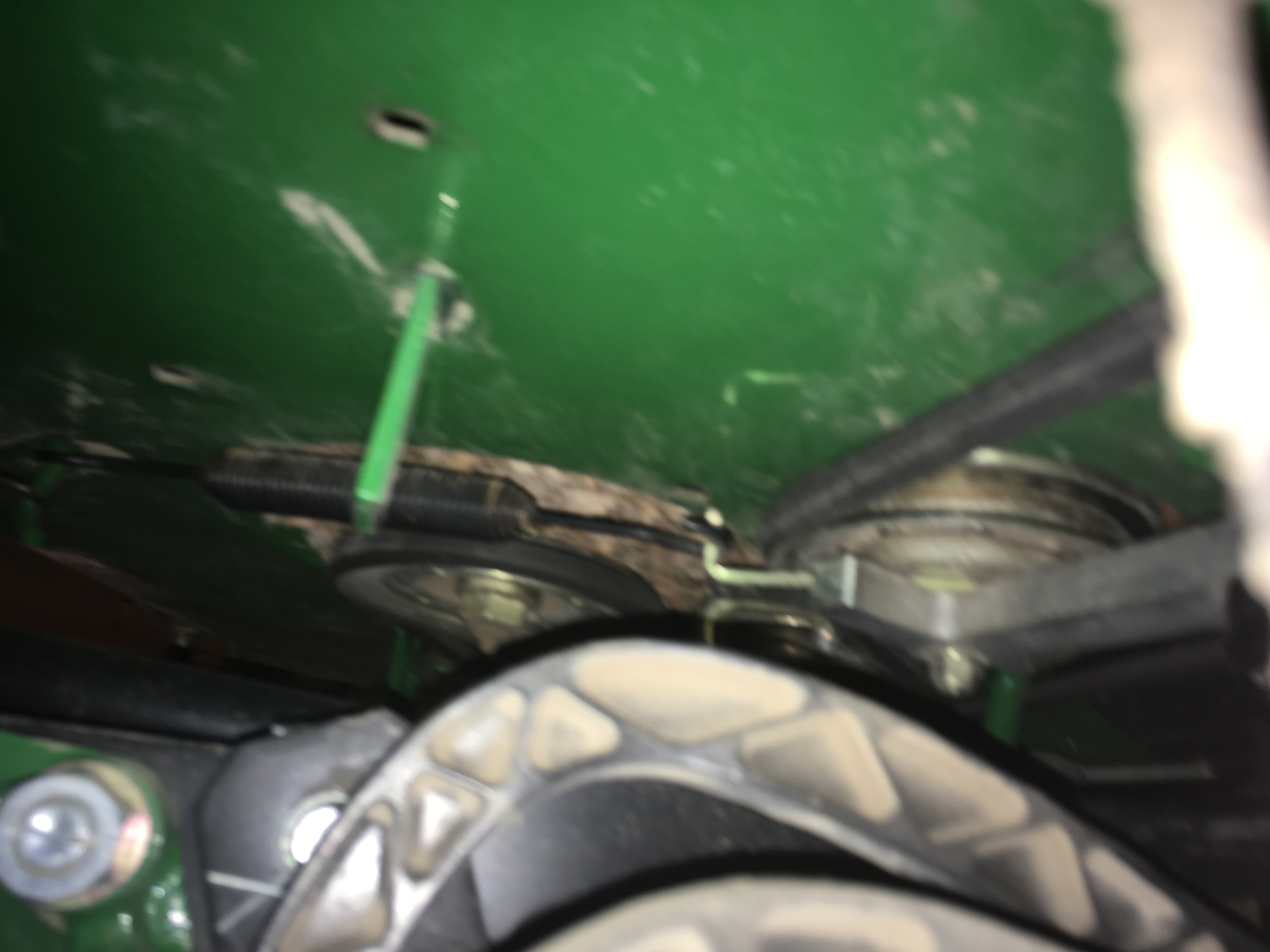

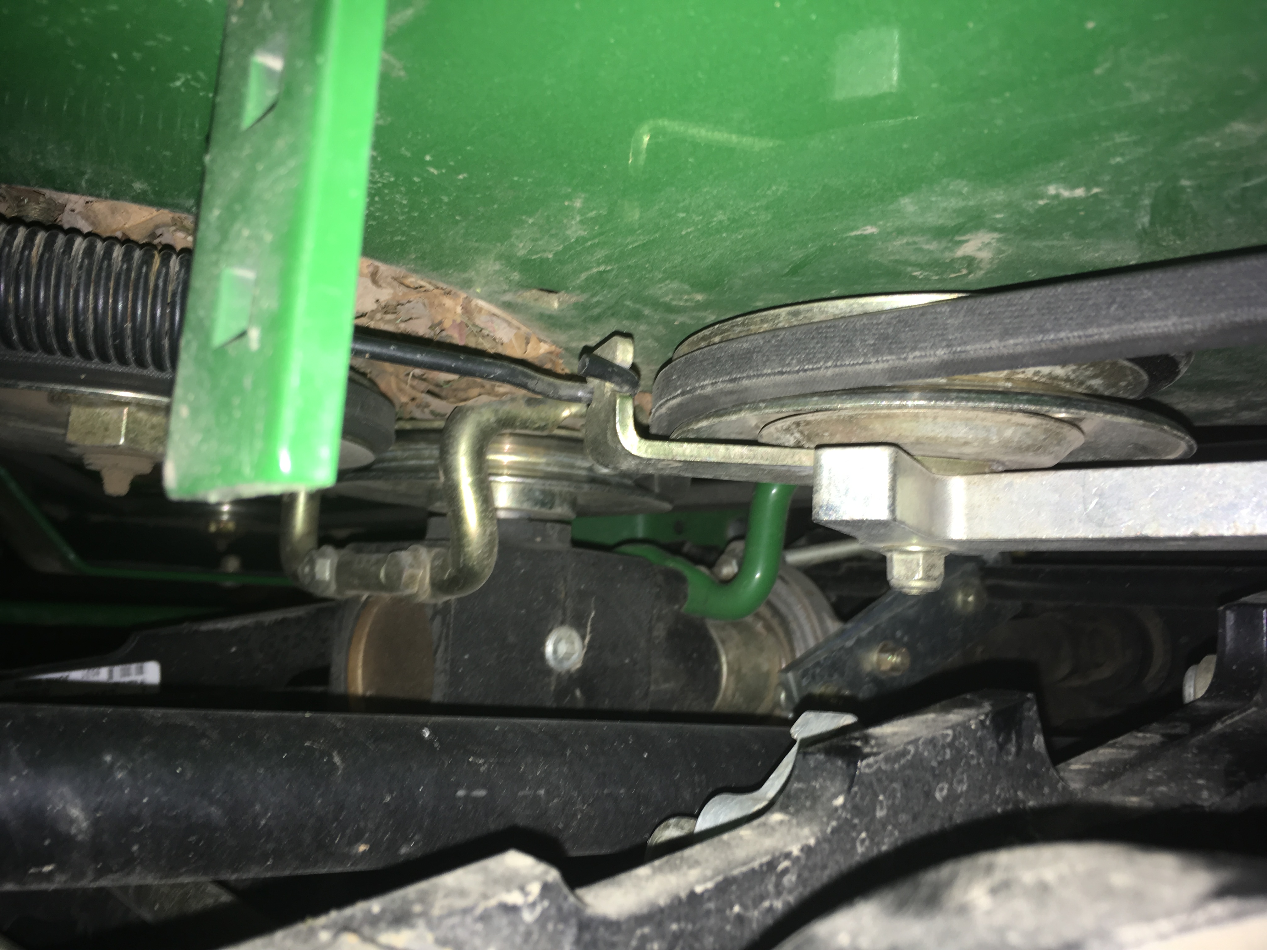

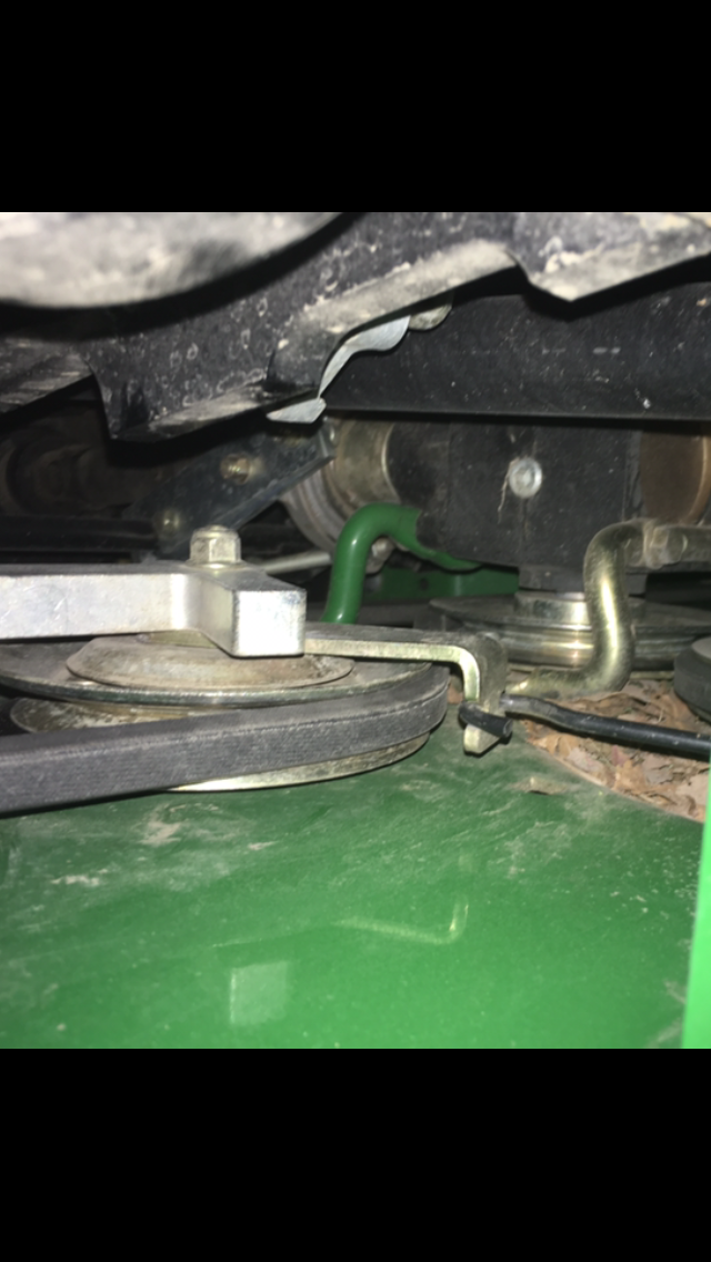

I don't know why my belt is flopping around so much it is wearing the paint off my deck. I noticed the spring that connects the idle pulley does not have any tension at all on it. Do I need a new idle pulley or what?

What the spring is attached to on the back
Where the idle pulley is if I move it towards the right it will put tension on it. T

That spring doesn’t look right. It’s suppose to be spread out more than that between coils. Doesn’t look tight at all

I know that痴 the problem. Don稚 know if there is a pin that suppose to be holding the back part down thats broke or just need to replace the idle puller system?

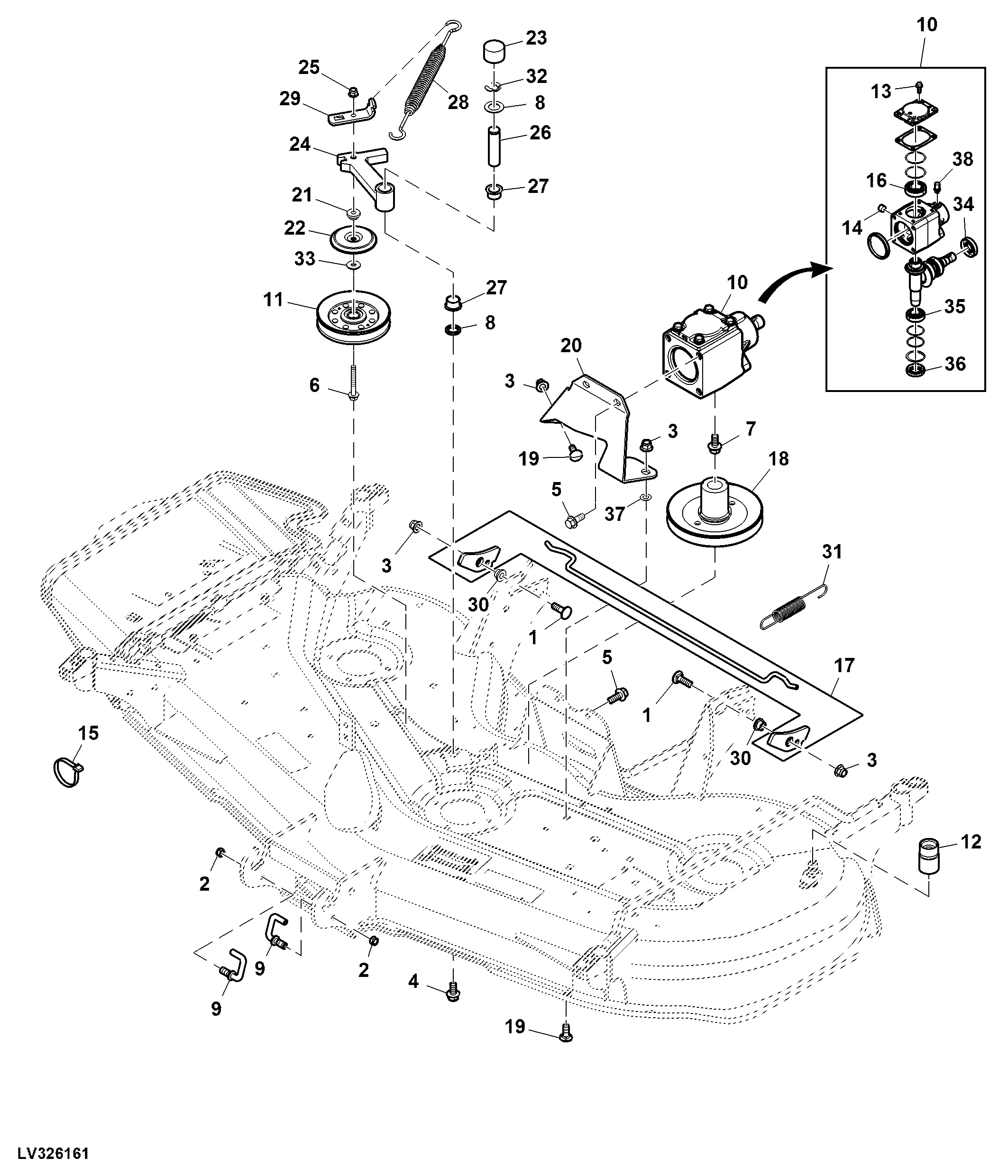

It looks like the part 29 the spring hooks to near the idler is on wrong. It should NOT be between part 24 and idler, BUT on TOP of part 24. spring hook UP NOT down as in your pictures (which are upside down) in you post of three pictures
It also looks like part 29 has a "bump" stamped at the end (opposite the spring hooks to) that mates to the notch on part 24 to prevent it from pivoting on the spindle bolt.
