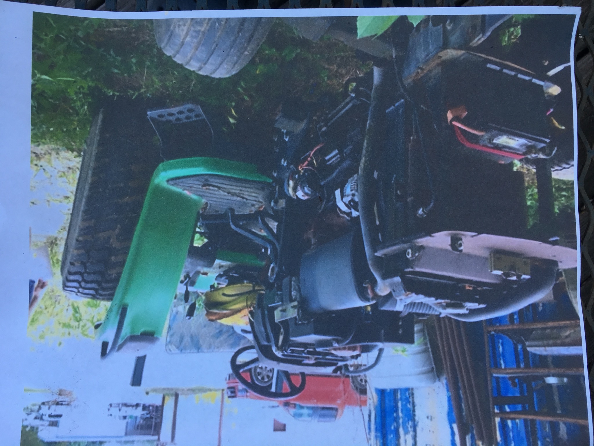

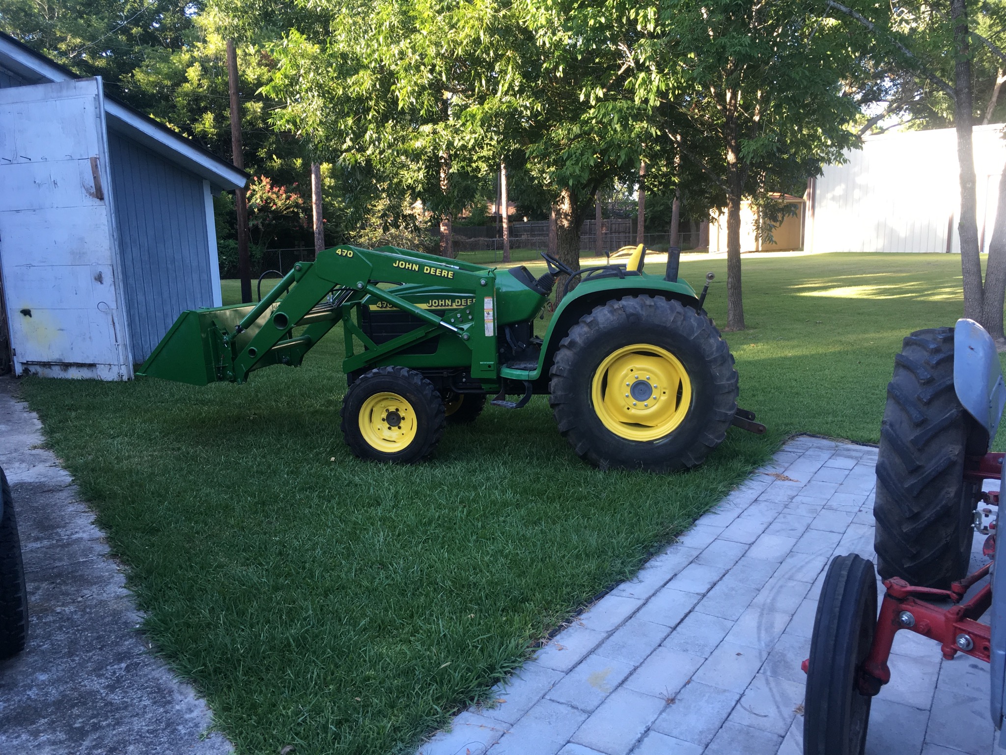

This is my first HST tractor bought it looking like crap fixed it up, but now looks nice again, Yes it is a automatic transmission and mostly the problem is from A to neutral or back, don't use the higher gears too much, will try the lubrication first, thanks .

Your service tech manual may describe how to adjust that shifter. Glad to see you got that tractor right side up.. :D
Looks great.
