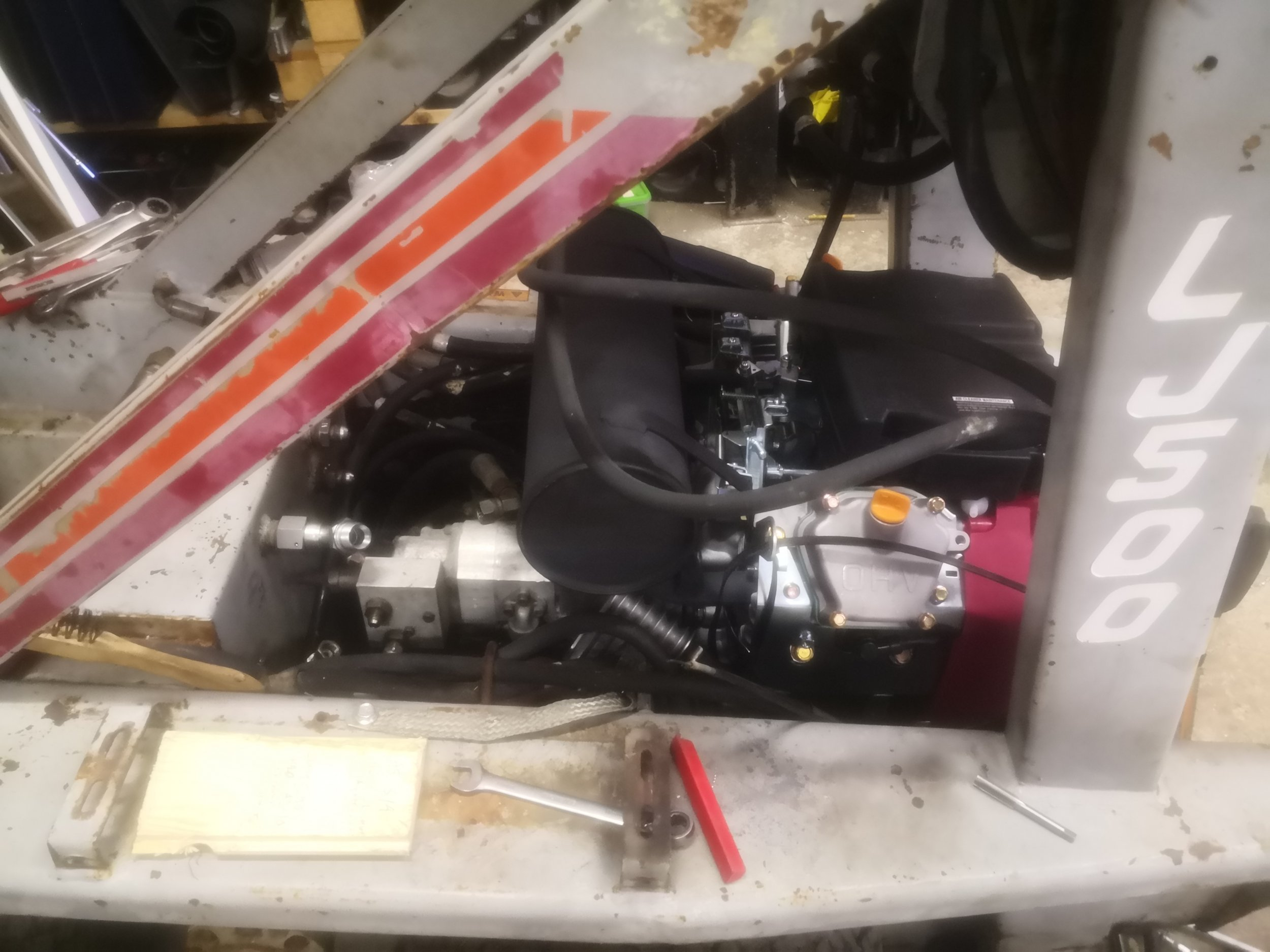

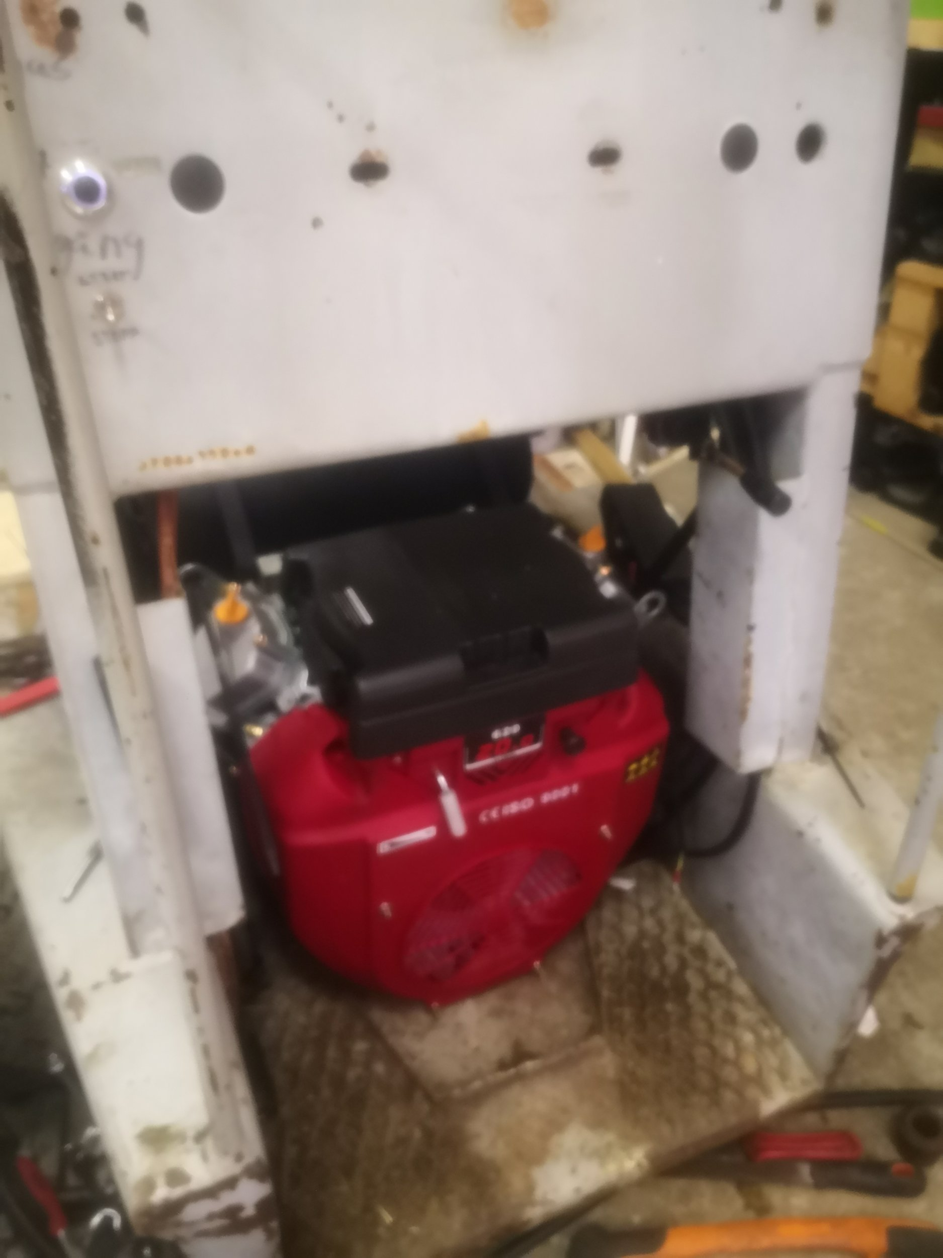

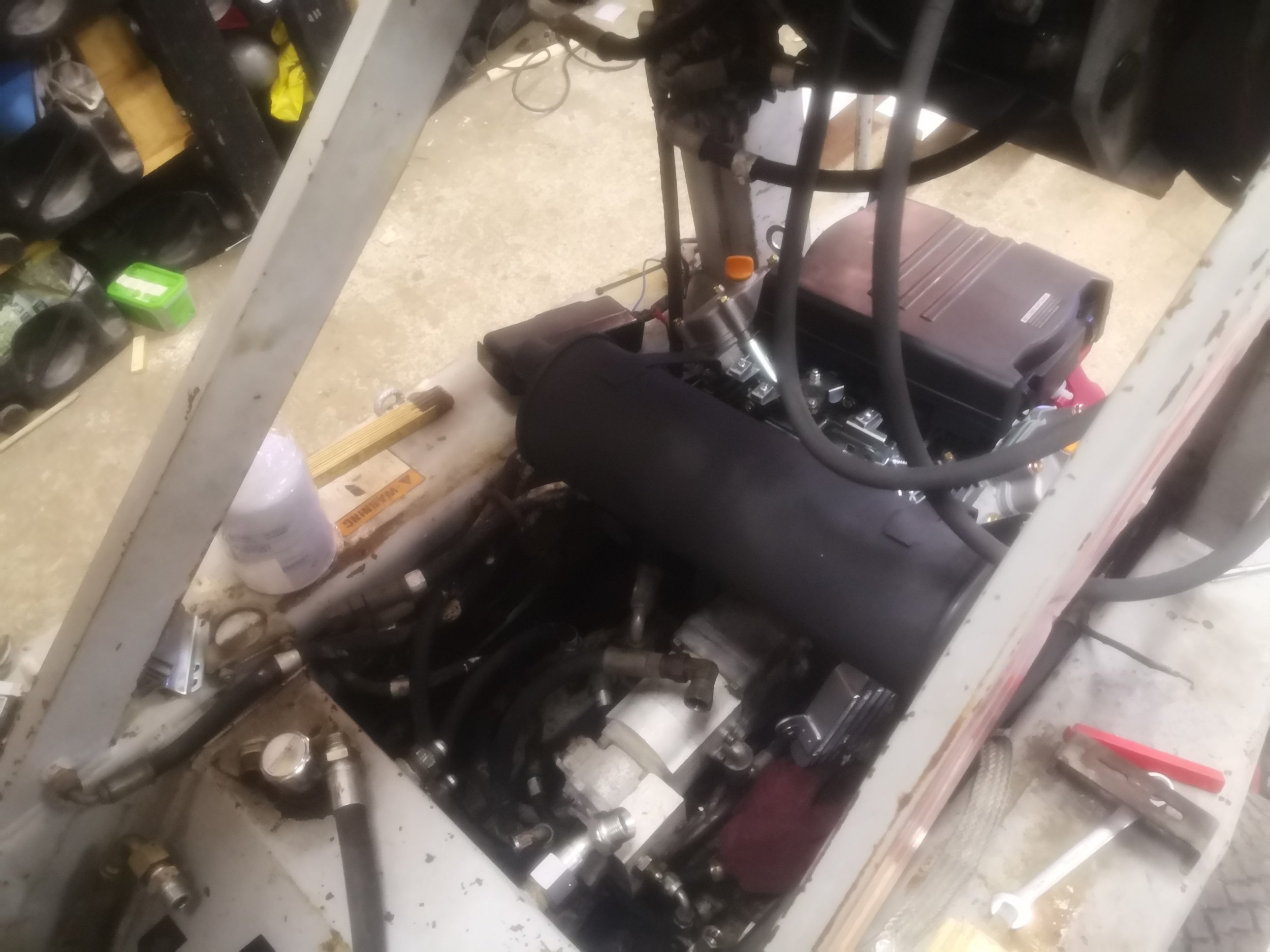

Okej i think i will change to des32 or des 46.
Checked all those things but couldnt find the fault. And also because of the extreme noise of the wisconsin i decided to change to an v-twin. And that partly because of the blackfriday sale 🤣.
Sorry the bad images my camera is not wat it has been 😦

That's excellent! Aside from compression and timing, you need three things to run. Air, spark, and fuel.
If something is heating up and causing the engine to break up, I'd look toward the coil maybe? With a brand new engine that's odd.
I'd LOVE to put a 20hp Honda on mine, the extra counterbalance would be nice, too! Well done! I sent the manual to your email, hopefully you got it.
