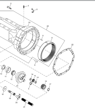

Need help... john deere rear axle seals and bearing fell apart. I removed wheel and axle housing from tractor. How do i get the axle and final drive out of housing? I have tools. what do Ido next? Need help...

After viewing parts schematic it appears one will need a special tool to remove "special screw"(key 19) from end of axle so planet pinion carrier can be removed from end of axle.

Key 19 is a lockplate for a standard bolt. To temove that lockplate you need to tightern that bolt slightly till that plate is loose .....then remove that plate and unscrew that bolt.
To reinstall tightern bolt to the correct rolling dragtorque ....then install lockplate and undo that bolt till it grips firmly on that lockplate
