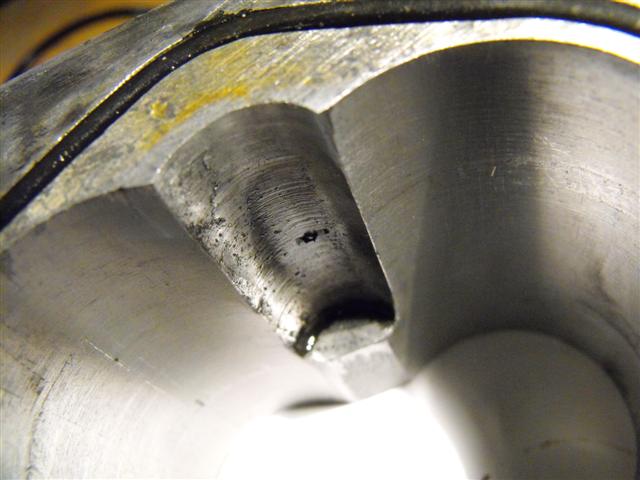

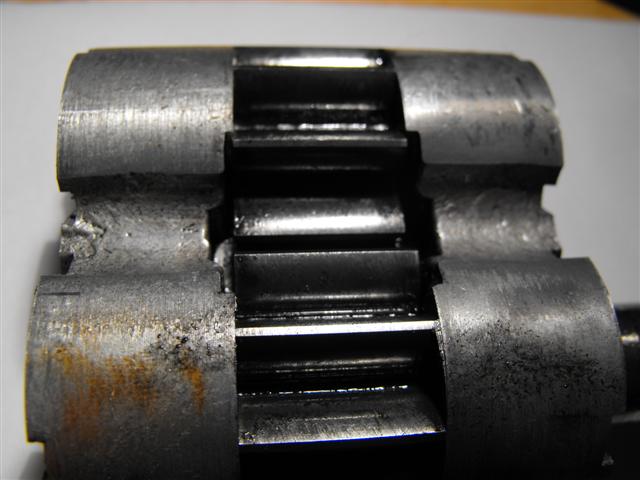

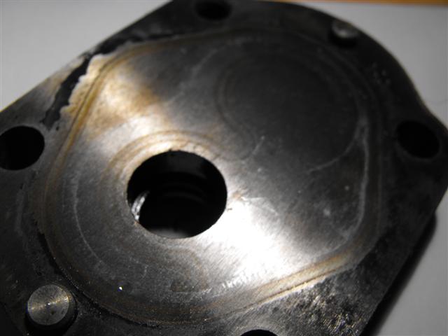

Ok So, Jinma 254LE main tractor pump/gear type. So I started her up on boxing day and let the tractor warm up. However I put her on high idle fairly soon (cold oil). When I came to move the tractor 1/2 hour later there were no hydraulics nothing. The pump was hot to the touch, starved for oil? So I took it apart it all looks ok?
thoughts

any opinions on the current condition of the pump. Good/Bad? Picture 13 is the intake side of the pump.
/ jinma254 #4
These pumps rely on very close tolerances to function properly (develop full pressure). It looks like you have some wear from the gears/impellers against the casing. I would replace it. Of course if you want to try it, you will only be out the cost of a seal kit and your time.
/ jinma254 #5
It looks like some wear to me too in the housing,rub your finger in the housing see if you can feel a ridge or wear.If so you need to replace the pump.Now the main question,what caused it.I would hate to see you put a new pump and be right back where you started.Has the hydraulic system been flushed,? what weight hydraulic oil are you using ?,is your filter clean ?
