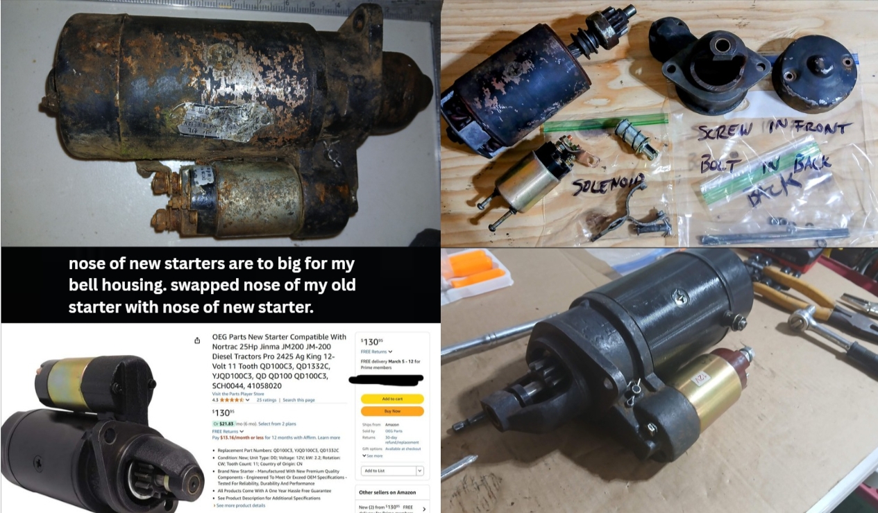

I thought I needed a QD1332C.

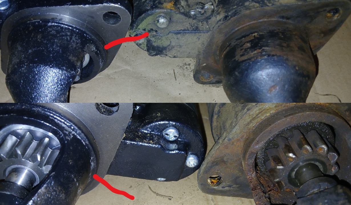

The nose of the starter does not fit into the bell housing of tractor. It has a lip (pic below), where the original does not.
Can anyone tell me the correct part number? Thanks

bought another starter that was the wrong size and swapped all the parts.
tested it with jumper cables and a battery and it worked.
now to put it back on the tractor..
/ Jinma Taskmaster 425A starter question
five months later and several returned starters finally got one put together.
started but didn't stay running.
today fresh diesel and I bet I'll be in business.
